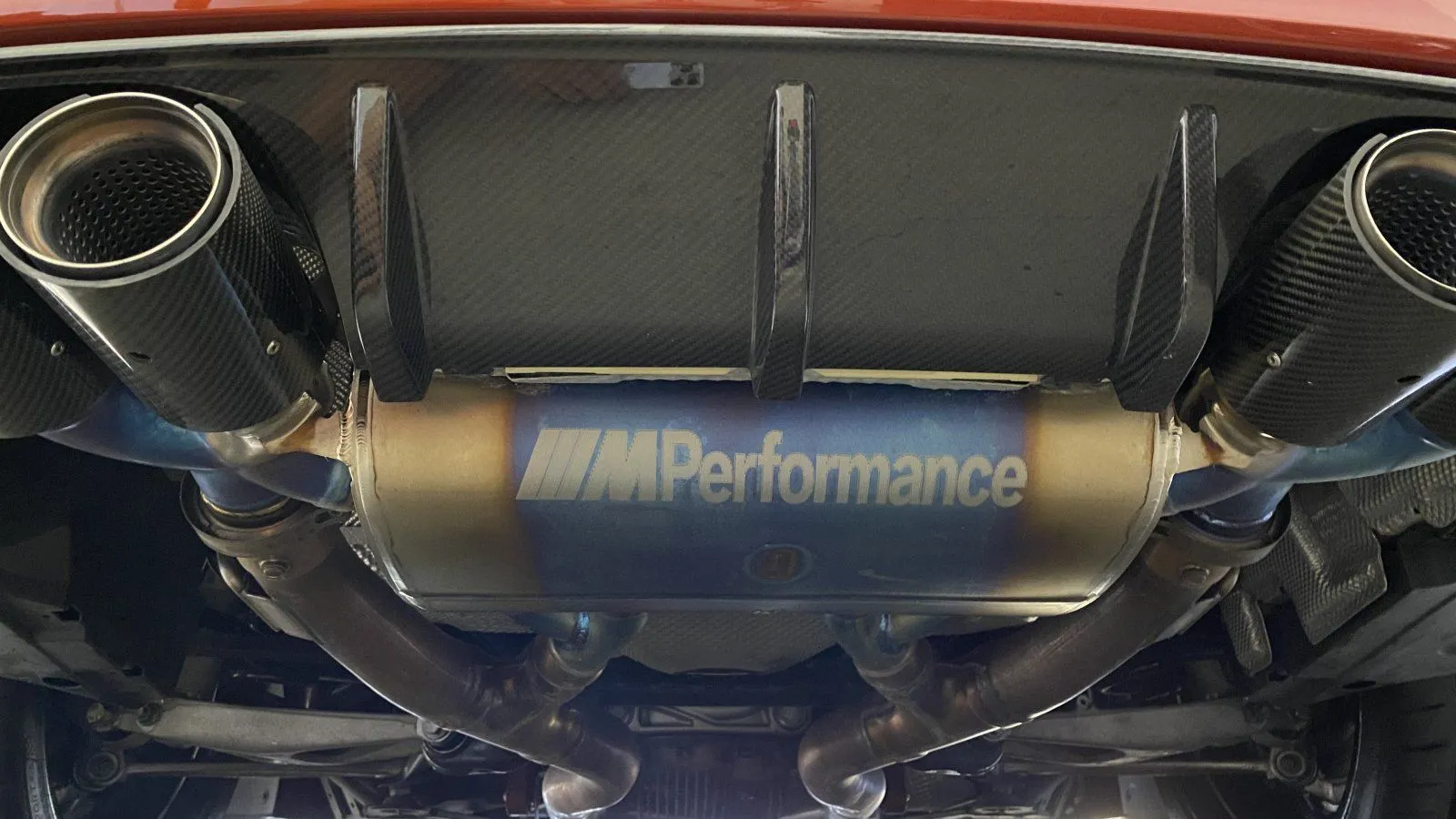

I reckon it technically does, but the likely hood of any one noticing and reporting it when just doing regular maintenance is slim to none. I had one on my BMW and just set the valve to work like factory when giving it in for service, and no one ever noticed. They want to get your car in and out ASAP.

BMW aren’t to concerned about customer leaving the valve open/closed all the time, they even sell the blanking plug so you can. But Lotus is a bit of a wild card in that respect.
