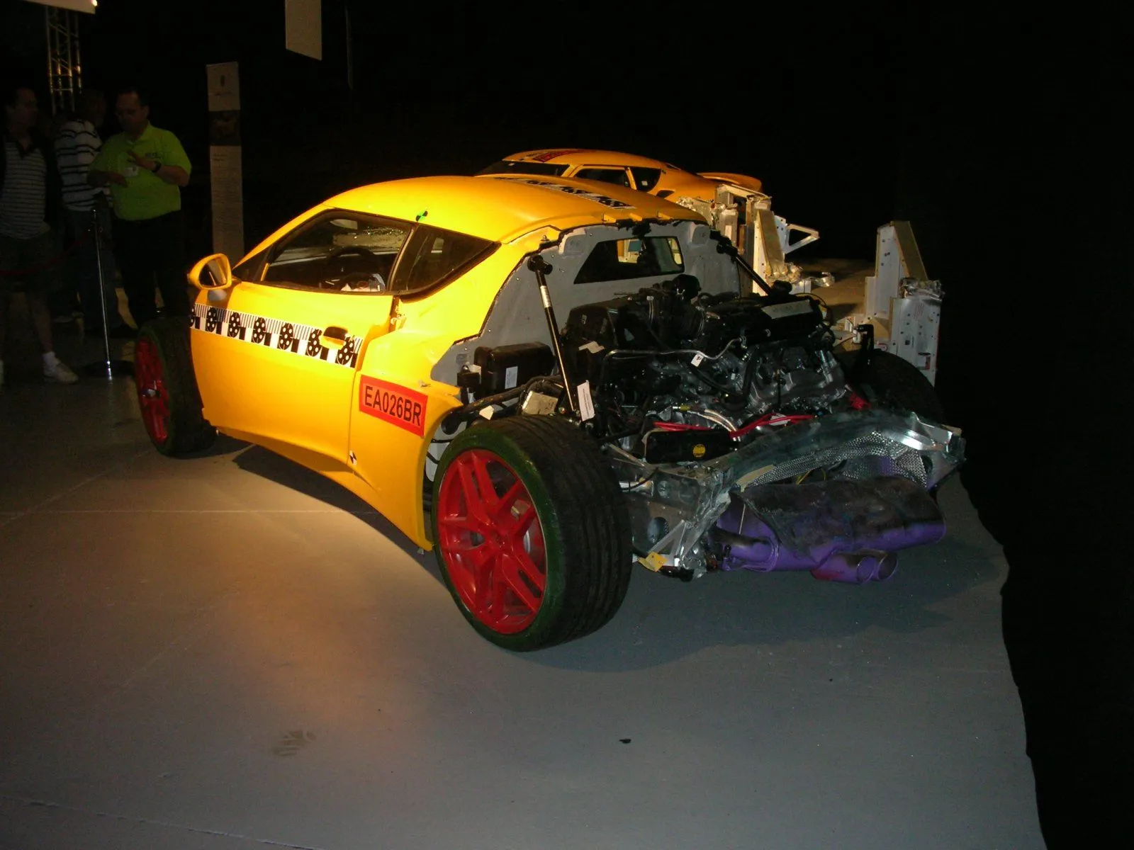

Evora crash test pictures:
Rear impact. At the time this was a US-specific requirement to simulate a car being hit while stopped on the road shoulder and hit from behind by a car doing 50mph. The requirement was to maintain passenger cell integrity and have no fuel leak.

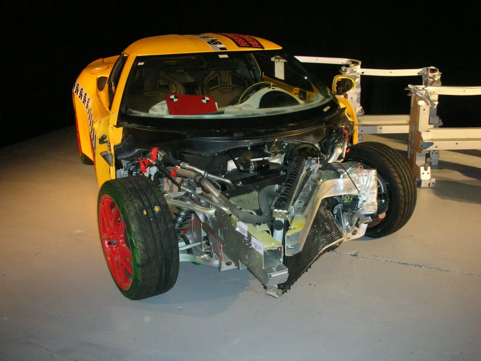

Head on frontal impact - note the complete deformation of the front chassis frame (compared to the next picture). The passenger cell is still complete and the doors both open. The windscreen damage is because the car was first used for the pedestrian impact test, which caused minimal damage to the car so it could be used for the second test (and it passed on the pedestrian impact).
