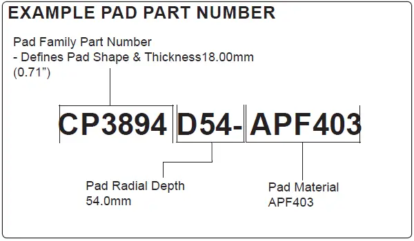

AP Racing uses a standardized system for their brake part numbers, so we can do some sleuthing.

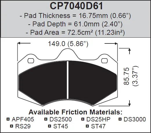

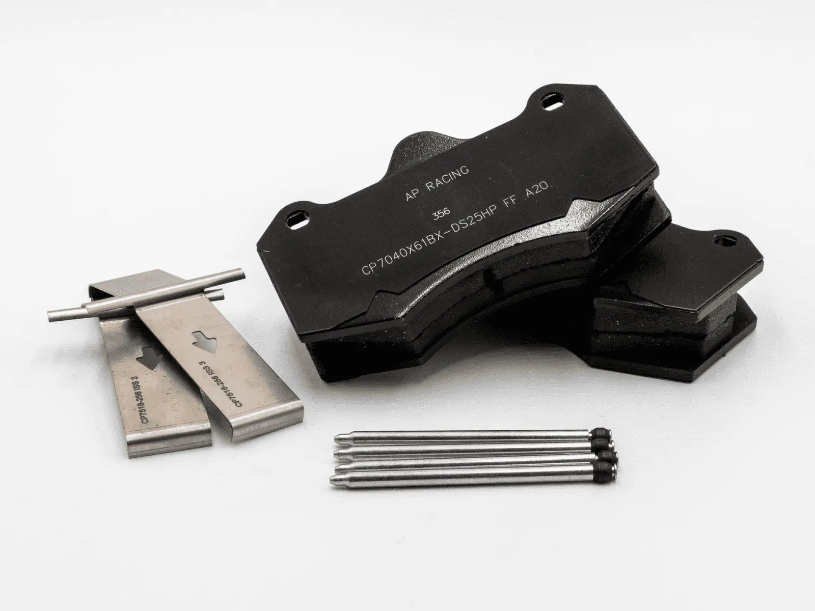

2021 Evora GT/GT410/etc front brake pads are Lotus part number A132J0326S. The part number printed directly on the pad is AP Racing 356 CP7040X61BX-DS25HP. Image:
That's an AP Racing CP7040D61-type pad profile. The section at the end is the friction compound. In this case DS25HP indicates that it's the Ferodo DS2500HP, which is sometimes called DS2500+, a variant of the DS2500 compound for street applications in heavier vehicles (i.e. not superlight).
AP Racing offers this aftermarket in their own APF405 compound, Ferodo DS2500, Ferodo DS2500HP, Ferodo DS3000, Pagid RS29, Raybestos ST45, and Raybestos ST47.

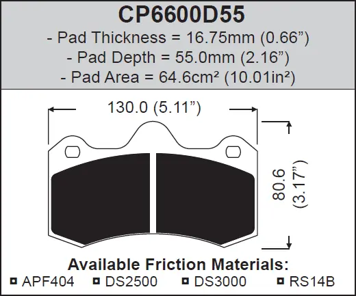

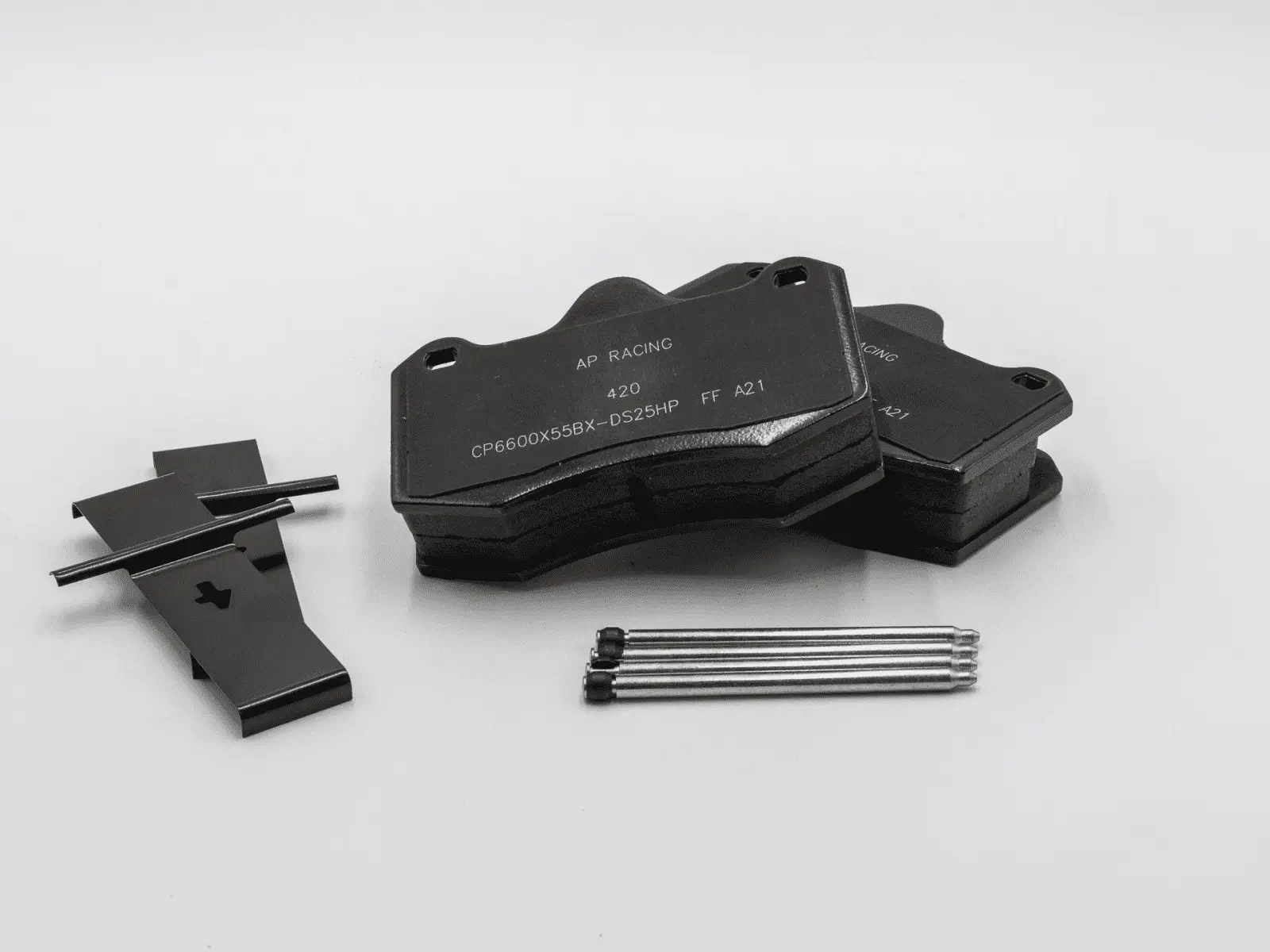

The rear pad for the same car (2021 Evora GT) is Lotus part number A132J0001S, which is printed on the pad as AP Racing 420 CP6600X55BX-DS25HP, so it's a similar configuration to the front pad but in a slightly smaller geometry to suit the smaller rear rotor.
AP Racing offers this aftermarket in their own APF404 compound, Ferodo DS2500, Ferodo DS3000, and Pagid RS14B. Lotus likely has the pad made for them in the DS2500HP compound to match the fronts.
