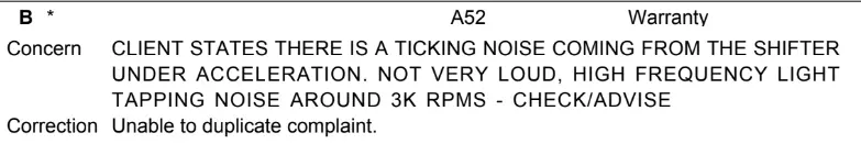

@CK99 It seems my dealer doesn't want to deal with this issue. I test drove with a technician and confirmed this noise. But they are still saying they cannot duplicate this noise. :rolleyes:

Yeah I mean it’s a confirmed issue that lotus is aware of. My car has been out for a month now for this so I really hope it’s resolved when I get it back
@Bimmernate Let me know if had any luck with you dealer.
What a bunch of cucks. Tell them to drive it and they will hear it lol.
I was told all new shifter cables would fix it, that or finding the sweet spot when adjusting them. I declined the new cables as it would involve gutting a decent amount of the interior.
I was told the same, they are replacing my crossgate cable with a new cable. It got to the point to where I could not enjoy the car with the annoying noise
