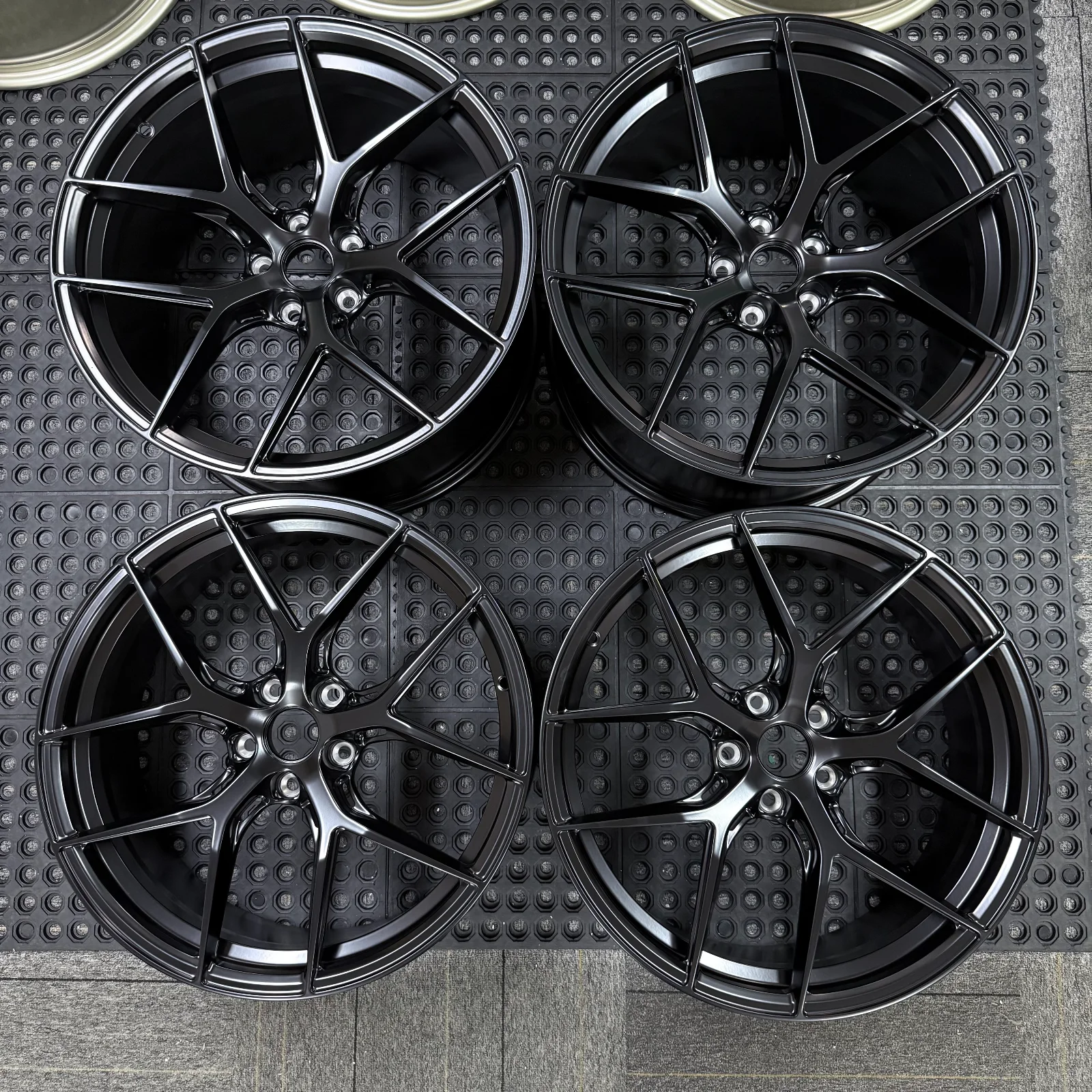

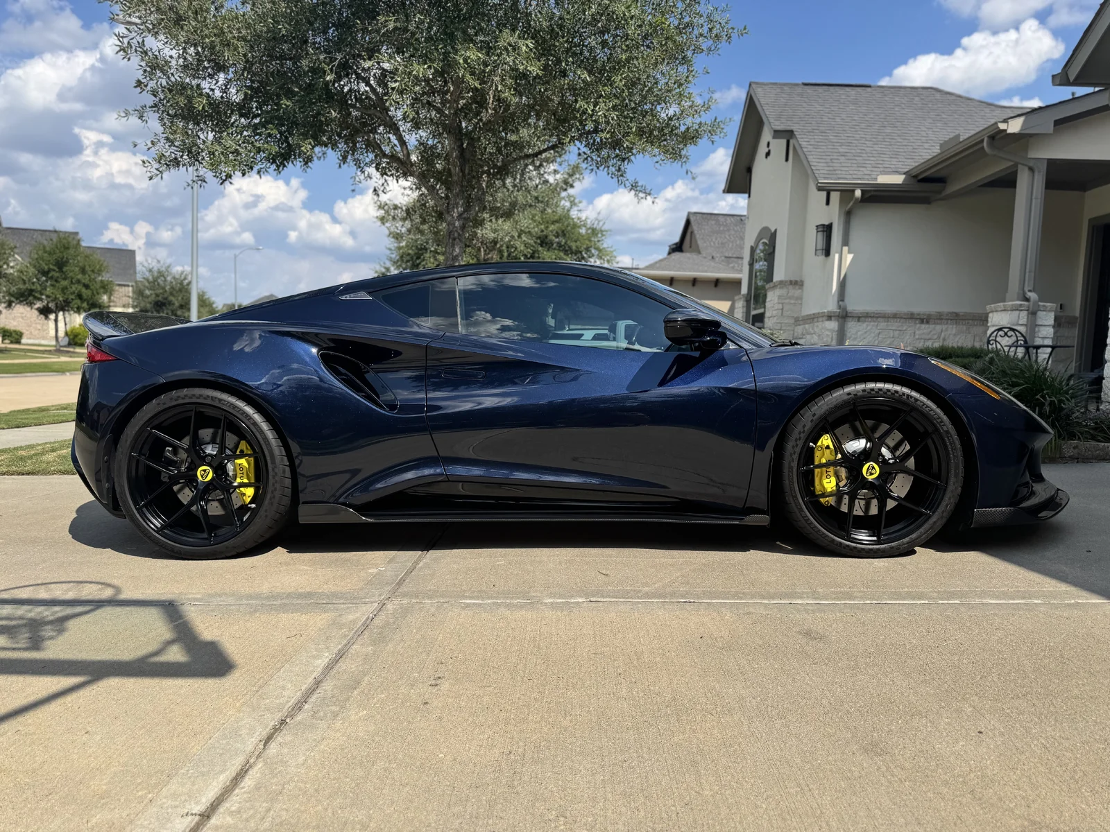

Custom wheel pictures
Rear
10.5JX20 ET42
Front
8.5JX20 ET47
Stock tires PS2
Thanks for the info.....assuming you have a V6 since you went with ET 42 in the rear?
Are you happy with this setup? Would you do it the same or change anything?
I am happy with the setup. Before, I had 12mm spacers front and back on the stock wheels. I felt like it needed a bit more concavity on the rear tires. That being said, with this new wheel design the car looks much more aggressive and overall compliments the side skirts and front spoiler. Here’s another image of the wheels before mounting.

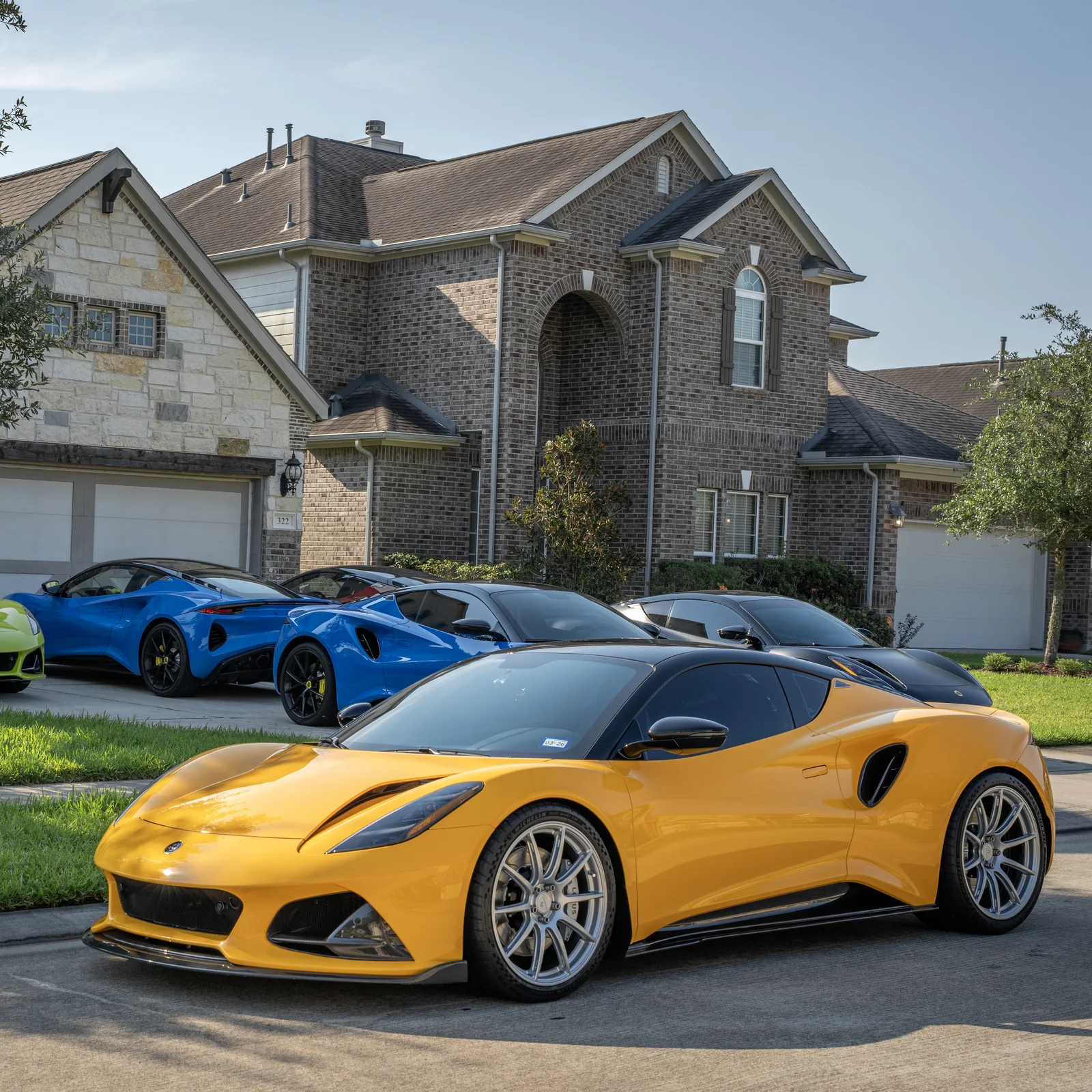

Considering a set of two piece wheels with a deeper outer lip but I'm unsure how that style affects offset. Any wheel fitment gurus available to explain? Can I just order OEM size/fitment with an additional -12mm offset or do I need to take the lip width into account?
You can do 12mm less offset up front and 15mm less offset in the rear — 12 / 12 if you want to be really safe. You also need to be able to clear the brakes front and rear which are pretty bulky. If you’re going full custom they’re going to need all of your clearance information in addition to size width and offset. I’m waiting on a custom set of ce28n reps with a sizable lip on them.
Gotcha. Yea I'm running 12mm spacers right now so I'll probably use the same offset adjustments, maybe just 10mm front. These are the style I was looking at (though I don't think I can justify the HRE price tag), looking at them now I'm not sure the lip is even large enough to cause an issue.
