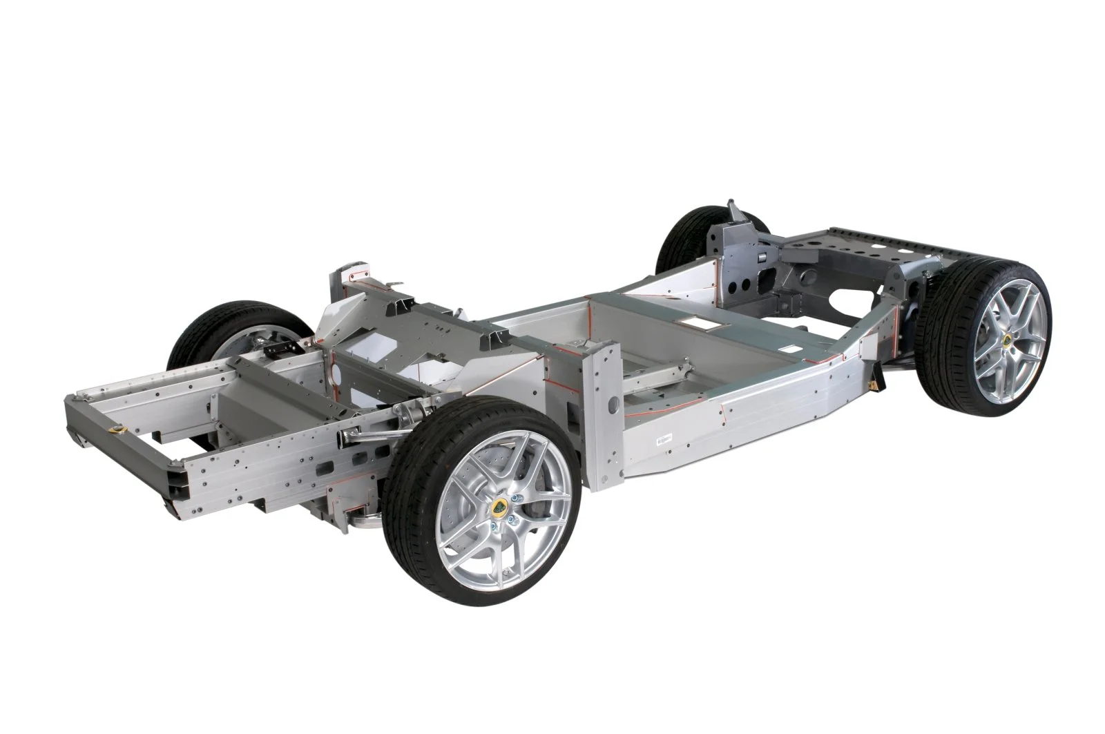

Had the dreaded creak recently. My dealer loosened and tightened some chassis bolts and it has gone. It was not the undertray.
Since the chassis is bonded, does that mean it was the front or rear sub-frames attached to the tub?
The chassis is bonded ,bolted and riveted. There is no subframe.
Well, the two parts without the orange glue (at the front and back) is what I call the sub-frames. The Elise and Exige didn’t have those two pieces, which led to a lot of cars being written off after minor accidents.
Exactly what happened to my 111R. 15mph ding to the front corner, enough to write it off
