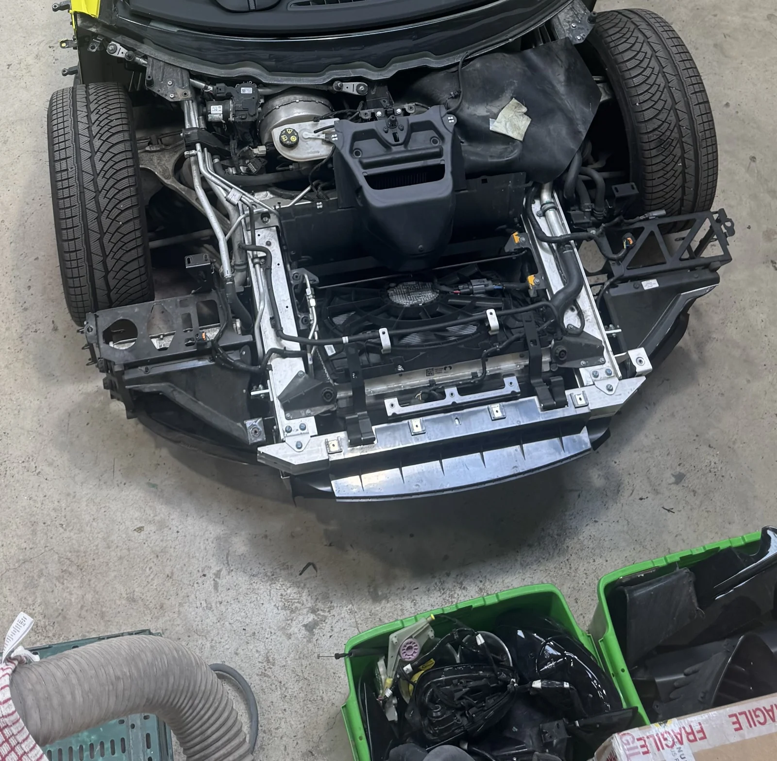

With all the parts finally in, Beaconsfield now completed the rebuild of the front end.
It's actually quite fascinating seeing the car in this state because you can clearly identify everything that was damaged in the accident—the brand-new shiny parts are a bit of a giveaway. More importantly, you can also see what didn't need replacing.
The front aluminium chassis remained completely original and undamaged. Both the front subframe and even the front crash bar are untouched. The upper plastic bumper support wasn't so lucky, and most of pipework, wiring and brackets above the radiators also had to be replaced.
The passenger side (on this UK car) took the brunt of the impact, so all of the front wing supports on that side are new. You'll also notice the redesigned front wing brackets—they look like a revised part and I'd imagine they're probably a little lighter too (Lotus style - must be worth an extra 10mph).
The wheels and front suspension was all undamaged. Also luckily the front wings pushed themselves out rather than straight back so the doors were untouched.
One thing that made me smile was seeing the Lotus recall-fitted rubber bib still hanging on in there, complete with the gaffer tape from my rather agricultural attempt to patch up all the cracks and holes. Ironically, the silicone sheet I'd ordered to make a proper replacement turned up just a couple of days after the accident. Typical timing.
There are still quite a few parts waiting to go back on when all the panels are reattached as you can see from the contents of the green boxes. And that innocent-looking cardboard box? I'm fairly sure that's a pair of new headlights...
...roughly £5,000 worth of headlights sitting in a cardboard box. Best not drop that.

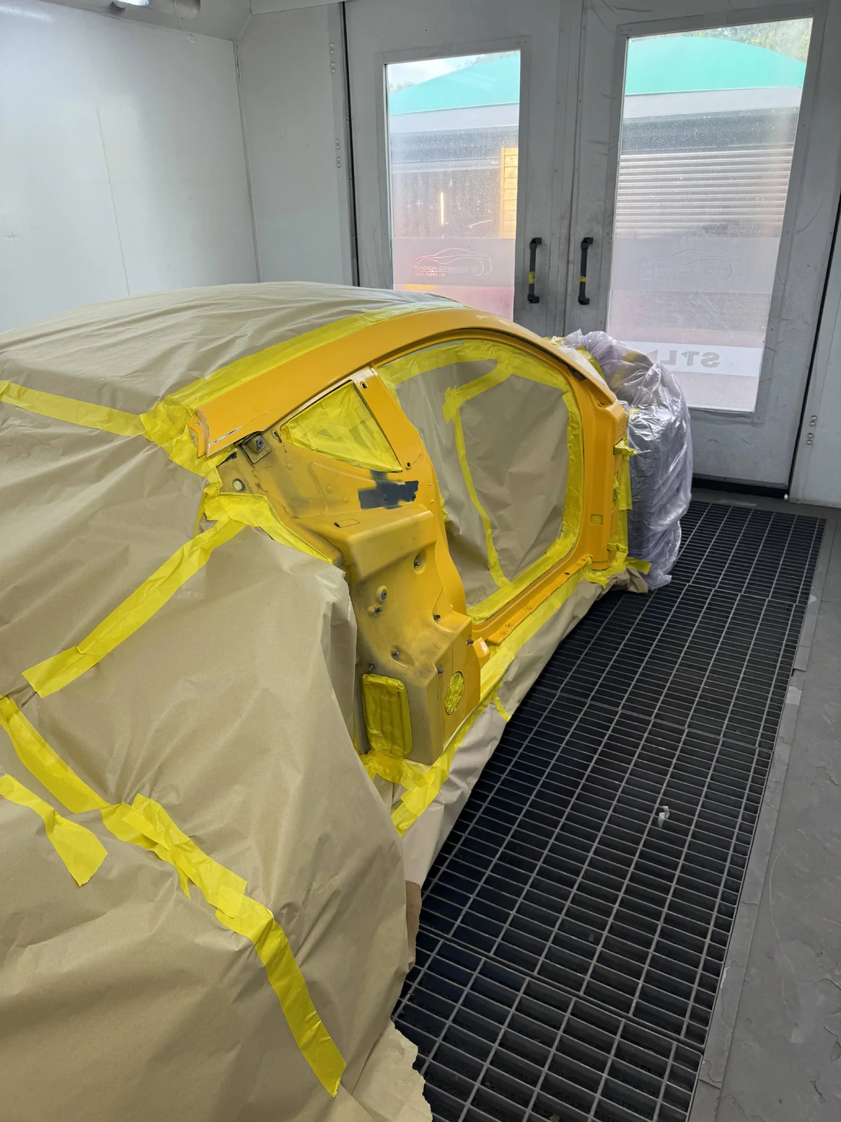

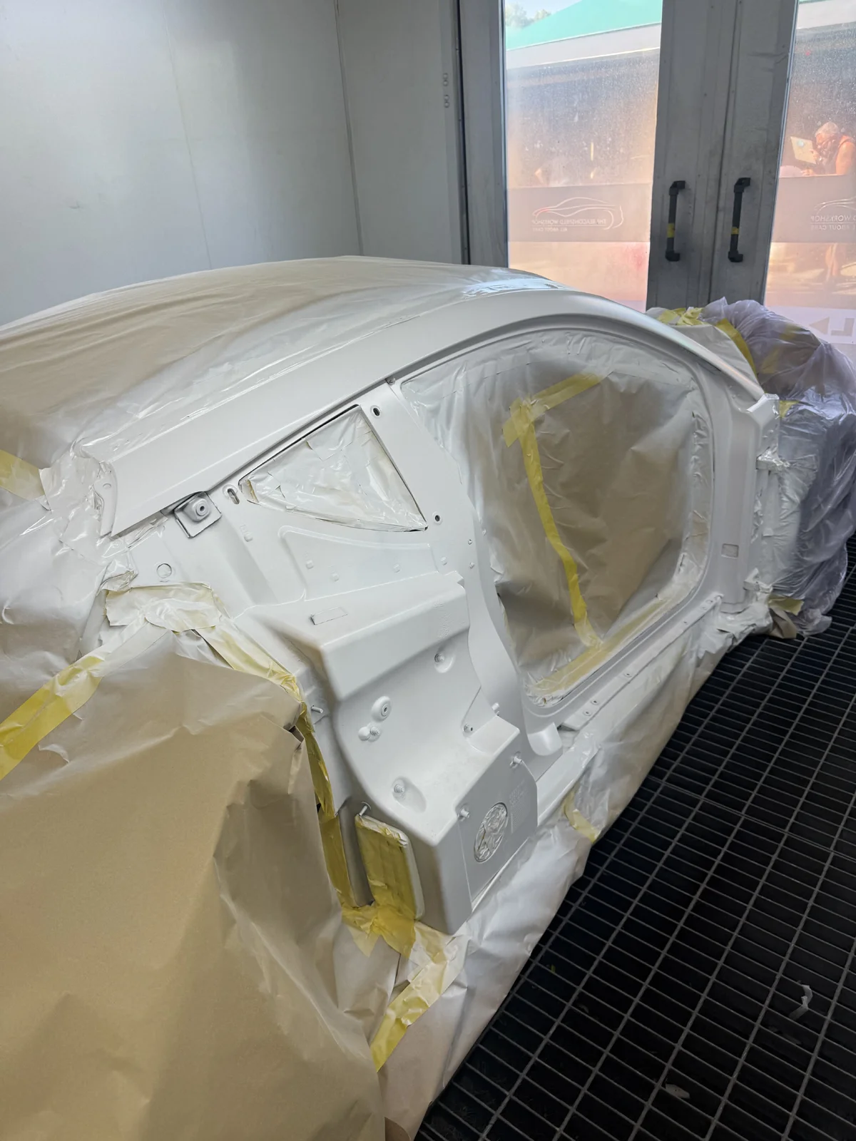

First, the original Lotus paint was carefully masked and flatted back ready for blending in.

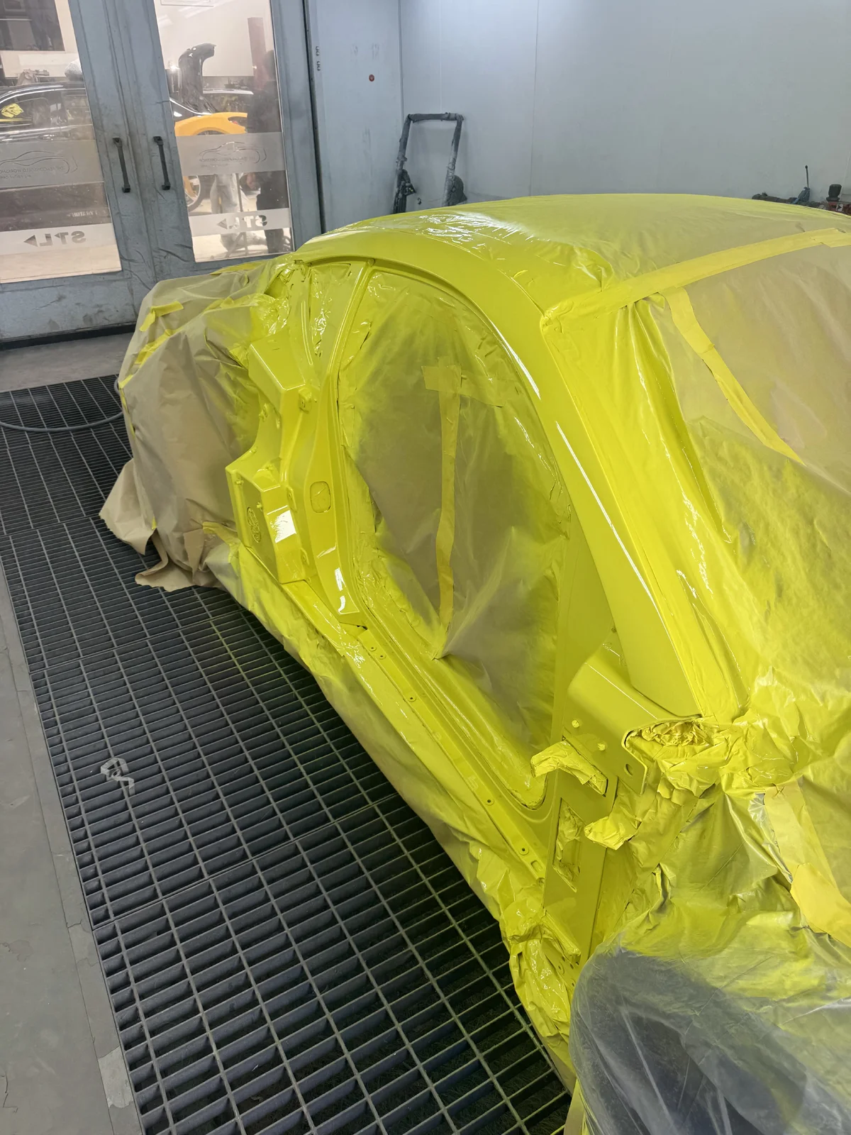

Then the primer went on.
And finally... the first coats of the new colour, already looking better than the Lotus factory robot paint job.
There's also a gel coat involved on top of the base coat, although I'm not entirely sure which stage this particular photo was taken at because it already looks pretty gloss.

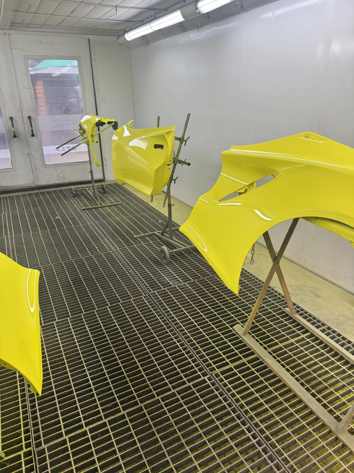

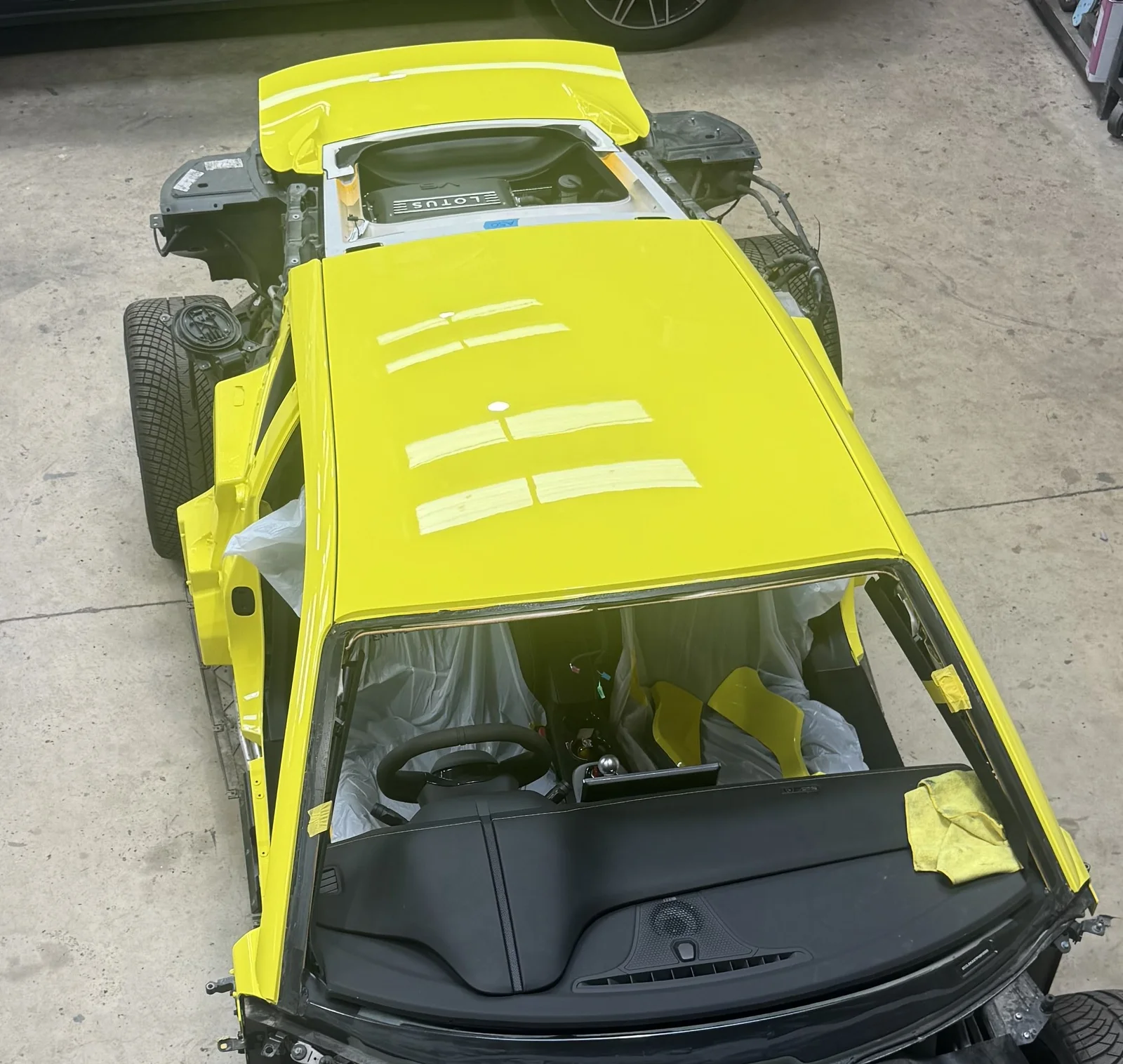

The good news is that all of the body panels are now painted—front and rear—I haven’t a photo with the bonnet resprayed but I assume it has been. The resprayed panels are the first real indication of what the finished car is going to look like.
One thing to bear in mind is that these photos are taken under the body shop's bright LED lighting. That tends to exaggerate the slight green tint in the paint, making it more noticeable than it is in natural daylight. (For anyone interested in the science, white LEDs are actually blue LEDs with a yellow phosphor coating, which tricks our eyes into seeing white light.)
The roof is now painted, and the engine cover is starting to go back together (well, apart from the bits sitting the passenger seat).
Then comes what is probably the most exciting stage so far...
The first test fit.
With the doors and rear hung back on, the car suddenly stops looking like a collection of painted panels and starts looking like an Emira again. Wow! 😋 Subtle is one thing it is not. 😎
Check out how the colour is changing tint slightly under different intensities of lighting.
Although it looks almost finished in these photos, appearances are very deceptive. There is still a lot more that you might expect still left to do.
Both doors still need completely rebuilding internally. A lot of electrics need to be refitted front and rear. Every light, vent, grille, bracket, seal, trim panel, mirror, fuel cap, badge, decal, number plate etc. has to go back on. Then comes what is probably the most time-consuming part of the whole repair—adjusting every panel until all of the gaps are exactly right.
When Beaconsfield replaced my driver's door previously, it came back with panel gaps that were actually better than when the car left the factory. I also had the infamous issue of the rear bumper sticking out slightly on one side. My dealer's response was the traditional "They're all like that, sir." Beaconsfield quietly adjusted it and made it properly flush. So my expectations for this repair are understandably pretty high.
It’s worth remembering next time you take your Emira in for replacement panels – it’s a lot more than a quick old panel off, new panel on and respray.
And that's where things stand today.
You're now pretty much as up to date as I am. Tomorrow is my scheduled weekly phone call—by now it's probably become part of Beaconsfield's routine—and hopefully there'll be another batch of good news and progress to report next time.
The first test fit.
