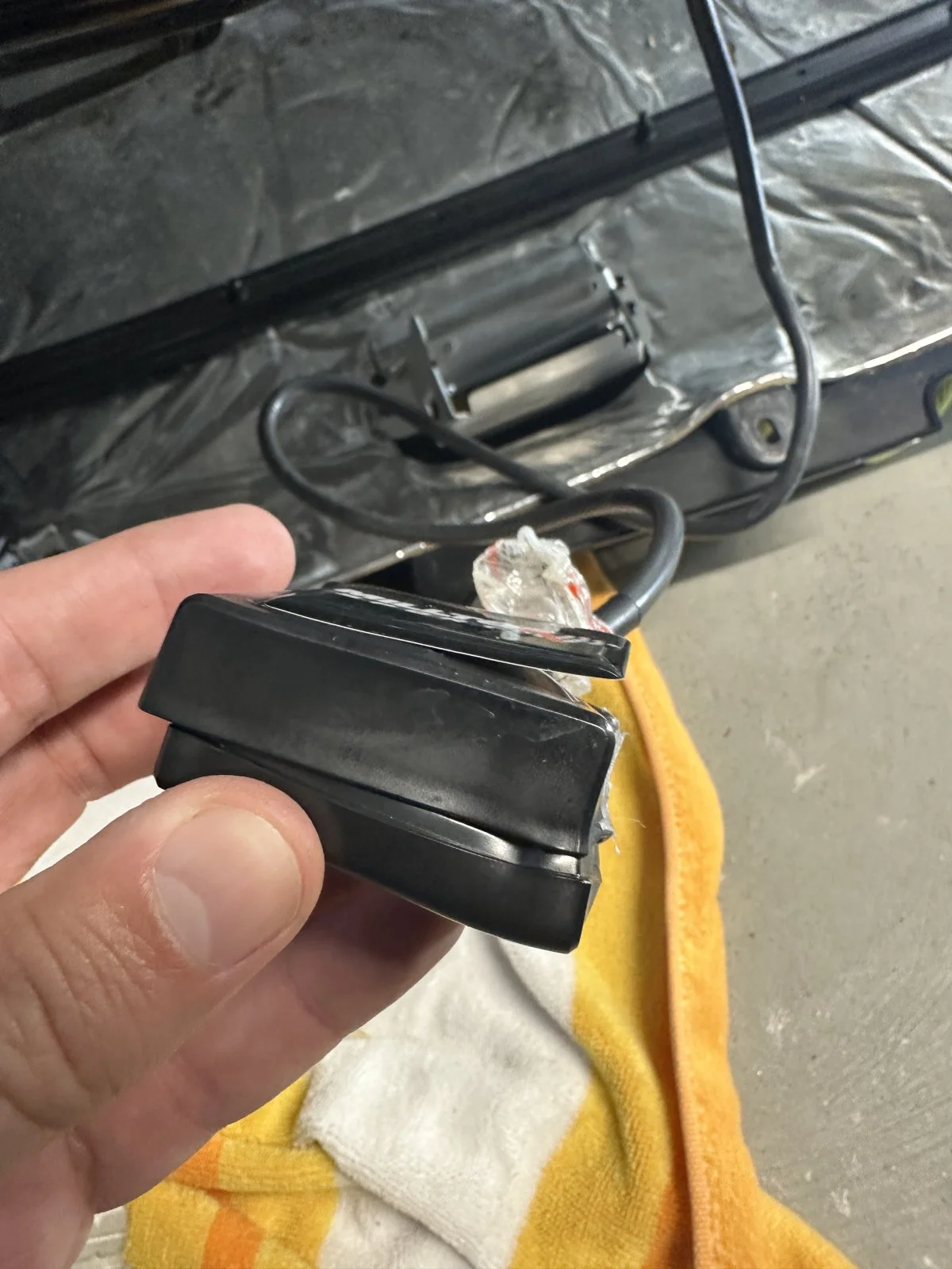

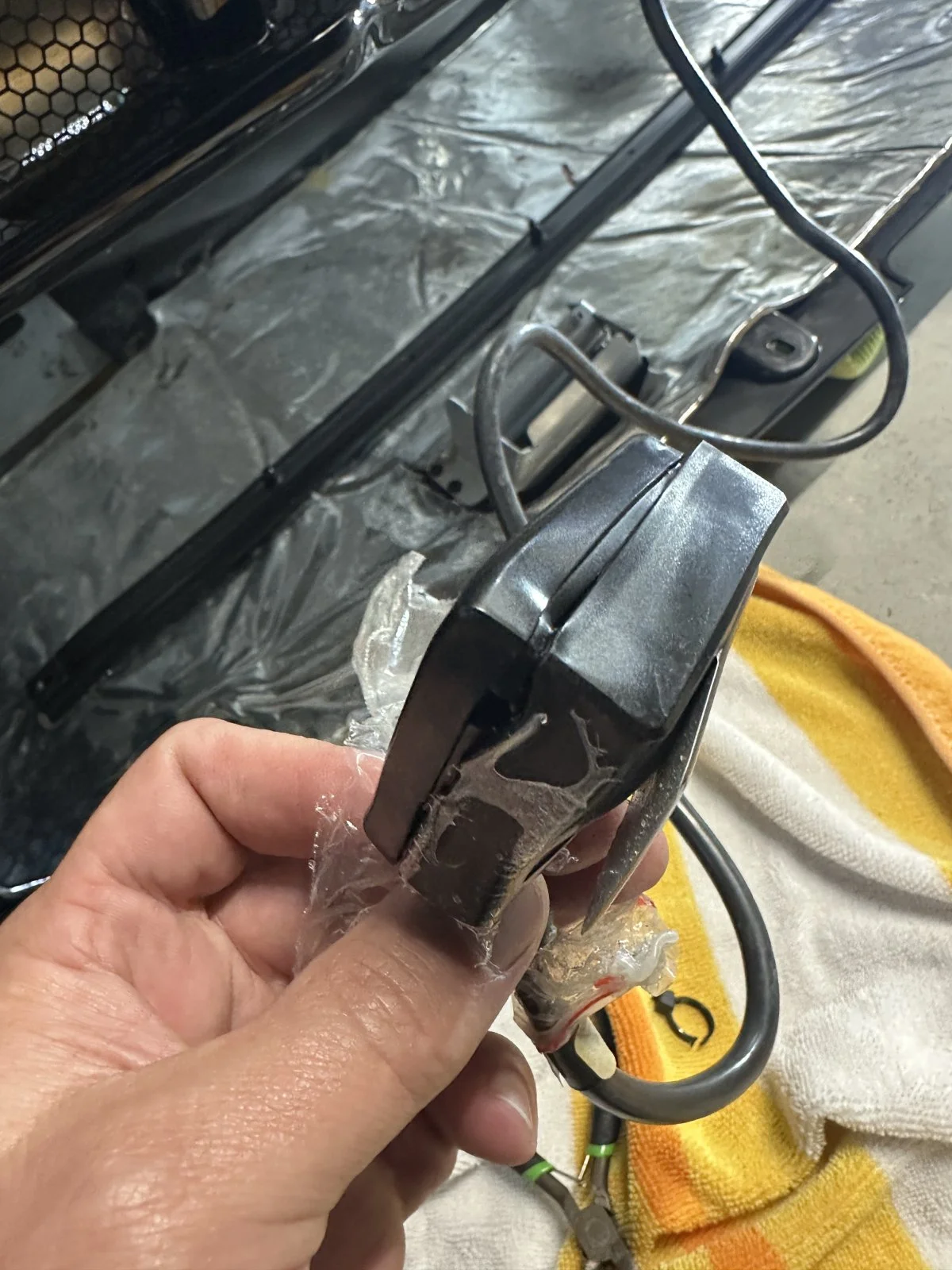

mine is mounted right behind the license plate. it was the only place that hid it somewhat,.
Take it out you'll find it's probably melted, you should get a new one and remount it on the corner of the bumper, I think Greg has some photos of where to mount it on his site.

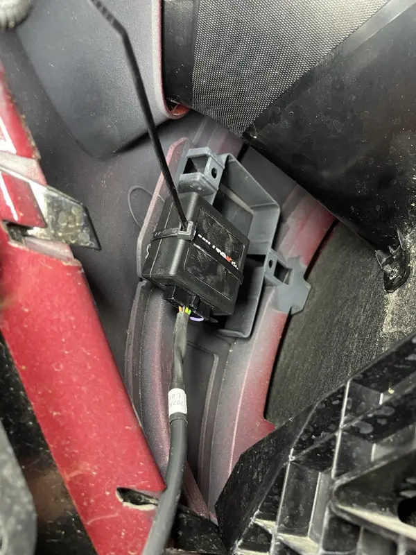

^ This. Do not mount it behind the license plate. Take the time to run the wires along the bottom edge of the diffuser trim and mount it over in the wheel well cavity. With three little carefully placed zip ties you can’t see the wires once everything is bolted back up.

DO NOT PUT IT BEHIND THE PLATE !!!!
I removed mine, not melted, but I opened it and the circuit board is corroded. I assume water got in somehow as I could not see any seals. I do recall strange check engine lights after a wash, so it may be just that it got wet inside :(
