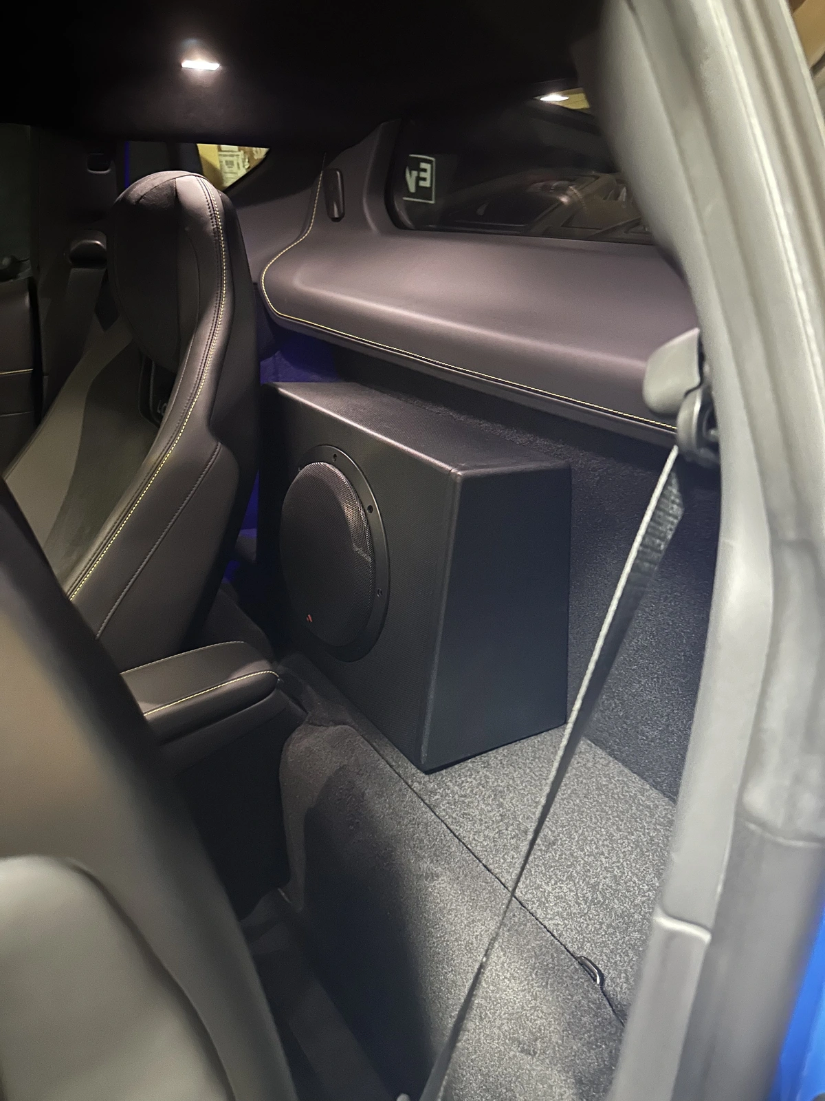

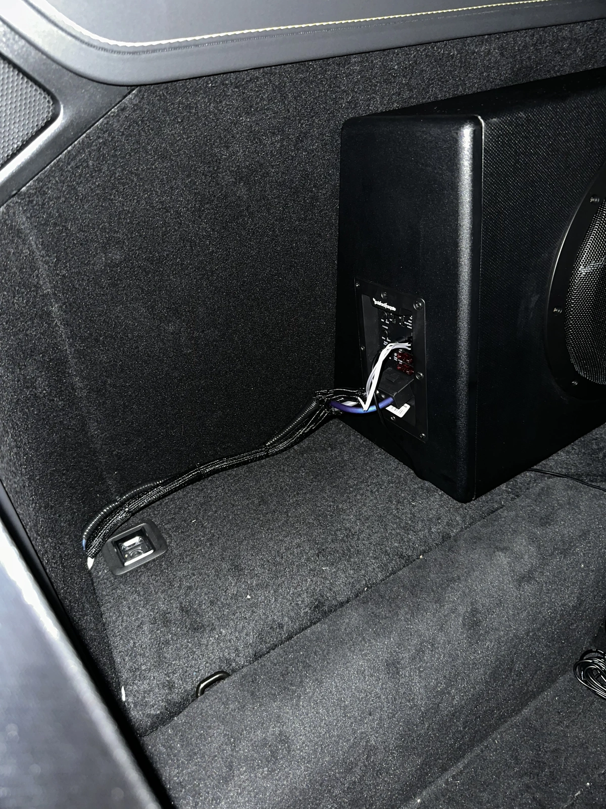

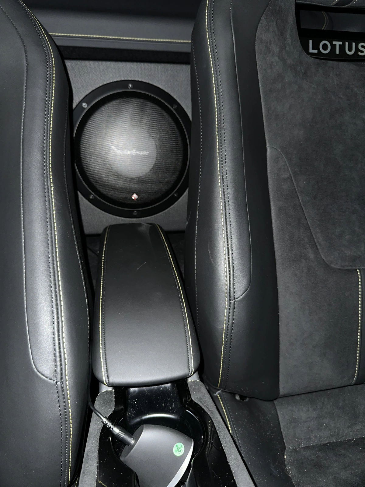

I added one to mine, all in I think it was under $600, night and day difference of course, but honestly I prefer driving with the radio off and hearing the car 😂
I went with the all in one Rockford Fosgate P300-10T

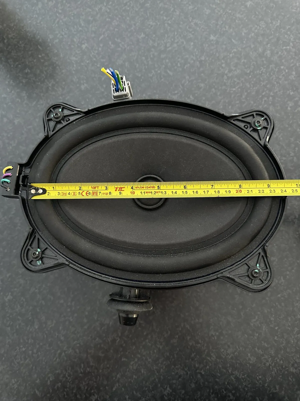

I would really like an option where we can upgrade the sub in the factory location. Perhaps find a better 6X9 inch sub or retrofit an 8-inch round model. I'd really rather not install a sub box on the rear shelf. I've looked up 6X9 inch subs and there appear to be 5 or 6 that may be a better (more powerful) option however they have much large magnets so they probably would not fit without serious modification. I'd pay decent money if someone created a custom solution that fits in the original location, even if that area had to be modified a bit to make everything fit. I'm also not sure if the factory amp could support a different 6x9 or 8 inch sub if they may require more power.
An 8" is not that much larger than a 6x9 in terms of cone area. You would need something with extremely long excursion and that means a deep basket and a large magnet structure. It would be a lot easier to get similar levels of performance out of a more generic 10" subwoofer driver because of the cone area advantage.

A pre-made integrated sub box like the Rockford Fostate can probably be installed for $600-700 all in. A half way decent audio shop works with all kinds of expensive cars. The Emira wouldn't really be that much more special. Just a sub-box install would take them 2-4 hours of work, probably. If you don't like the way the Rockford Fosgate sub looks, there are many other brands, including ones with composite enclosures that look sleeker and take up less space.

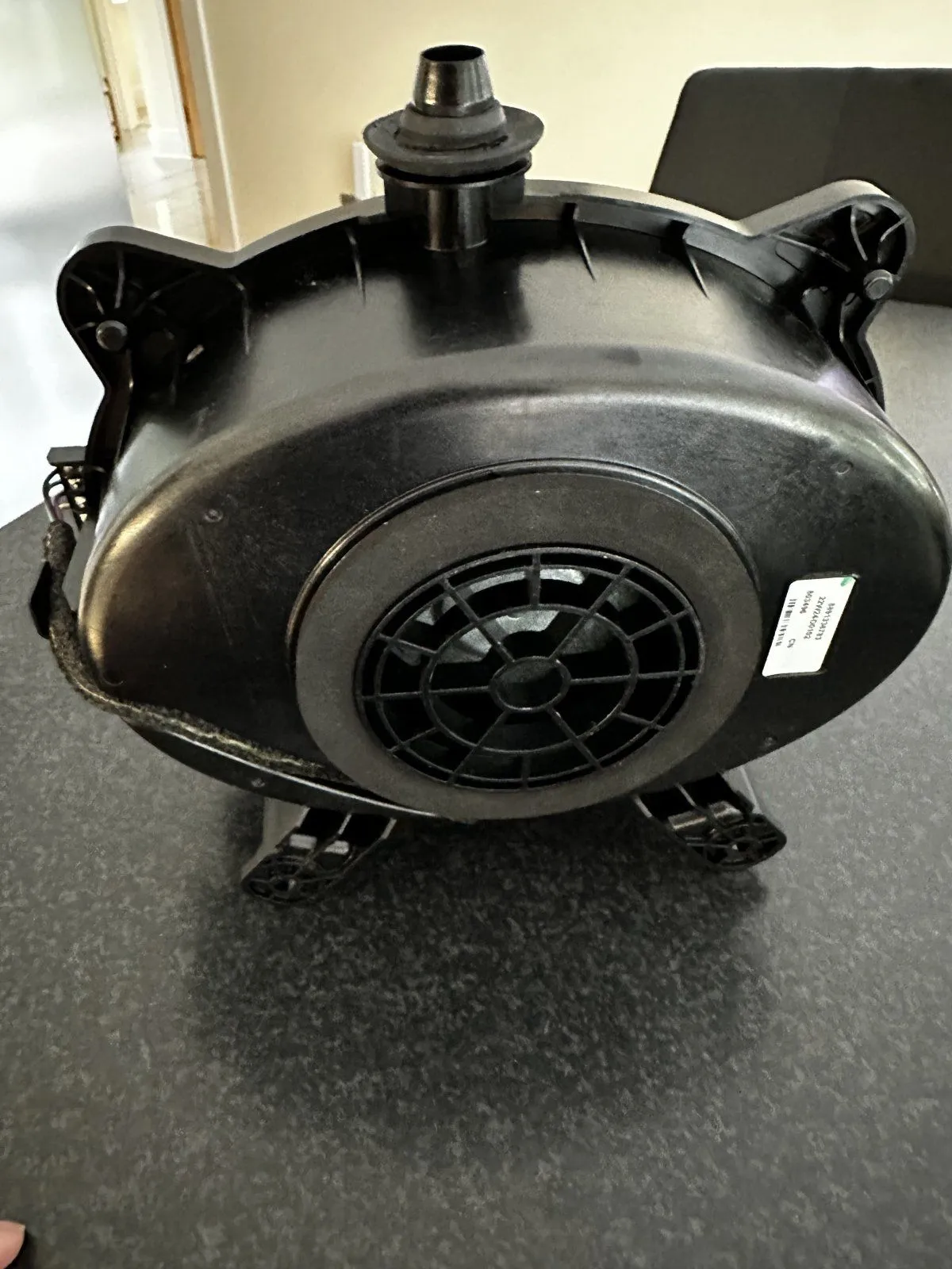

Fitting a different driver into the stock subwoofer box is unlikely to work due to different flange designs. Also, the subwoofer box vents out the back to the outside of the car - it's kind of an infinite baffle design. Even if you got the MMATS subwoofer to fit, for example, it's a poor fit for open baffle applications due to the relatively low Qts, low Vas, and high Fs. I guess you could always seal up the subwoofer box. But again, you have to get the driver to fit in the first place.
This subwoofer is not designed by KEF. KEF supplied the three front drivers and *POSSIBLY* assisted in tuning the overall system but we don't know. The subwoofer is a "Fresh air" design provided by a different company.

I'm in the process of replacing the audio system as it is terrible IMO for this level of car. What they call a sub is hilarious and weighs like a pound :-) I am buying the kit from kjwemira to install some proper speakers ... separate tweeter, 6.5', 5", low profile sub, and an amp. I can't give up the entire bench for a large sub so just adding a better quality sub along with the better speakers and sound dampening will improve the interior immensely.

Come to think of it, you can design and 3D print a flange adapter. It would add some thickness but you might need that additional clearance for the MMATS subwoofer to fit into the box anyway since it has that huge magnet in the back. If you do that. I don't know how much frontal clearance there is between the stock subwoofer and the trim panel, though. So making it protrude out a bit may bump/rub against that? I don't know.
As for driving the MMATS subwoofer with the stock amp, the most immediate problem is that the MMATS driver is a single voice coil while the OEM sub is dual. So you are going to lose half the power off the bat. The MMATS driver is 4 ohms and I don't know what the OEM sub is at impedance wise, so you may lose further power there. And then MMATS is probably less efficient due to the higher cone mass and stiff suspension, plus you'll likely be sealing the box. It may not keep up in terms of output. As a replacement amp, this should work well in bridged mono mode:
