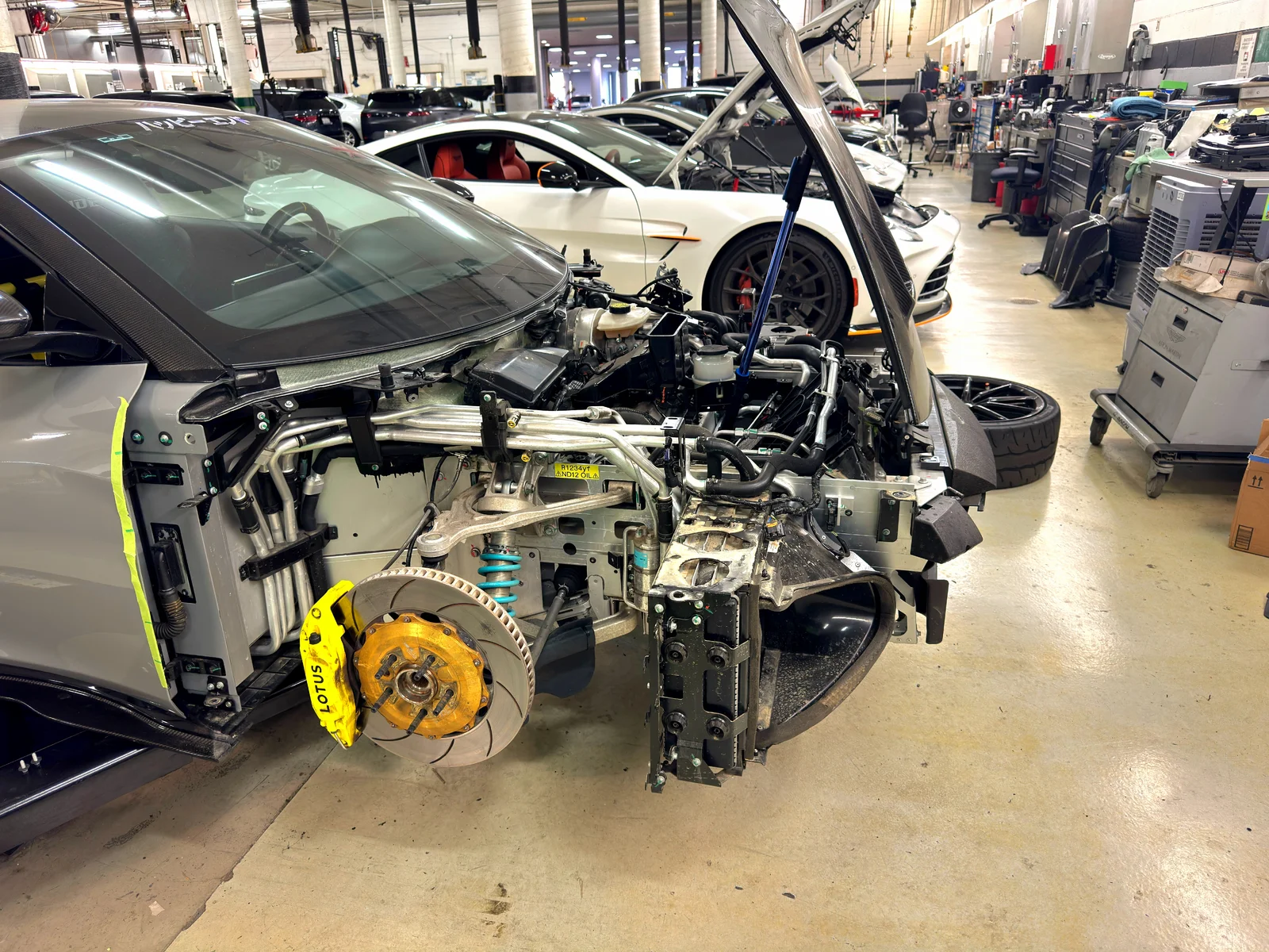

91 degrees Fahrenheit outside and just like that my 2026 with 2500 miles stops working. Not fun. In shop now. Anybody else have AC issues?
Unfortunately it seems to be an issue that’s not too uncommon. There are quite a few threads on this topic that you can find to perhaps shed some light on the various causes. At least it will be fixed under warranty whatever the reason for failure. I’d be a bit pissed myself but hopefully it will be taken care of quickly.
Evap temp sensor went bad on mine and is quite common with many Emiras, the entire hvac assembly has to come out which means the entire front end of the car is removed. Once the parts arrived it was done in one day at my service dept at the dealer. Very quick service at Galpin - have had no issues since then and the ac is icy cold.
