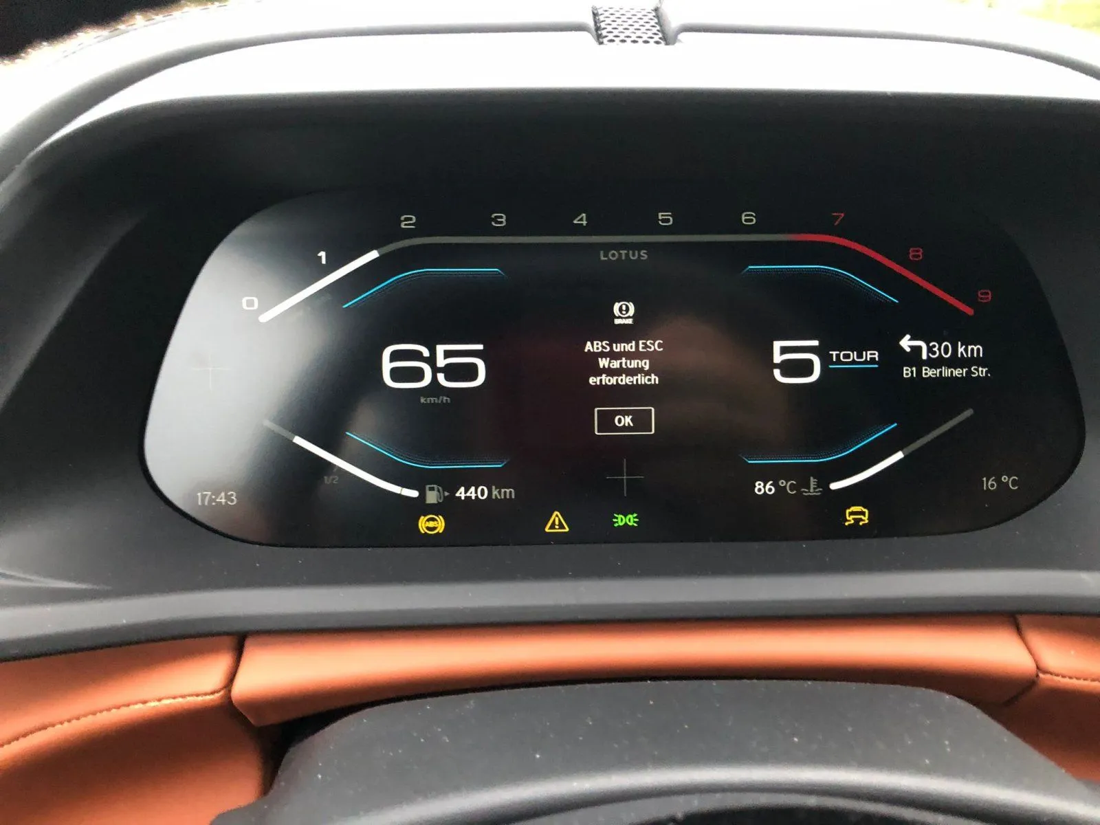

Hello,
I am new to this forum. I live in Germany. Bought my Emira 2 weeks ago. It now has 1500 km on the speedometer.
When I went on the "Autobahn" in rain suddenly yellow light went on ABS, ESC and the yellow Alert triangle. It's already in the Lotus garage in Hamburg. Has everyone else similar problems with the electricity? The Emira has got all new software prior to delivery. Thanks for any hints...
Thomas

The "in the rain" part may be more relevant than you realize. Could be water in the wiring loom. Make sure you have the dealer check the wiring, particularly to the junction box under the front hood.
Thanks. Yes, I already told him that I was driving in heavy rain when the issue started... I hope he will check the wiring as you suggested. He told me, they are not allowed to do anything by themselves and have to ask lotus in England for orders. They seem to be very upset about their relationship to the lotus company... 😏

Hi. My Emira was brought to Sportivo Leipzig in october 23. They immediately found the reason for ABS and ESC issue. It was the magnetic ring for the ABS sensor at the left rear wheel that caused failure... It was replaced and from there on I never had problems again, but to tell the truth, in winter I don't use the car. But I hope the problem won't arise any more.

ESC uses the same sensors, so you're probably not too far off with your ABS ring guess. I had that issue two times and it always sorted itself after 15-20kms. Maybe tell them just to drive it (if able, I got a manual V6). Seems like they are kinda prone to dirt or something. Neatly follows the water issues. It's almost like they never tested the cars, but who am I to guess..
