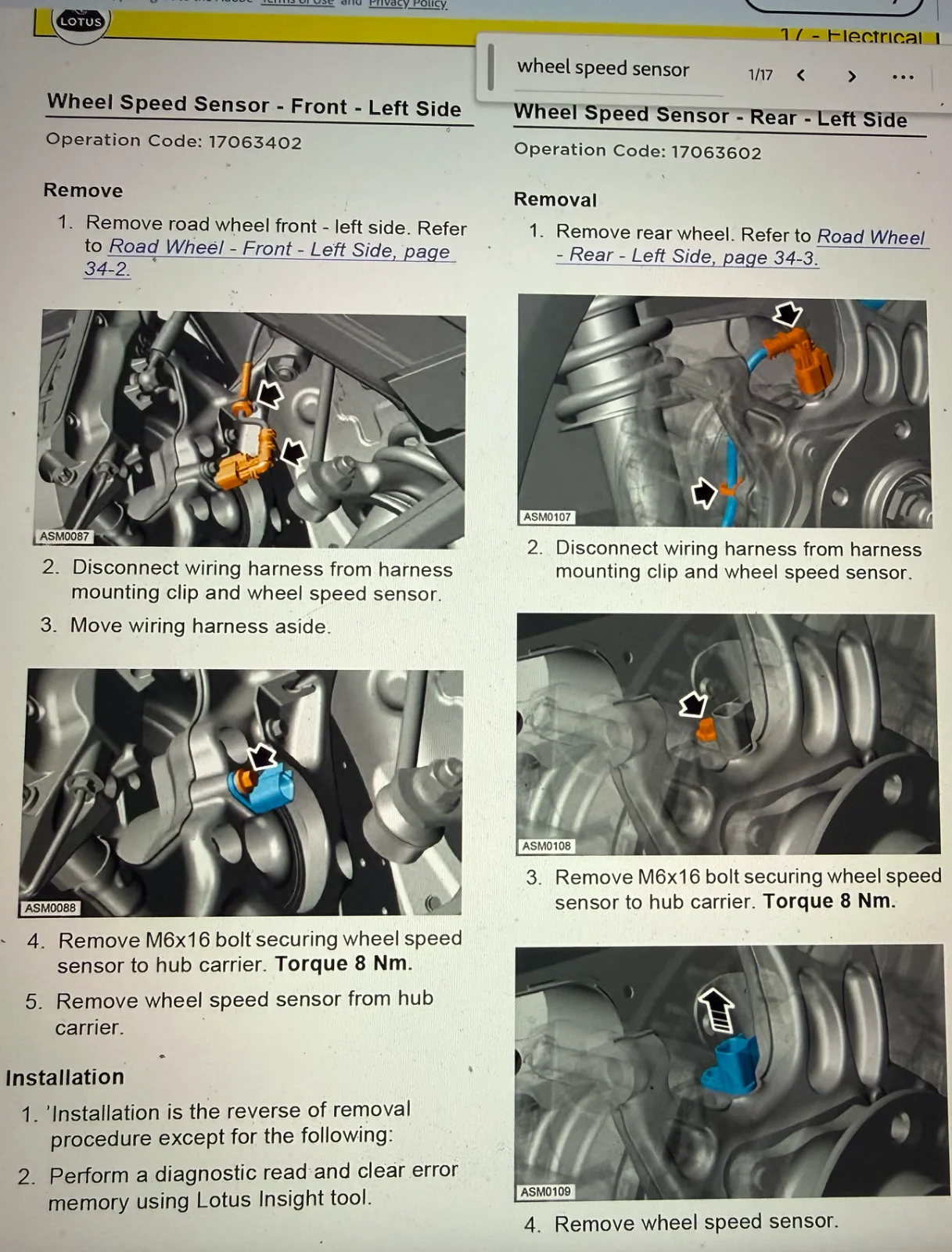

From the Service manual...
So where is the abs ring? The above service manual says to clear error using the lotus insight tool. ....why? Is there a fault everytime u unplug the sensor?
