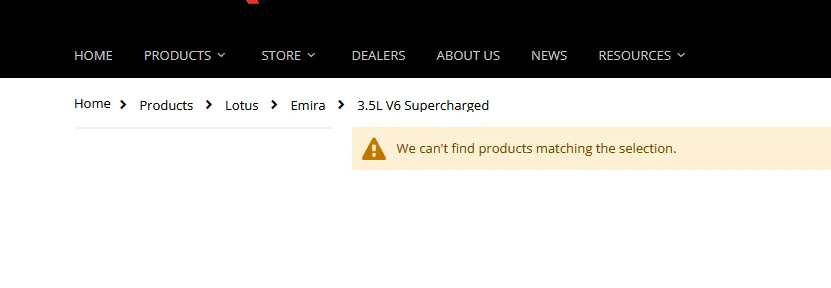

Not listed on their site yet. sounds nice for sure

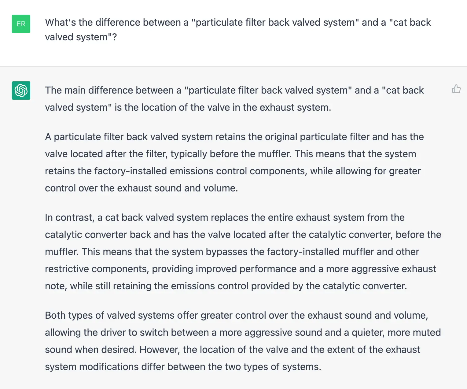

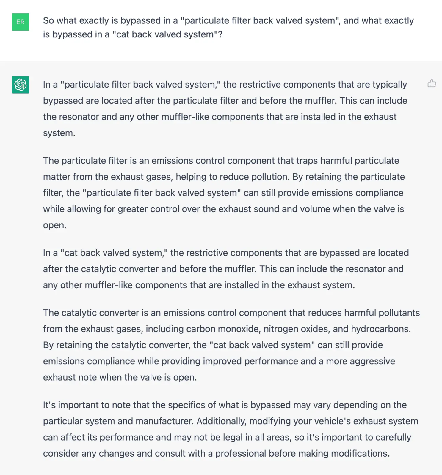

For anyone else who's a moron like me, ChatGPT was able to shine some light on the difference between these two setups:
To explain this a little bit more clearly here are your exhaust parts in order for the V6:
  1. Engine exhaust ports (3 per bank, 2 banks)
  2. Exhaust Headers (2 total, 1 per bank)
  3. Individual Header Primary Catalytic Converter (2 total, 1 per bank)
  4. Collector & Resonator (1)
  5. Secondary Catalytic Converter (1)
  6. Exhaust Valve (1)
  7. Muffler (1)
  8. Exhaust Tips (2)
The confusion here lies with the terminology Milltek is using. The V6 Emira as far as I'm aware does not have a particulate filter. Those are typically fitted downstream of the catalytic converter. For their purposes I think you can safely assume their reference to a particulate filter is the secondary catalytic converter.
So what this means is:
Milltek Particulate Filter Back Valved Exhaust:
- Replaces #6, #7, & #8
- It leaves the secondary cat in place
- This is sometimes also called an "axle back exhaust".
Milltek Cat Back Valved Exhaust:
- Replaces #5, #6, #7, #8
- It may also replace #4 depending on how much they are optimizing.
- It deletes the secondary cat but leaves the primary cats in place.
- This name is very confusing because while it's a cat back exhaust for the primary cats, it ignores that the secondary cat exists.
