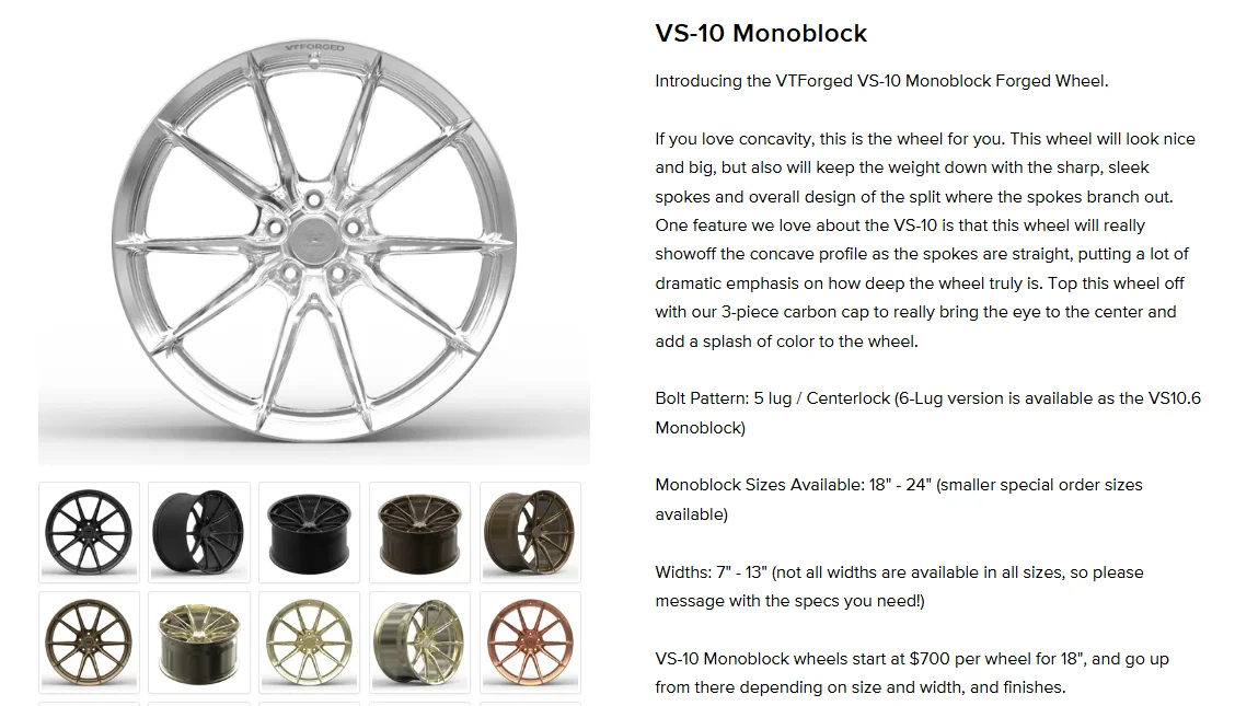

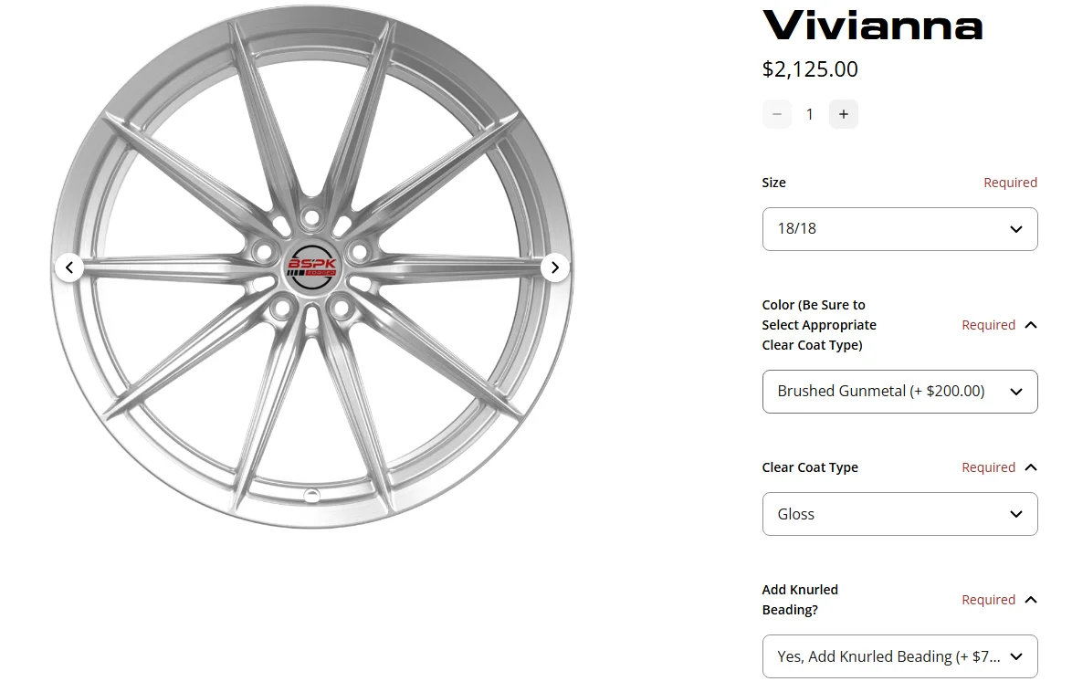

Looking at BSPK & John quoted me a price on 18 inch magnesium wheels. Don't know how much more weight savings it will be yet.
Deciding whether it's worth the extra money to go magnesium, but it's almost triple the price! 😰 What am I to do???
I really want to run slicks for the track.
This is my Forged choice:
Mg would be very tasty! I'd love to own a set one day, but the price delta has me second guessing all the time.

Nice! But what I like about the wheel choices I made is that, even though the 18 inch wheel is smaller, these designs have the spokes reaching more towards the center, thus giving the wheel an overall look of being larger, which to me is more aesthetically more pleasing.
Will you allow custom made designs or have other wheel choices, as well as, colors like bronze?
Yes, any design you like. I also have a gallery of designs you can choose from. Some may incur an increase in cost due to design. I will DM you the file.
