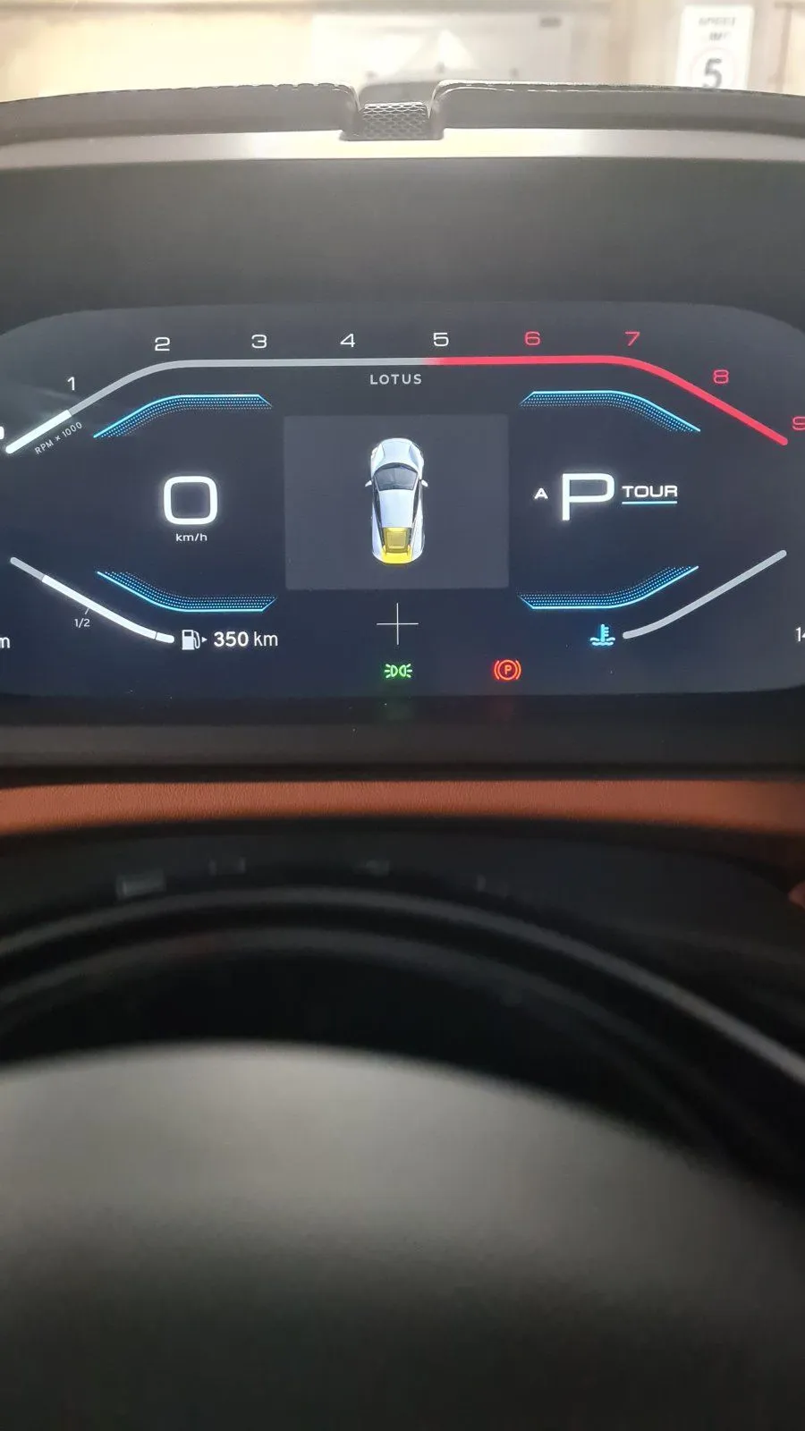

You have to make sure the boot is closed and latched on. I always have to give the boot a firm press down in the middle to ensure it has latched.Hi everyone, do you know this light means?
The yellow light on the boot comes on intermittently. Sometimes the yellow light turns red too.
Thanks
Michael
Defrost alert for frozen foods?Hi everyone, do you know this light means?
Thanks
Michael
Echoing what @Yas.totti10 said, the yellow shows when the car is stationary, the red when moving. Also the car rear lights will be on indicating that the boot isn't latched.Hi everyone, do you know this light means?
Thanks
Michael
Spot onEchoing what @Yas.totti10 said, the yellow shows when the car is stationary, the red when moving. Also the car rear lights will be on indicating that the boot isn't latched.
