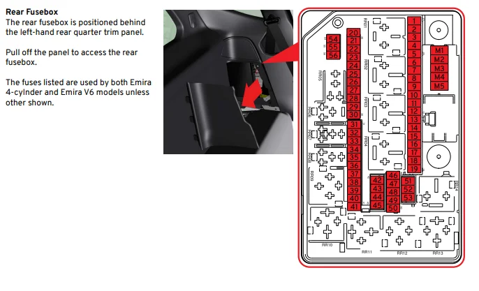

Window washer pump front relay - 30 Amp - position 39 - in rear fuse box.

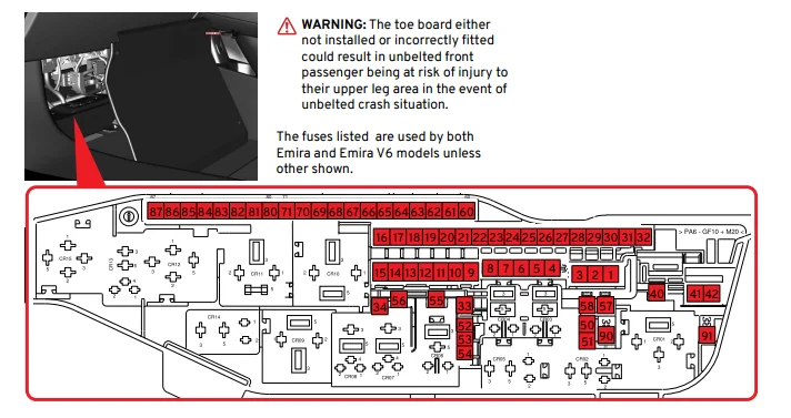

Wiper fuse is not shared - that is Wiper motor module - 30 amp - position 5 - in passenger footwell fuse box.
