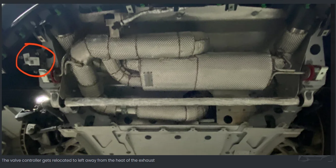

Boomgear SS and Ti exhaust (fully heat-shielded with valve controller relocation and OBD valve control)
Is this Exhaust & relocation kit originally made by Mach 5 performance or Boomgear?

Wait, so the OEM valve motor gets moved (im assuming to keep for no CEL), and in its place is a aftermarket valve motor and controller thats on the new exhaust valve? And the after market part is more resilient to heat? Im not sure what im looking at.
