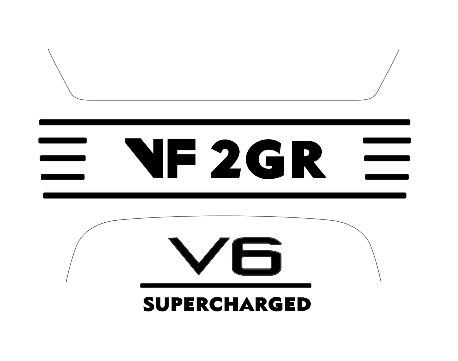

attached is our prelim. design.
Note, the TOP text/wording location is not finalized.
We want to ask the community their input because it needs to be aesthetically pleasing.
So we can simplify it (VF) logo only in the middle,
Or "SUPERCHARGED" text horizontal instead of Diagonal, etc.

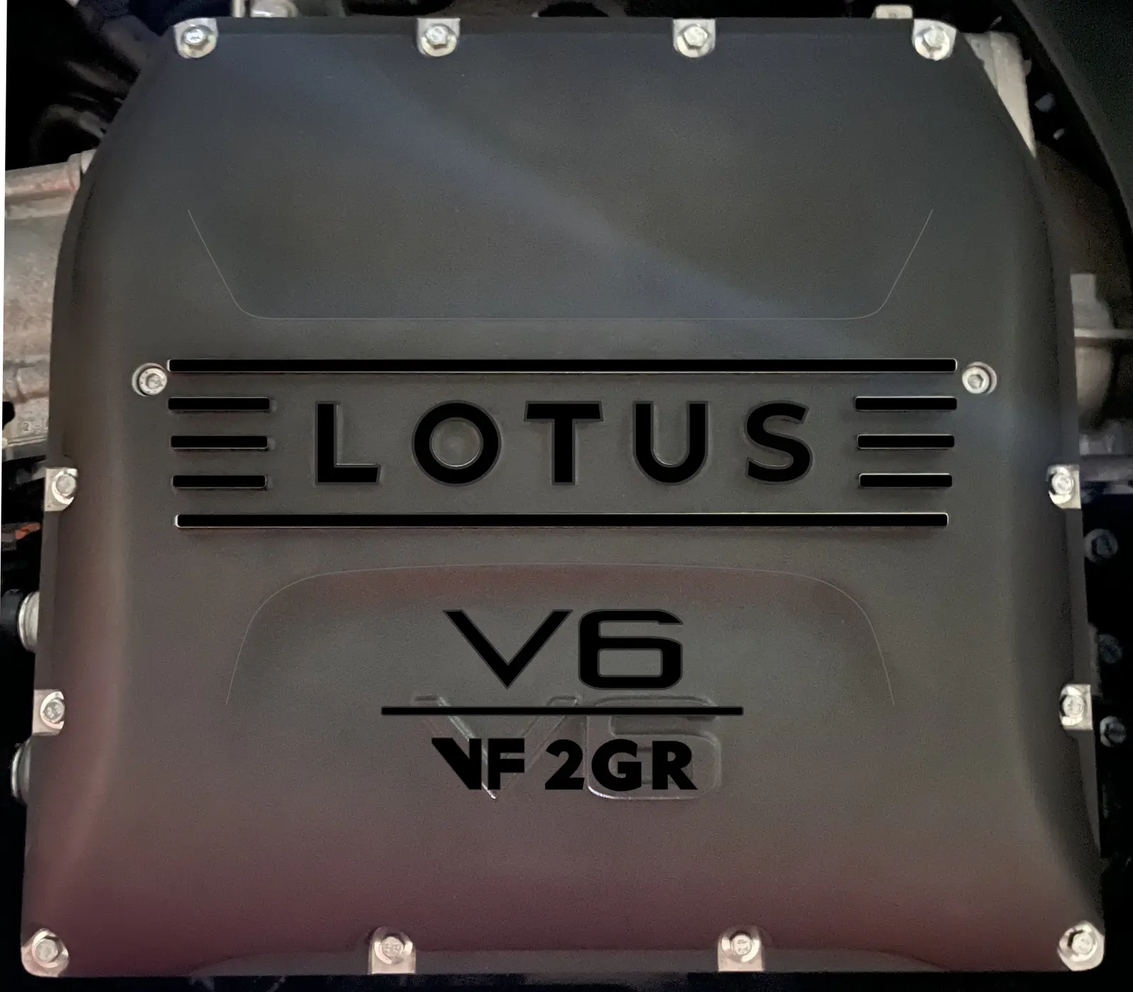

Here's my suggestion for the graphics. Gloss black on the tops of the graphics. If you decide to use it, my fee is a complimentary supercharger cover. :D
But then you'd also have to sit further to the left.... 😁
We'd also need new engine surround trim pieces as well 😁.

Gotcha. Okay, what about something like this? Looks kind of Lotusy. Again, the tops of the graphics are gloss black.
I like this design, and generally anything close to the stock look. Personally I'd like the "V6" at the bottom without the word "Supercharged" because I already added it as a separate stick-on piece to my engine bay surround trim.

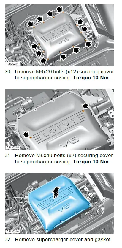

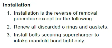

Vf can you send me the torque setting and bolt pattern to retighten the supercharger lid ,and looking forward to your new lid when it comes out until then I want to change the color of my lid with hight heat paint thanks steven
10 Nm torque from the service notes, but no pattern
