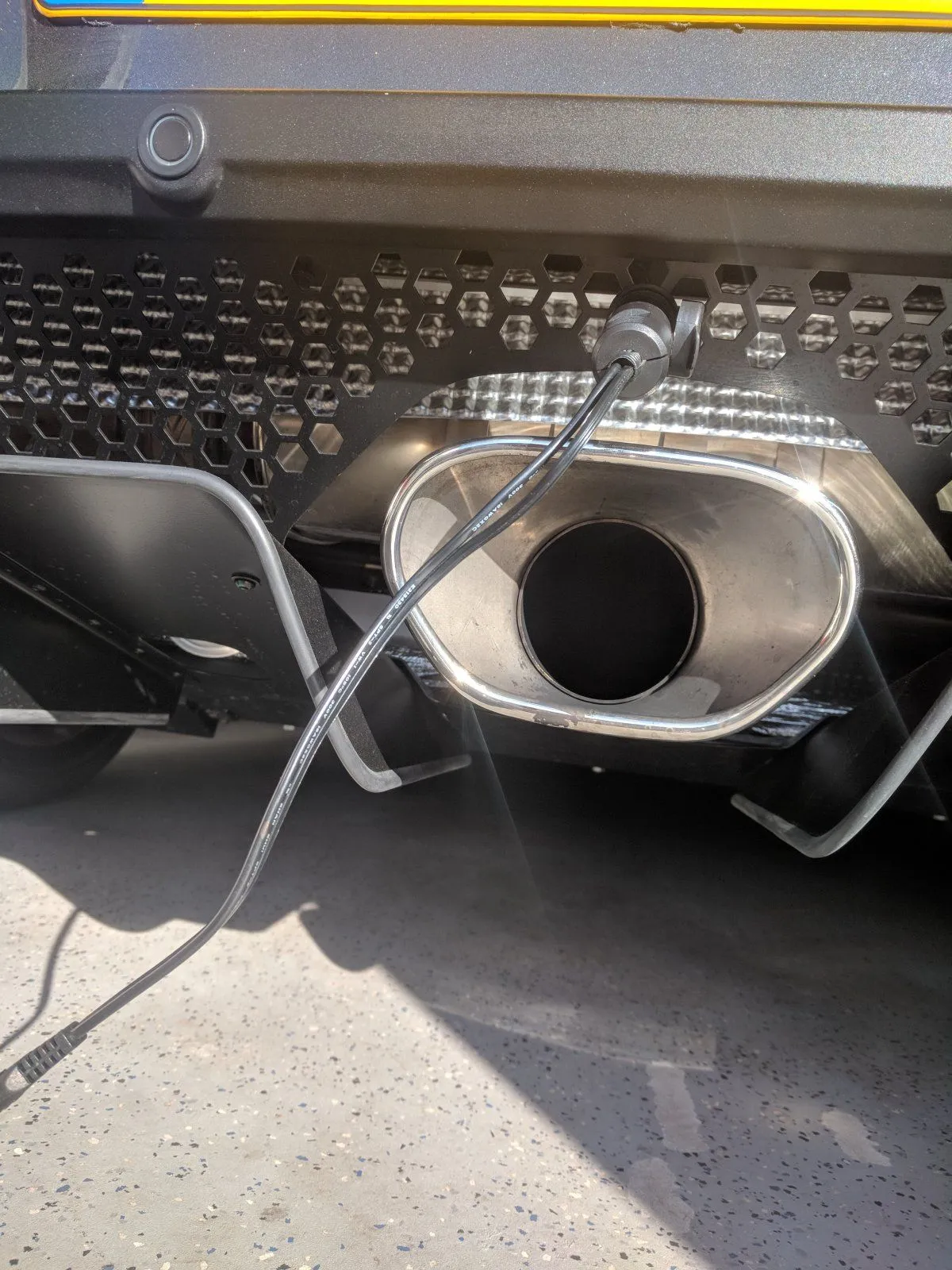

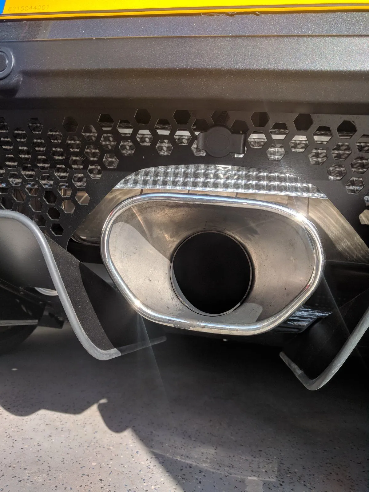

My '21 Evora GT 410 Sport has the Ion battery and the Lotus supplied tricklecharger.........
My simple failsafe solution working now already for 1,5 year..........very easy connecting.........no kneel down.
No heat problems for the female connector located in the mesh plate above the exhaust tip.....
Actually the "chrome" muffler end does not become so hot as the inner circular pipe and therefore does not harm the female connector/wiring at all.........
Furthermore the location is almost invisible and can be accessed very easily.
