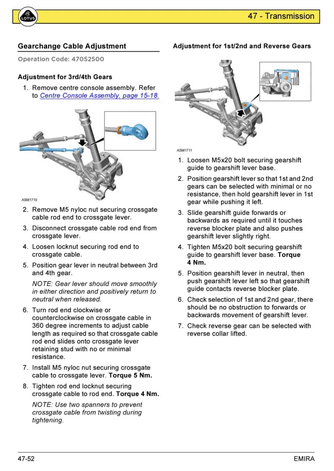

Lol they popped the plastic airbox free and set it aside. That takes what, two minutes? It's unplugging the MAF, a couple of hose clamps, some breather hoses to pop free and two bolts that hold the airbox in.Yo they took part of his engine apart

As @Porter said its probably not that big of a deal. I'm glad they properly looked at both ends of the linkage and didn't call it a day after getting it free "on the front".
