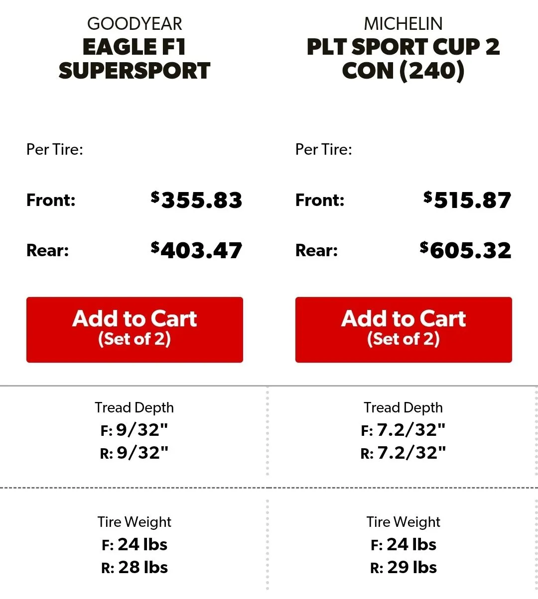

Useful info. I assume the CON 240 is because it’s the Connect version with the in-built temperature sensors and the higher wear rate?
Do they also have a normal initial tread depth, as I think the standard Cup2s start with 1-2mm less than a regular road tyre?
They don’t even come with the sensors, that’s sold separately. These just have a little pouch built in to hold the sensors.
The supercar 3 (not 3r) would be a better comparison to the cup2. I’m not sure I’d put the super sports in the same category.
Oh, for sure! I was just comparing the 2 OEM options. I was curious to see pricing and weight. I opted for the F1s, but I'll likely throw on PS4S (or maybe even Firehawk Indy500s if they're offered in our size) if they wear quickly or just aren't any good.
