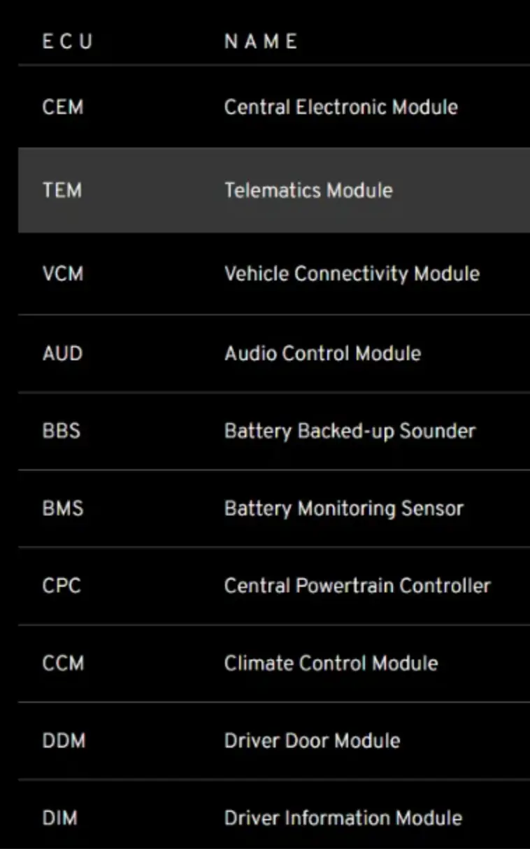

They also made 7 (maybe 8) software updates to the:
CCM- Central Control Module
VDDM - Vehicle Dynamic Domain Module
AUD - Audio Distribution Unit?
CEM/VCM - Central Electronics Module / Vehicle Control Module?
IHU - Integrated Head Unit?
TEM - Telematics Module or maybe Temperature HVAC Module?
DIM - Driver Information Module?
The car ran well before; I've never had any codes pop up or other issues (Knock's on wood). The car is also running well post the service. I've not been able to discern any difference yet. I'm hoping not to go back for any service but will probably take it in at least once per year to check for other software updates.
Sure would be nice to know what was addressed in all of the updates to watch out for any issues.
I would put my money on Telematics module. I just had my Emira in Friday for an update to hopefully fix the "limited telematics" warning with the yellow warning icon illuminated.
They flashed the TEM and the issue seems to be gone.
