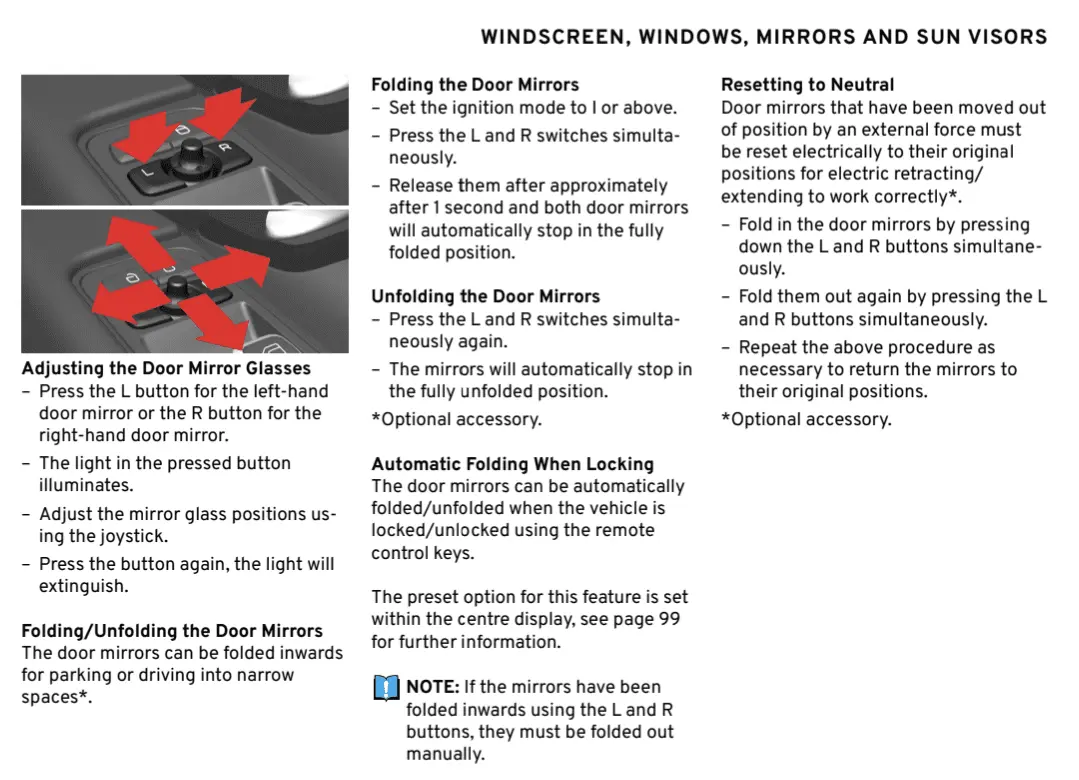

Hi,
After my last drive, the side mirrors won't unfold when I unlock. They are stuck in that position. I tried manually moving them, which you can, but when you do that, they are in a soft lock position. I.e. they move easily, they are not in a "clicked" position (as the mechanism is still folded).
Any way to force the mirrors to unfold?

Hm.. Typically you aren't supposed to manually fold powered mirrors. I'd take it to the dealer and maybe not mention that you tried that.

The owner's manual has a reset procedure for this. Right side, below:
