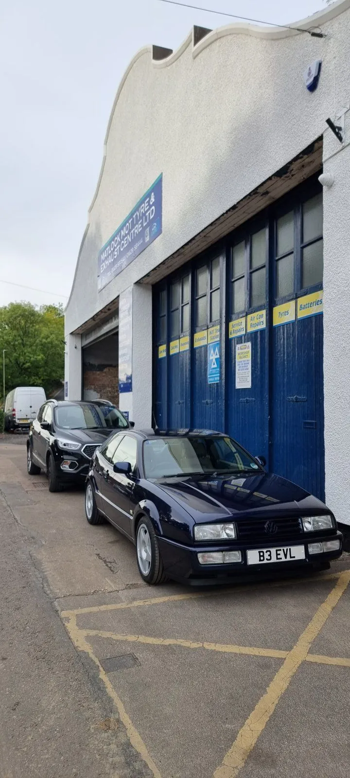

I picked my Corrado VR6 up today you would really hate that I'm sure 🙃 😋

Yes, its pretty EViL alright... haha
no, I dont hate it... it the few HP have not jumped ship in the 30 years its been around, its probably quite decent. I always liked the look of it. Next u will be going for an OPEN MANTA?
Lol you mean Opel Manta!? No I don't think so, one car over 25 years old is enough! Although Lotus Elan Sprints look very nice and dare I say good value at the moment...
