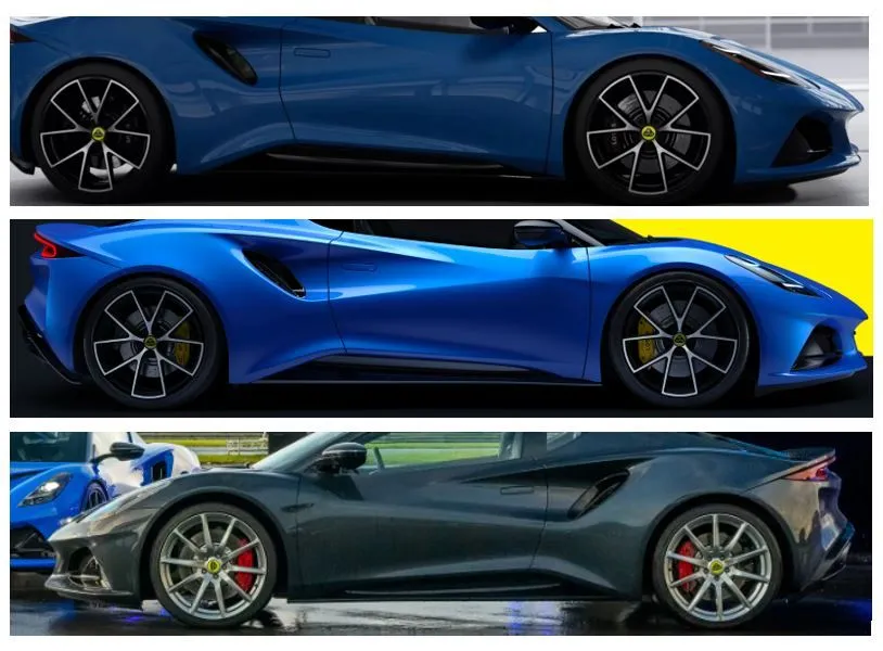

Are we assuming these cars out and about now are now production ride height? It's not terrible but it's not great either... or am I just used to seeing blue show car and my GT4 ride height/stance?

Yes they have. They have said numerous times the Seneca Blue show car is riding about 20mm lower than production height and the Shadow Grey dynamic prototype is running about 5mm above production height.
Where do you think the current configurator sits ? To me it looks like 10mm above the blue show car.

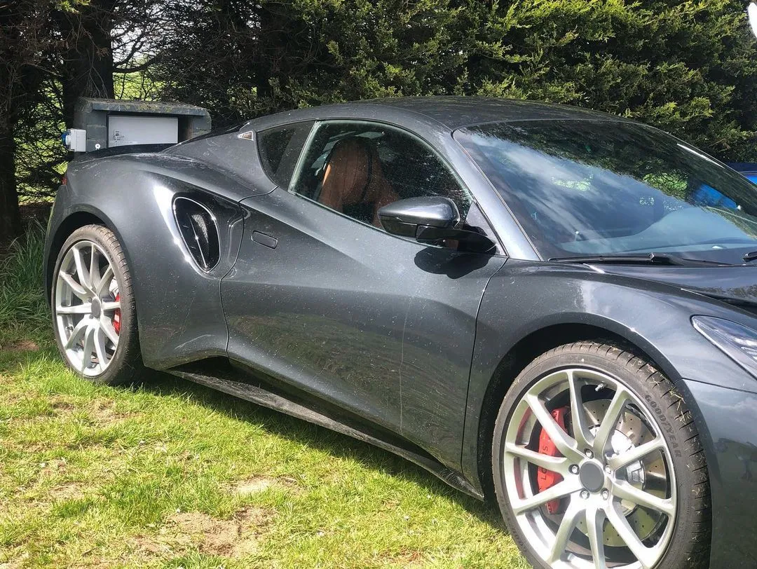

Then every almost complete car I saw on my factory tour last week is riding at least 20mm higher than what they claim will be stock ride height. And that’s why these threads exist. New cars coming off the line are dramatically higher than this claim.
And I’m really pissed at myself for not taking a closer look at the front and rear clips they had assembled but I don’t recall noticing adjustable perches. I’m hoping I’m wrong which makes these threads entirely moot.

Just thinking out loud here. DV with black pack will just make that gigantic gap look like part of the design right? DV with black pack could be called “Gap Pack”.
I’m not saying it’s “Subaru Outback” gap but it’s definitely not “show car” gap…

Where do you think the current configurator sits ? To me it looks like 10mm above the blue show car.View attachment 5594
It depends which environment you use in the configurator. I agree your screenshot looks about halfway between the blue showcar and grey dynamic prototype. But switch it to Sunlight or Studio and it changes slightly - in some views the gap also looks different between front and rear. In Video it looks different again (although harder to tell even when you pause it) and in the final few seconds when stationary it appears to be riding higher.
I appreciate in the absence of a definitive statement and pics from Lotus it's tempting to analyse every picture in minute detail. Unfortunately that's not going to solve it, we need Lotus to tell us and show us.
What we know so far is the two main cars shown at roadshows before Australia (Seneca Blue and Shadow Grey) are below and slightly above production height by amounts Lotus have stated. We also know lots of other prototypes, cars mid-build at the factory and in various spyshot/leaked photos are not at the final production height.
