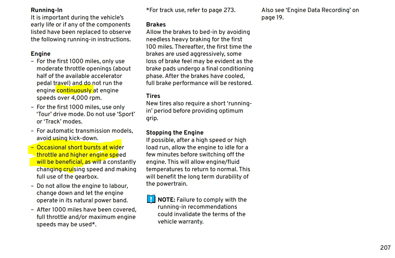

Right, my previous point was simply to show there is no 4,000 hard stop, and even in the manual Lotus is saying to occasionally give it the beans -- why? Because the engine should experience the full range of pressures to be broken in well! Just make sure it's at operating temp, you don't sit at 6000 rpm for 3 minutes, and don't beat it like you're at a race track -- but DO drive it, and DO push it to the red line on occasion, and DO run up in all gears - your engine will thank you.
I really hope that folks don't believe this "don't go above 4000 RPM" stuff - break in is documented clearly in the Lotus manual. My brand new Emira has been to the red line mulitple times already and it has only 200 miles on it...of course this is only after it's at proper operating temp and I vary what I do. Break it in like you're going to drive it.View attachment 54585
