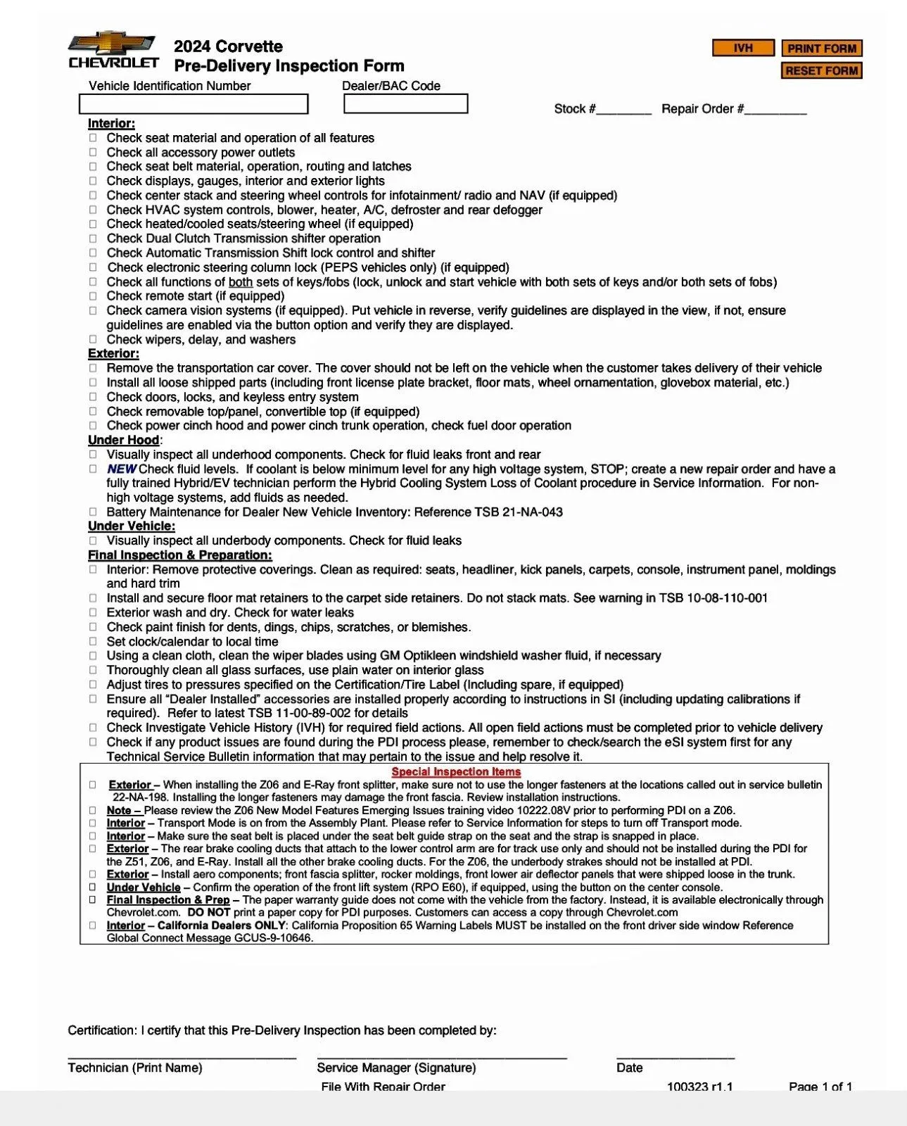

For what it's worth, attached is the 2024 Corvette PDI checklist provided by GM to its dealers, to give you an idea of what they're expected to do before delivering a new Corvette to the buyer. Of note: they wash the vehicle and for those of you who are ++++ fussy and worried about paint swirls, you should consider finding out how your Lotus dealer does this (minimum wage employee using a scratchy clothe?) or perhaps direct your dealer to hose down your Emira but not dry it, especially if it's a darker color more prone to noticeable paint swirls. Something to consider if you're super picky and would rather not trust someone else with this. This assumes your Emira doesn't have PPF or ceramic coating on it, when picked up, which will hopefully be done right.
Perhaps someone will come across the Emira PDI list and post it for all to see.
