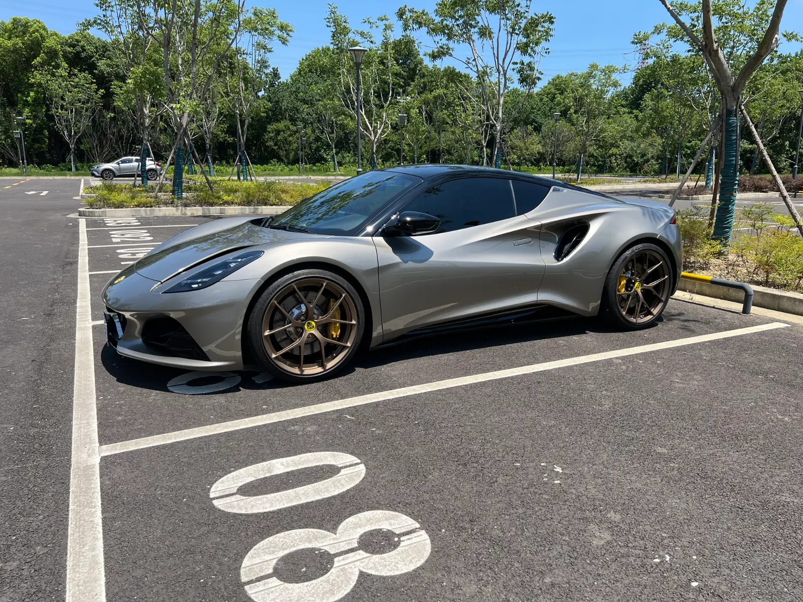

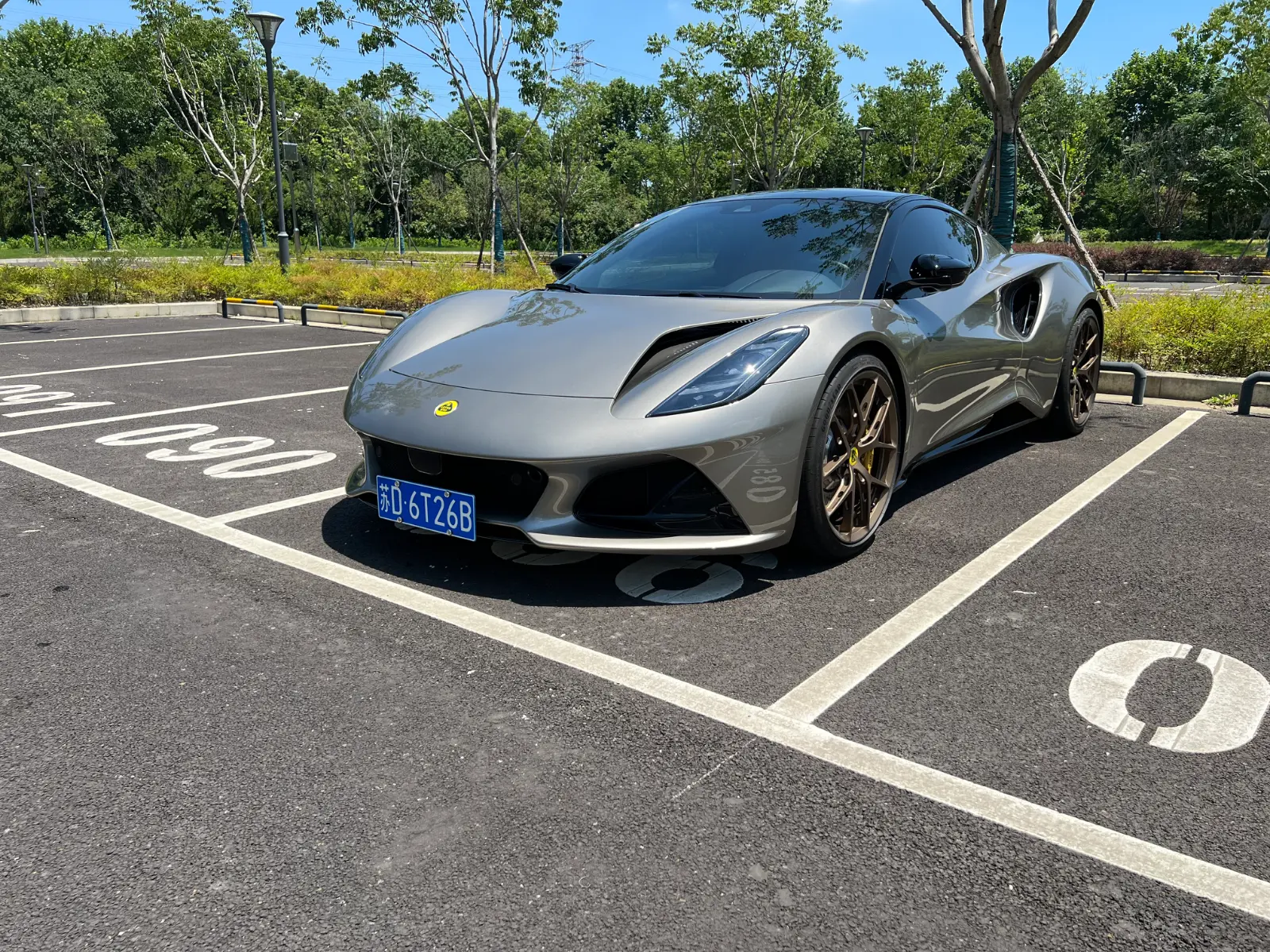

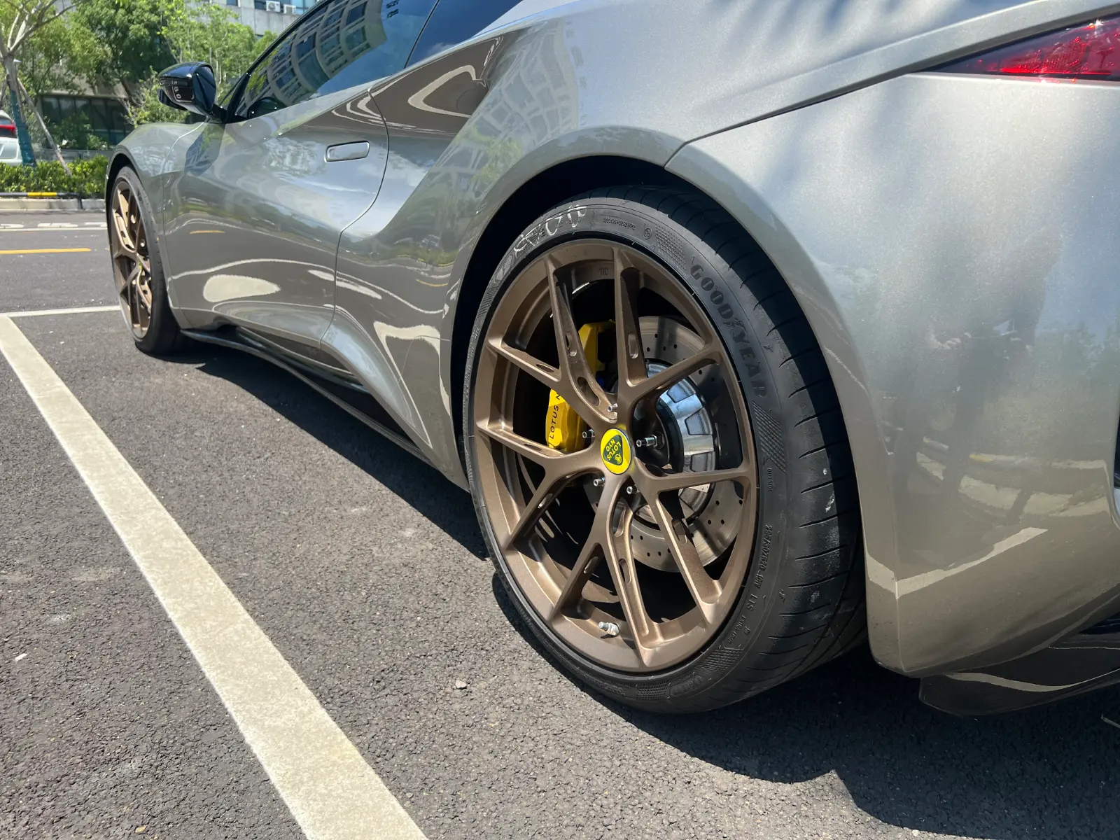

My I4 is running 9*20 ET51 and 11*20 ET57. This pushes the outside of the wheel out by 12mm on the front and 13mm further out on the rear.
Front wheels are same on both I4 and V6, rear I4 are 10.5 wide ET64, rear V6 are ET54
