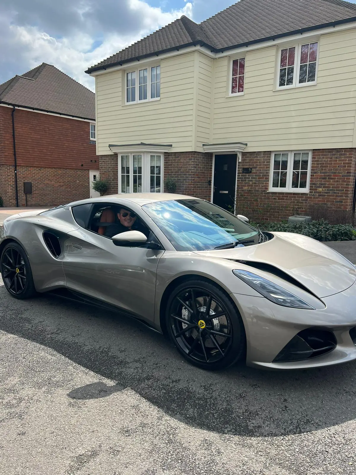

Hey all
I picked up my Emira today and whilst it has a fuel tank of fuel (dealer filled it up and I topped it up £10 when I got home until it clicked) it is only reading about 1/3rd full.
Have done a battery disconnect for 20 mins but no luck.
Dealer now says it has to goto Ashford service centre.
Other than that what a car!!
