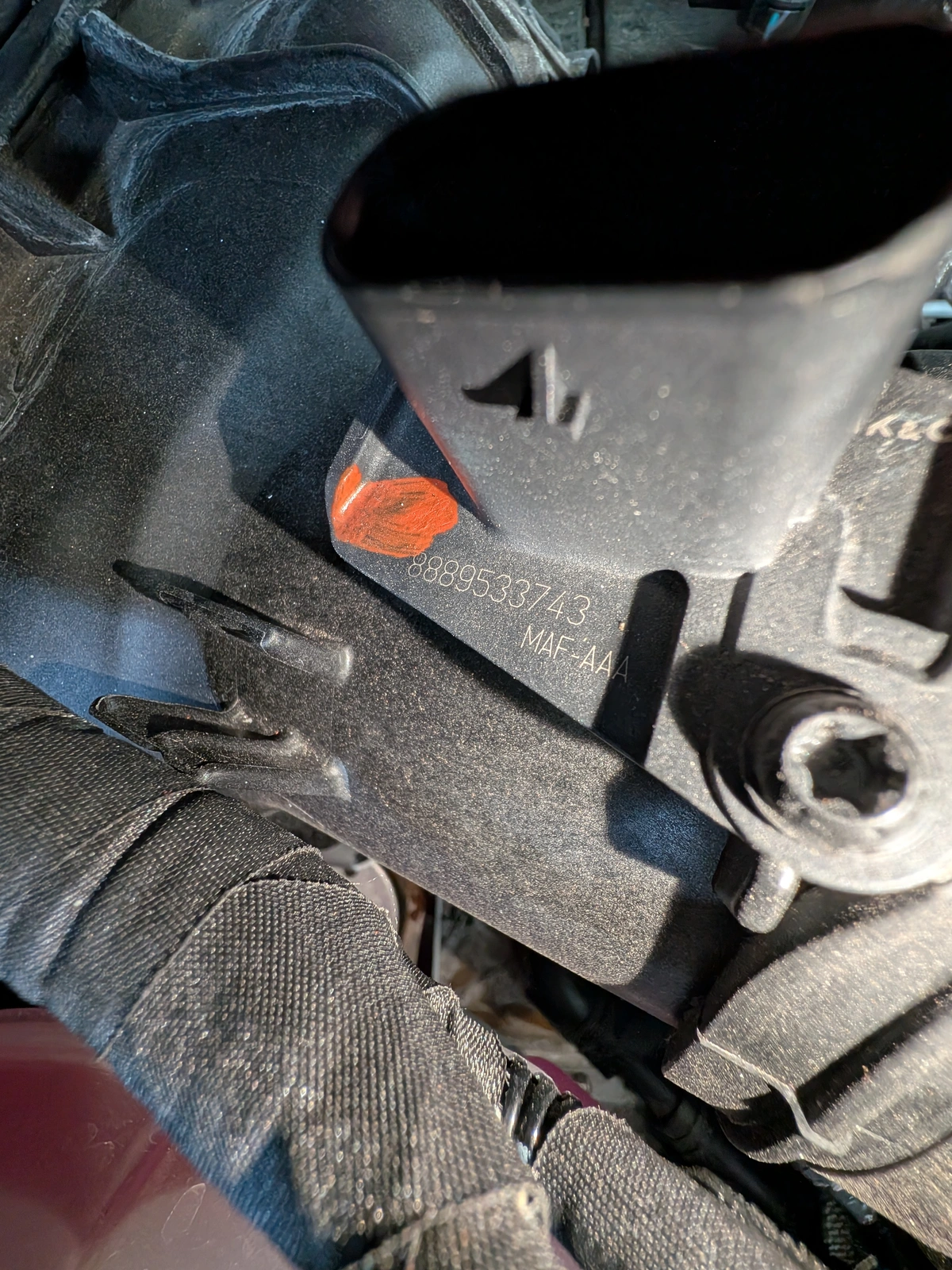

For anyone that sees this, the IAT/MAF sensor is a Lynk & Co 8889533743.

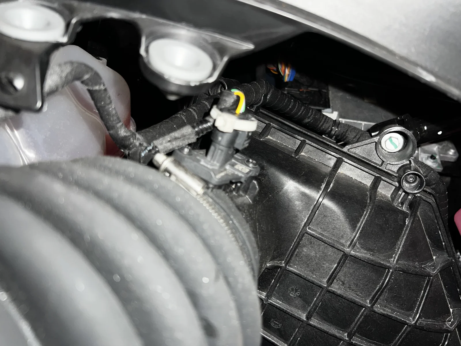

So I got the p0111 error code as well. When I went to find the sensor, I noticed a little white zip tie on it. Is that normal or a sign that the dealer knows this is an issue with the fitment
