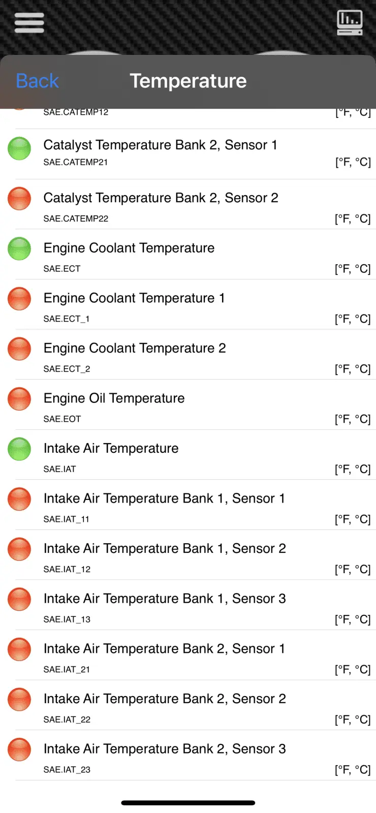

I can’t find this anywhere in the display. Surely Lotus wouldn’t miss this off a driver’s car, would they?
I was just scanning the owners manual and under launch control it says oil temperature is one of the parameters it looks at before allowing a launch. So, I'm convinced it must be hiding in there somewhere...
Auto Gearbox temp maybe.

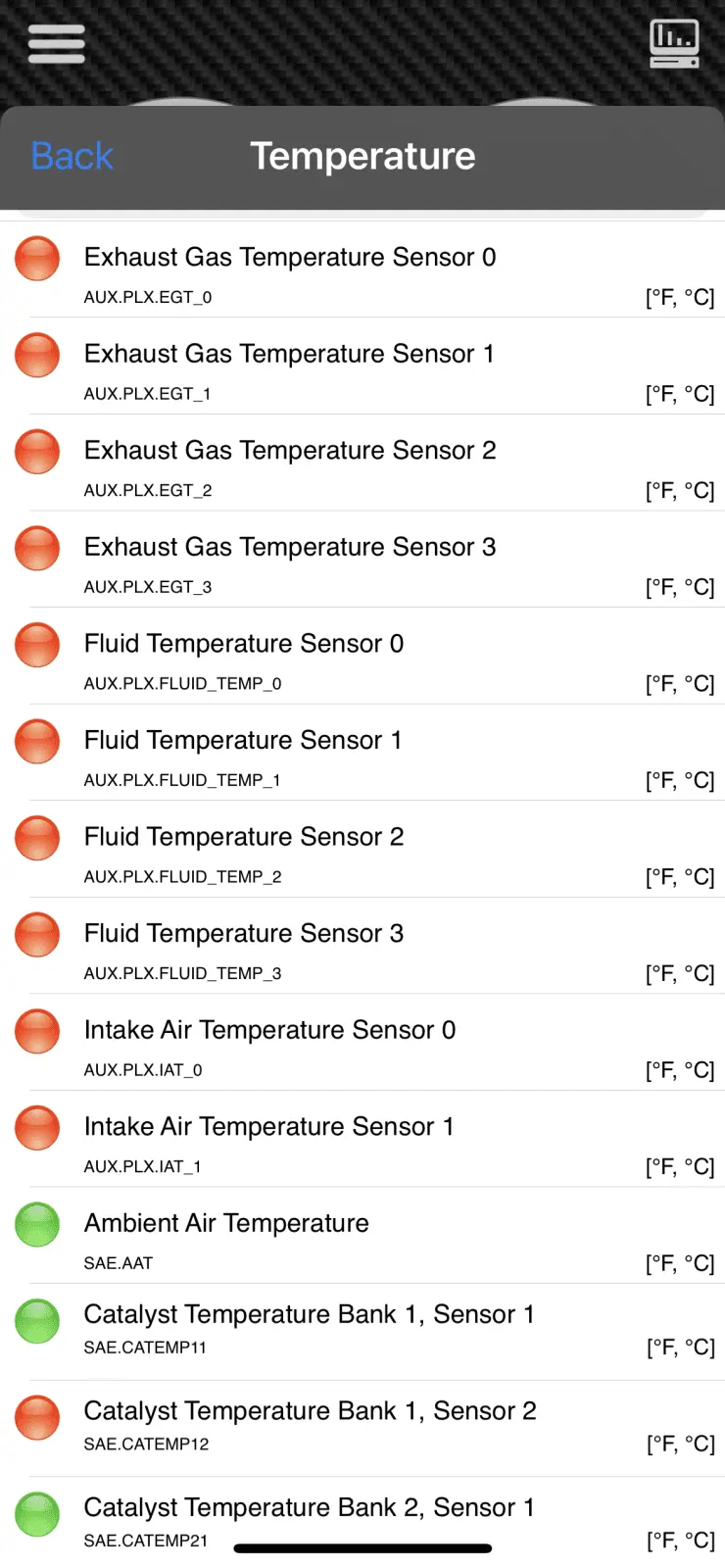

These are the available (green) and not available (red) PIDs my car shows.
View attachment 30863View attachment 30864
It specifically said engine oil temperature. I'm going to guess it'll be one of the unspecified pids and you'd have to look at it while running and see if it "looks" like oil temperature. Then assign that to your app as oil temperature. I'm sure this will give me something to do if it arrives in the middle of winter.

There are extended OBD-II PIDs that are manufacturer-specific and don't appear on a generic scanner. Just because the SAE PID names don't reflect an active data source for what you are looking for, doesn't mean that there isn't one.
For example my BMW has about 10 or 15 custom ones that are visible on a BMW-specific OBD2 app, and the actual BMW factory scantool that dealers use has MANY many more. Even in standard extended OBD2 land, some hybrid cars have 50+ manufacturer-specific extended PIDs related to the hybrid system that don't appear at all on a generic scanner.
Look, I'm not saying that the Emira has secret sensors on the engine. At all. But I am definitely saying that there are lots of things theoretically available through an OBD2 data port that are not listed in the base SAE PID list.
All good theory but, as there definitely wasn’t an engine oil temp/pressure sensor on the Evora, why would Lotus fit one to the Emira and then go to the trouble of hiding it?
I’m working on the assumption that there isn’t one, and I don’t expect to be proven wrong.
