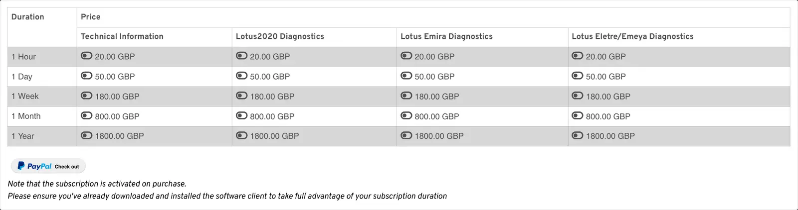

So if you plan to use a tablet in your garage to connect to the J2534 interface device (for OBDII access), you must also use it to purchase the software rental. They current rates are £20/hour, £50/day, £180/week, £800/month, £1800/year - for both diagnostic software AND technical documents. Yes, they nickel and dime their dealers these prices.

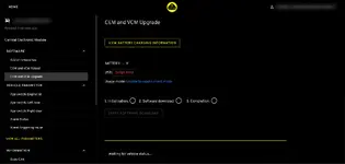

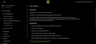

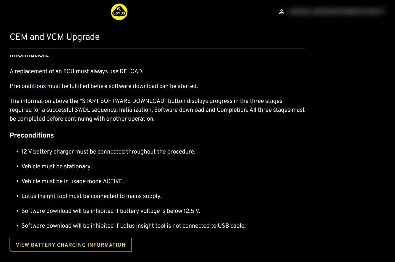

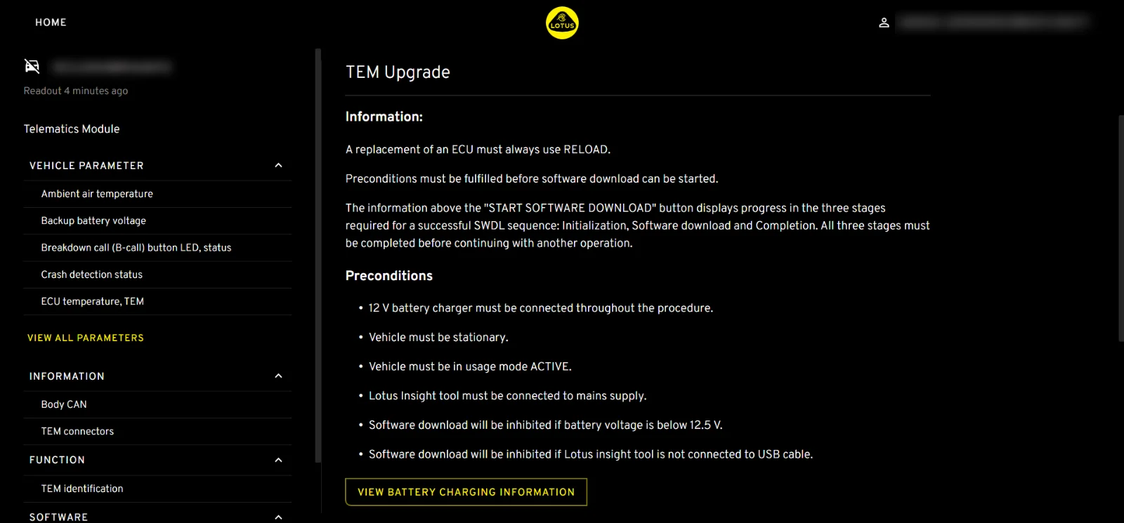

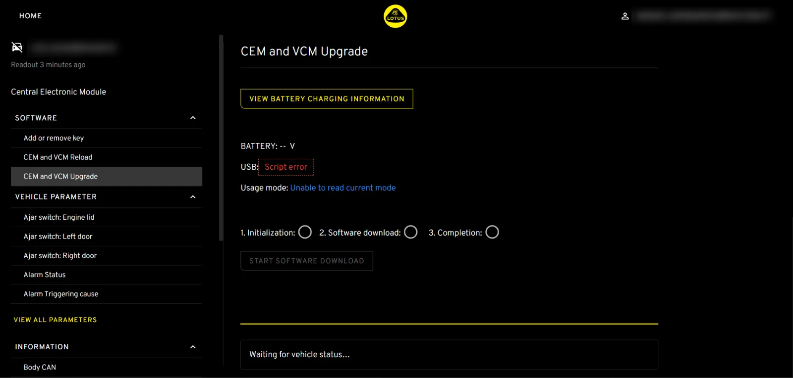

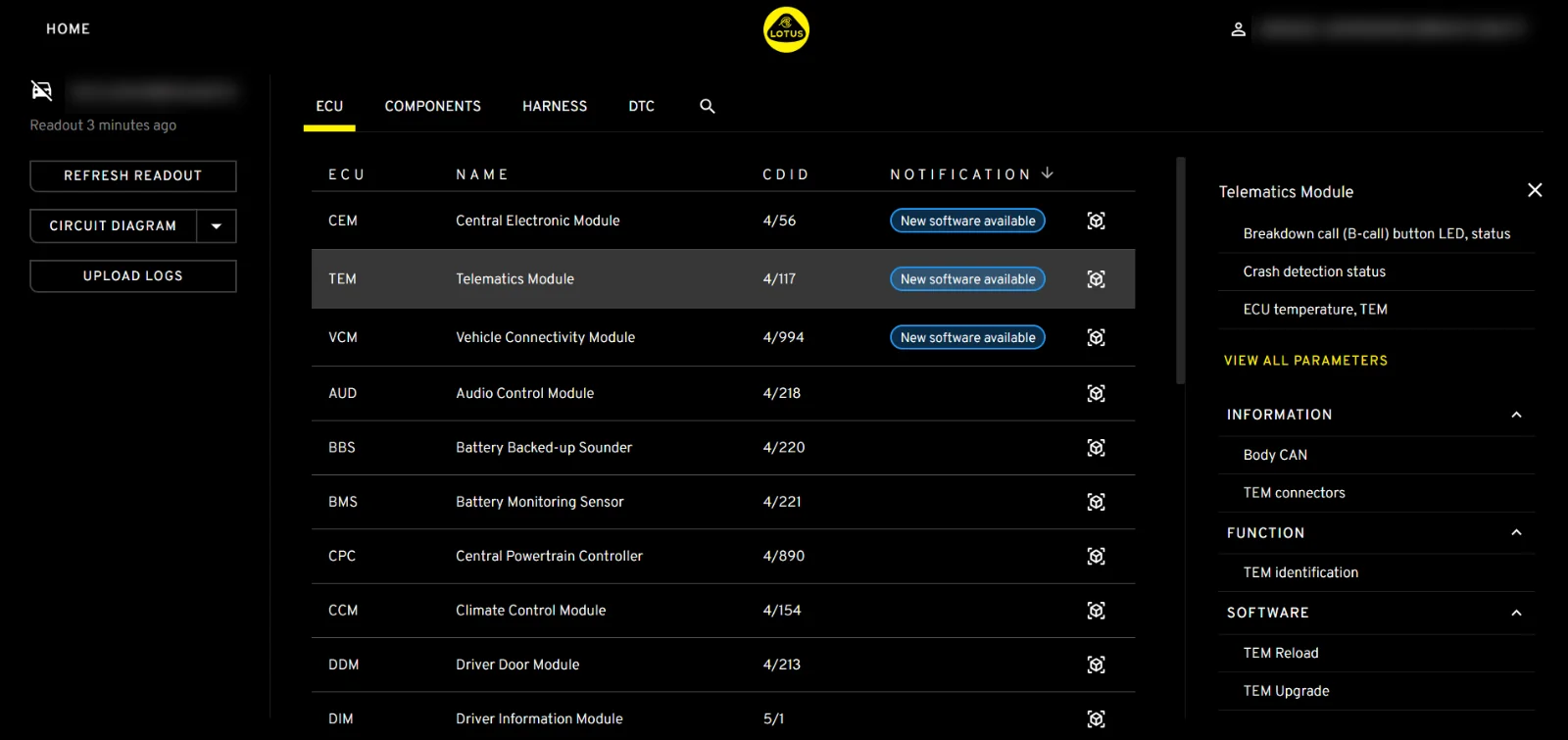

I’ve finally obtained the required credentials and am sharing a few screenshots of the process. That said, none of the passthru interfaces I currently have were able to establish a successful connection, despite being J2534 and meeting the DoIP and CAN FD specifications. I’ve contacted Lotus support to inquire about this issue and am awaiting their response.
From what I understand, the portal appears to retrieve certain module version data via the vehicle’s internet connection, likely to cross-check firmware versions and available updates.
Additionally, I’ve confirmed that the tool allows not only DTC reading, live data monitoring, and basic configuration, but also supports ECU firmware updates across most modules — with the exception of safety-critical units such as airbag control modules.

Unfortunately, the AUTEL interface—despite being fully compliant with DoIP and CAN FD and working flawlessly as a passthru device with BMW and Mercedes—is not recognized by EmiraDS either. It seems that EmiraDS may not support generic J2534 passthru devices and is likely hardcoded to only interface with the Mongoose Plus. :-(
That's really unfortunate and what I was afraid of. Thanks for sharing your experience.
From what I understand, any interface that works successfully with Toyota Techstream (Toyota3) in passthru mode should, in theory, be fully compatible with EmiraDS as well. This suggests that the software might be restricted to recognize only specific device IDs. I am about to order a Mongoose Plus..
