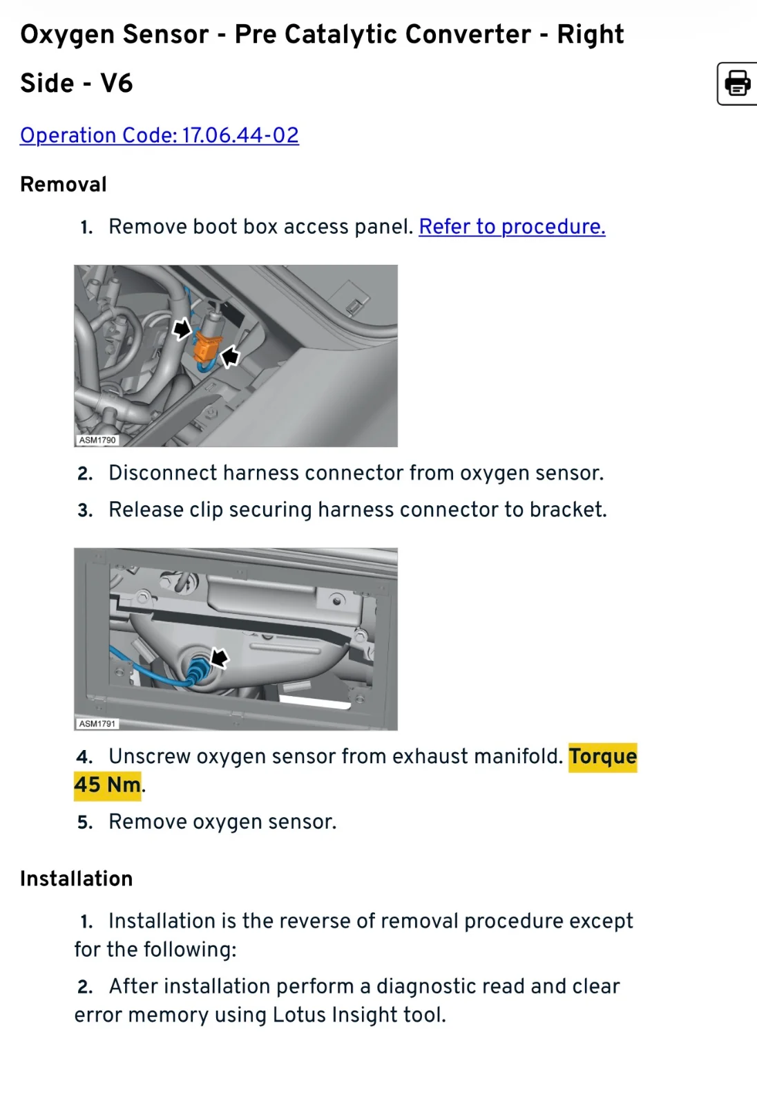

Answering my own questions here incase it helps anyone. Bank 1 is cylinders 1, 3 and 5 and those are on the trunk side of the engine not the cabin side. The o2 sensor is accessible via the bootbox removal access panel.

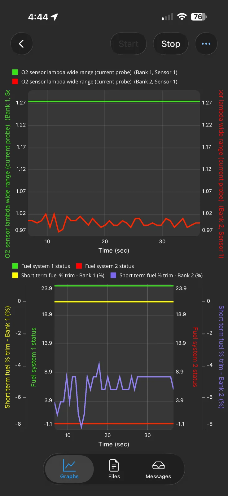

As a follow up to prove to myself it's the sensor and not the wiring or worse ecu, I swapped the bank 1 and bank 2 sensors, sure enough the live data swapped and P223D came up instead of P223C. Ordered a couple primary sensors from Greg which should be better sealed from these terrible OEM sensors.

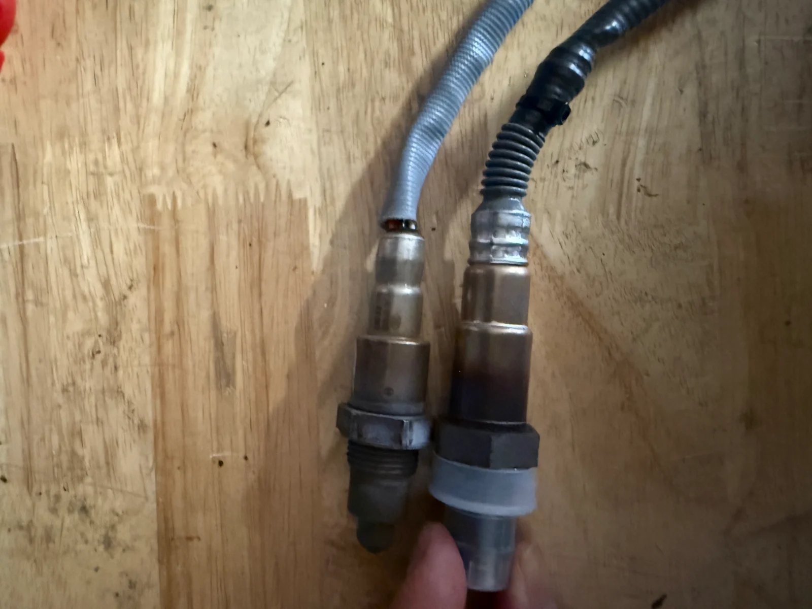

New primary sensors are waterproofed much better than the OEM ones. OEM on left, new ones on the right.

The Bosch primary sensors work perfectly and are of much better quality as pictured above in Kitkats photo.
You can remove the trunk side Bank 1 sensor without removing anything else as long as you don’t have massive arms. Just have to maneuver down between the heat shields and work slightly by feel.
The forward Bank 2 requires removal of a couple bolts on the heat shield that covers it to access it with a wrench. One of those has a nut on the backside so don’t drop it!
