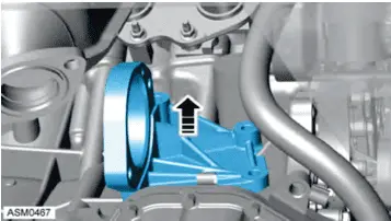

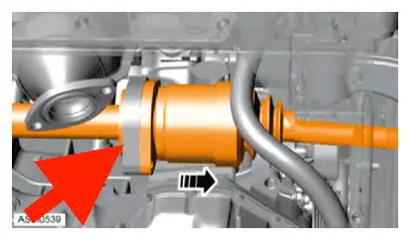

Looks like it's only for the right side driveshaft, it's literally just a bracket that mounts to the engine and holds the halfshaft.

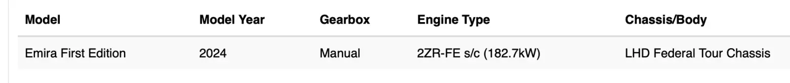

Well this is exciting. Put my VIN in that page you put a link to, and I guess I have an engine change! This has to be the most epic car buying experience I've ever had lol.
