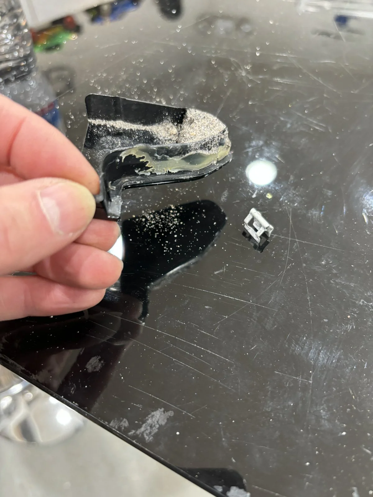

The aero stake end-caps glue was loose - easy came off, will put back on and secure with small screws. Bast to check yours when doing this job.
