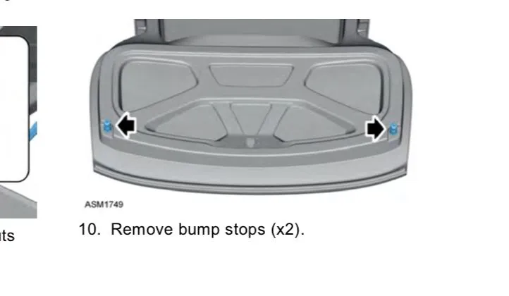

You may find it sorts itself out as the seals compress. On the Evora you could wind the bump stops in and out slightly and adjust them yourself or a 5 min job for the dealer. The Emira bump stops are fitted to the underside of the hatch and I should imagine they work in a similar way. It should be a 5 min job for the dealer.

You can see the bump stops in the image from the service manual. Between them and the seal it will give a certain springiness to closing the hatch. Some have commented that they need to lean on these points to close the hatch properly but either that or the drop from a bit of a height works fine for closing it. The springiness shows the seal is pushing up against the lid and making the seal watertight, also supported by the bump stops.
The OPs issue was occasionally seen in Evora circles when the cars were quite new. It’s a balance to get the back pressure right with a new car but as seen here, if it’s a little too much it can “grab” the striker and stop the lock mechanism from releasing. Once you know what’s going on it becomes a non issue.

Twist the bump stops 90 degrees to unlock, then you can push/pull them in or out then twist back to lock in position.
