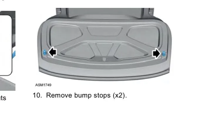

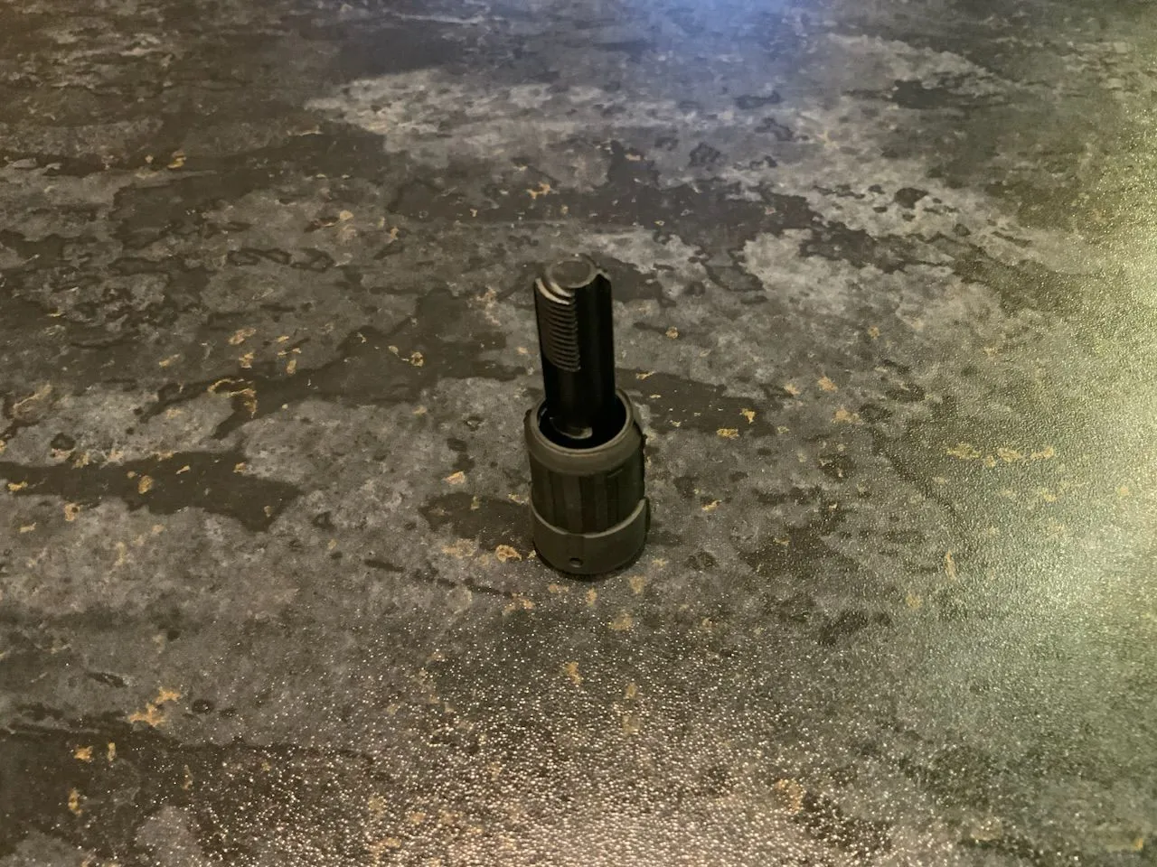

Twist the bump stops 90 degrees to unlock, then you can push/pull them in or out then twist back to lock in position.
Do they not thread in and out? You're saying they just have a lock position, with multiple grooves for different heights?
You can see the bump stops in the image from the service manual. Between them and the seal it will give a certain springiness to closing the hatch. Some have commented that they need to lean on these points to close the hatch properly but either that or the drop from a bit of a height works fine for closing it. The springiness shows the seal is pushing up against the lid and making the seal watertight, also supported by the bump stops.
The OPs issue was occasionally seen in Evora circles when the cars were quite new. It’s a balance to get the back pressure right with a new car but as seen here, if it’s a little too much it can “grab” the striker and stop the lock mechanism from releasing. Once you know what’s going on it becomes a non issue.
Adding a small bit of lithium grease to the inner surface of the latch and the underside of the striker also helps. I mean small, like a dollop the size of a grain of rice. Just enough to reduce the stiction.
Yes, exactly that.

Adjust the bump stops on the boot. Basically on mine, one bump stop on right side is longer than the left 🤔 from factory. The bump stops are used to align the shut panels in the boot correctly and also the ability to close with a slight drop from 10cm. It’s got to be just right. I’ve adjusted mine slightly as previously my boot was always open.

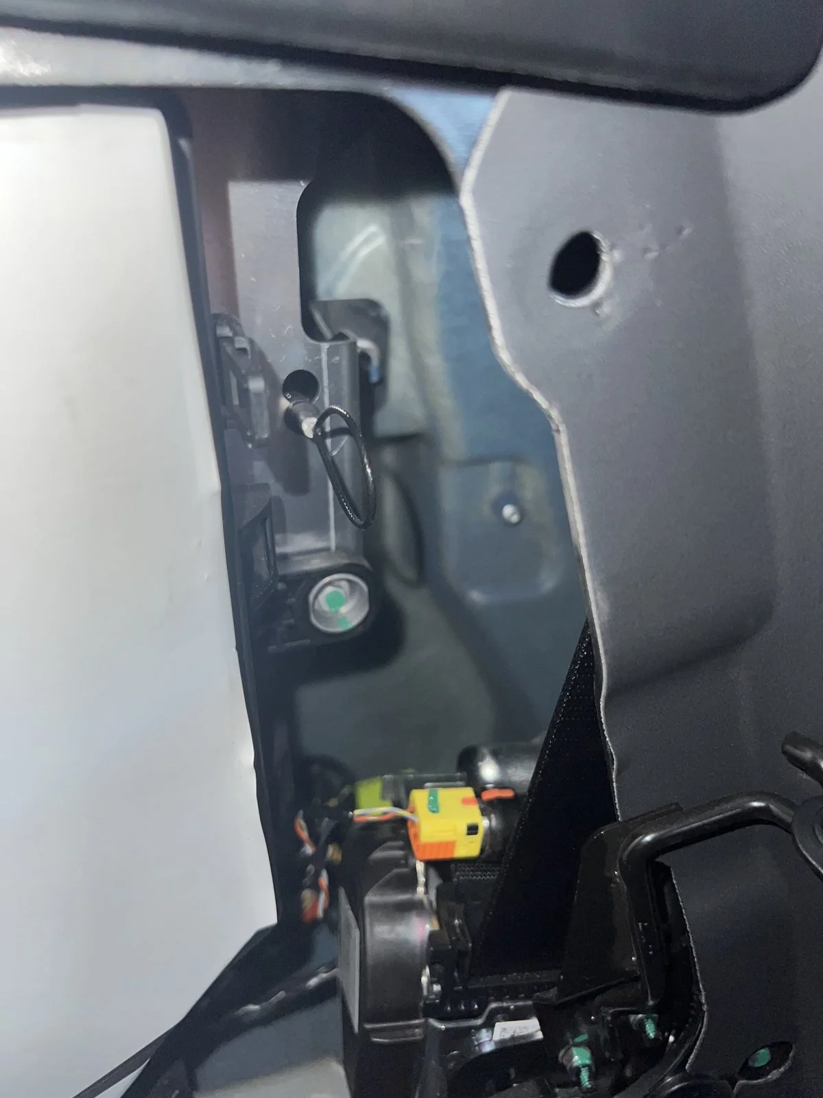

If you do need to get to the emergency release cable, it’s worth using a torch to look in there and make sure you locate the loop in the picture. It’s relatively high up in the cavity once you remove the cover panel and below it are a bunch of electrical cables. It’s conceivable to grab the wrong thing and pull. Which would not be good.
Agree. At the factory handover Scott said exactly that. There are wires in there as well as the release.
Note also that on the demo car it was a black plastic pull cord (looked a bit like a cable tie) not red per the diagram in the manual.
