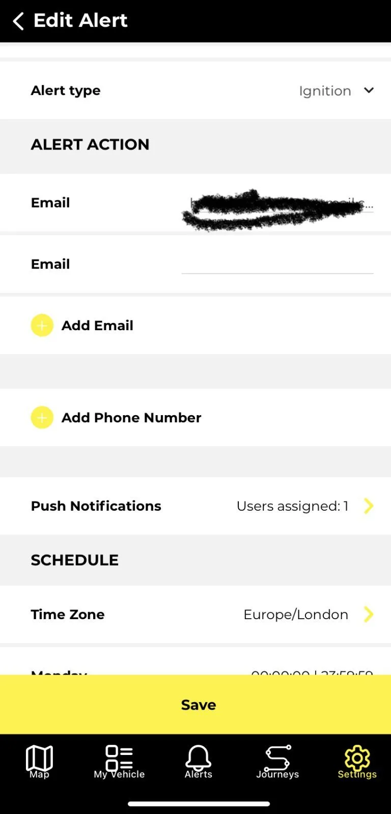

I've taken a screenshot from the app with the settings (confirmed as correct with Scorpion support). Note the "phone number" section isn't for push messages, it is for SMS messages which are a paid for optional extra.

OK thanks. If you have both the email alert and the push notification enabled, I am assuming you do receive the email but not the push? This is the behaviour I also get.
I have settings as you suggest and get emails but no Push Notifications, I will call CC next week.

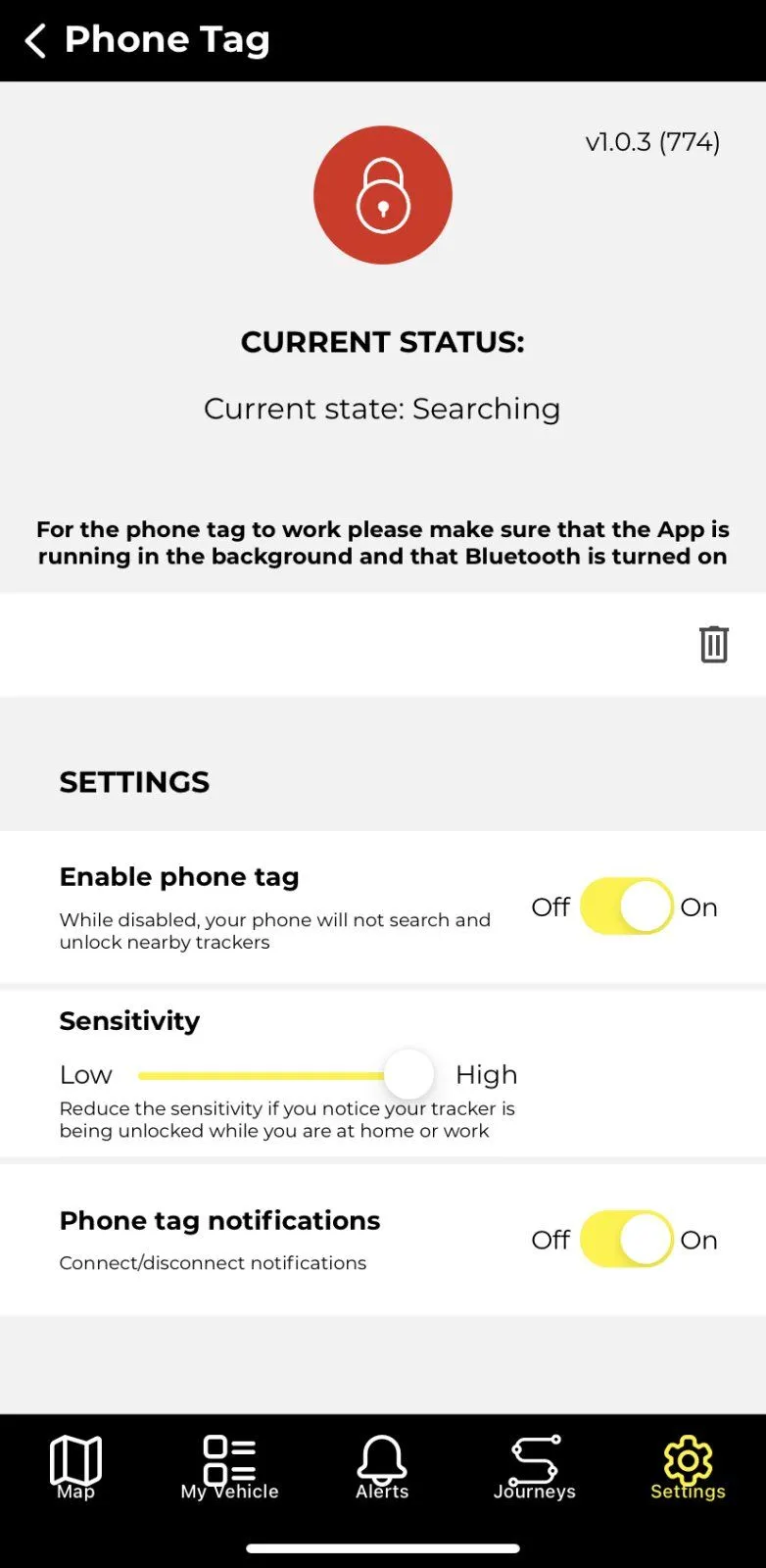

Does Phone Tag work for anyone?
Mine just says “searching” all the time. I tested it anyway but I received the call from Scorpion checking that I still had my car so it obviously wasn’t working.

I can confirm I also just get the current state "Searching" on the App even when sitting in the car with my phone
This happens with or without a physical key fob in my presence, ie it doesn't change to Green even if the tracker is unlocked by a fob, which might be normal behaviour.
The instruction manual "Lotus-user-guide-en-FEB-2022.pdf" has no reference to the Phone Tag feature unfortunately.

I didn't actually get around to testing by going for a drive with just the fob and then just the phone which would show conclusively if the phone was working.
I will try this later as I have a couple of runs to do and will feed back.

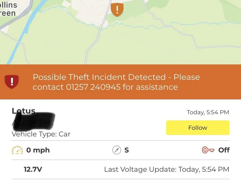

As I anticipated, driving without the fob and just the phone resulted in a phone call from Scorpion with a suspected theft alert. The phone tag therefore doesn’t work for me.
I’ve not bothered testing the fob alone as I now know that must work as all my other journeys are with phone & key fob.
It’s clear there are differences in outcomes between what scorpion expect to happen (and does happen with their own app) but for the small sample pool we have, it doesn’t do what it’s supposed to with the Lotus skin / customisations.
No push notifications, no phone tag. I’m of the opinion this doesn’t work for anyone as I’m yet to hear a conclusive yes to either for those who use the Lotus app (not the Scorpion app which you can’t use as it recognises your email address and repoints you to Lotus).
