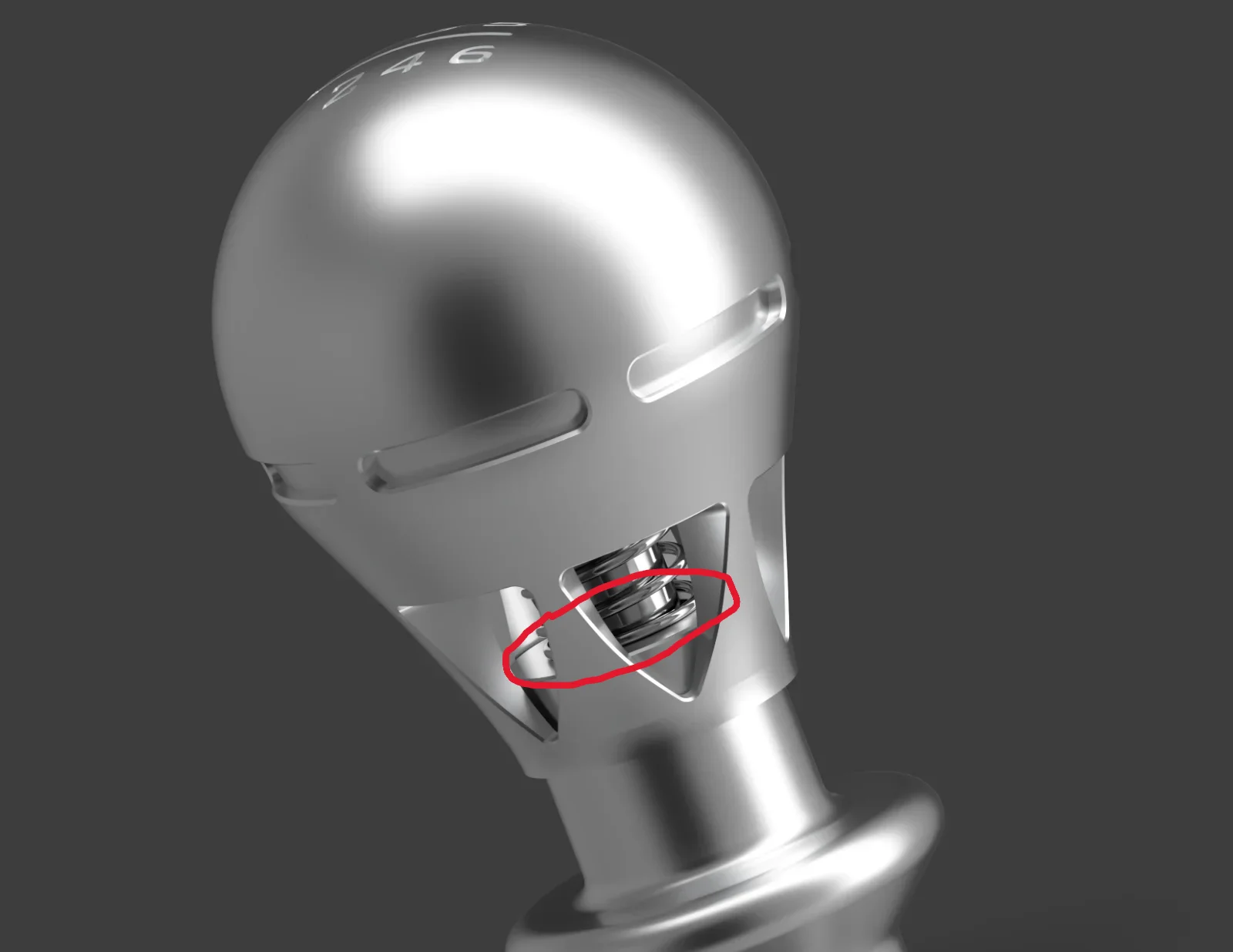

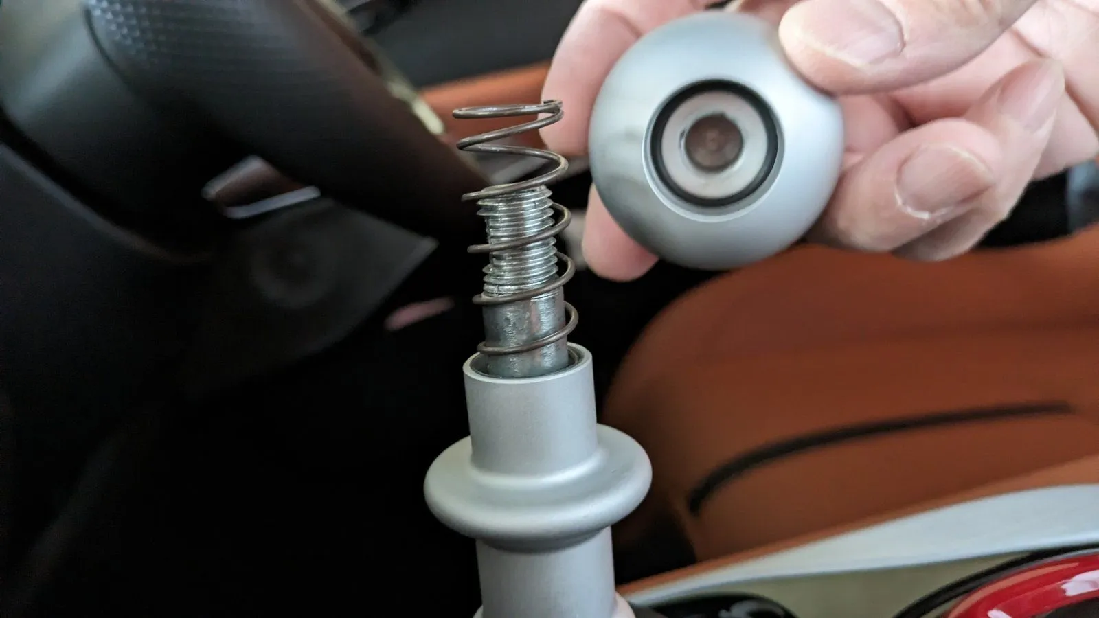

Darkwork Design was talking about getting some plated springs. Which interface is scratched?
The surface that the spring touches. I think this was scratched when I removed the knob and the spring rotated with it.
Nickel plating will resist scratches.
That one is rendered with a replacement reverse lockout collar, the actual one is slightly different, a bit of polish and a new spring would make it look fine. The spring goes into the oem reverse lockout.
I modeled a reverse lockout replacement because the oem one has superfluous ridges that don’t matter anymore when you remove the boot. It would be optional.

Does it weight more or less than your other designs?
I would love just a big, heavy, stock looking knob.. (insert pron music).
Nah this one is 145g, Type F is 205g, stock is 115g, and Suntory’s big round boy is 165g.
The cutout design obviously is going to shed weight. I can maybe optimize and add about 10g more by removing some internal threading but that’s the limit.
Yes, comes down to material density. Also cant match al6060 with ss304 …
