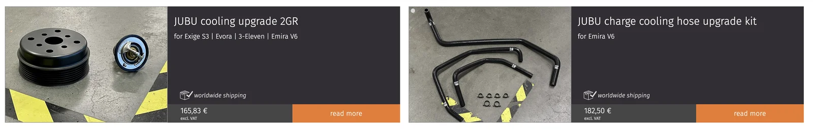

the cooling kit you are referring to is the hoses to reroute flow, water pump pulley and a new thermostat?
Edit, these?
Edit, these?
Yes I did both. The manual says to drop the motor for the new thermostat.
For the hose make sure the they triple check the clamps! 1 of mine came off 15 min from the shop and I had to get towed back. Like I said was an experience with that shop. They took care of the tow bill and all and apologized but this isn’t rocket science. But sharing so you can ensure it doesn’t happen to you.
I’m sure I can get a group buy of cooling kit going if we have enough people. I think everyone should do it really, low cost. Install wise is where the cost got me on this.
I’ll try and start a thread for this to see who is interested. I know lots of guys on the JB4. would like more cooling
Nice, thanks! So what is Jubu's recommended way of getting to the front of the engine to install the pulley and thermostat? Removing rear quarter panel?
