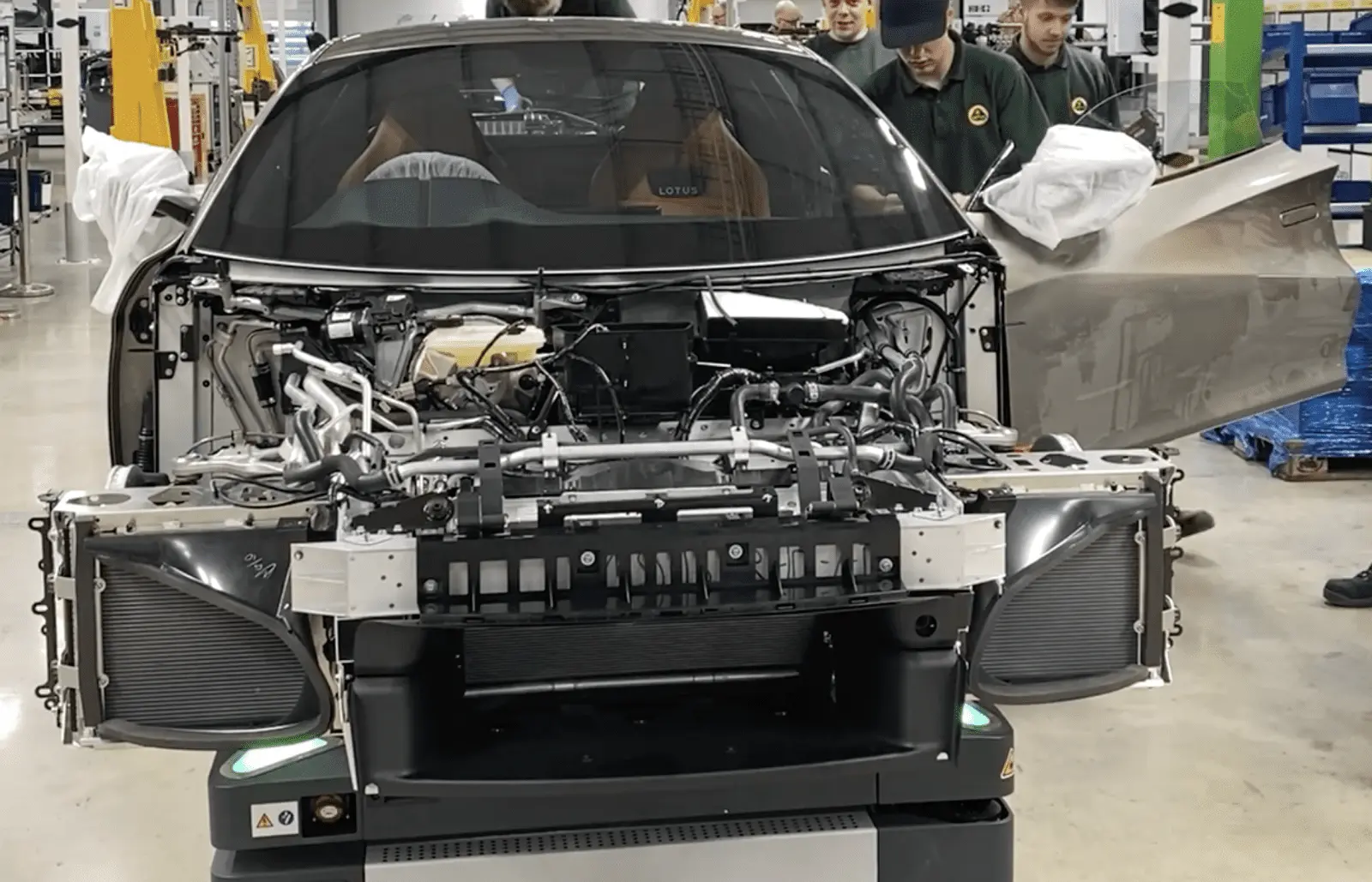

I think it has to do with the vented hood design they went with. The hood is concave and splits the hot air from the angled radiator into the two side vents. Looking at the picture there is just isn't any space left at all.
And using a double wishbone suspension setup takes up a lot of inboard space.
