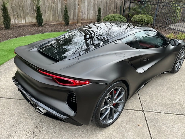

I'd go for clubsports if I was tracking over Fast Road. I could see Fast Road still being too soft for some on the road.
The car above has Fast Road on a Sport suspension and it feels about right for me on the street. I have a dedicated track car w/Ohlins and was not looking for anything that firm on the Lotus.
To each his own but I think Nitron did a fair job with the Fast Road.
