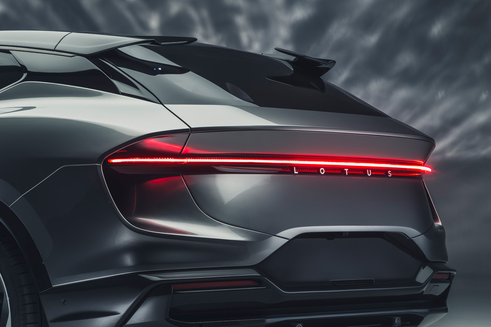

Matt Windle has recently expressed interest in moving from composite body panels to pressed metals, likely for cost and higher throughput reasons. Hopefully this doesn't compromise future styling, since the composites can have much more complex shapes and sharper angles.
I believe the Eletre uses metal body panels, so we could look to that to see how they will use metal panels on lifestyle vehicles and potential future sports cars. Almost all the body seems to follow likely constraints around metal panels: not sharp or complex shapes on the body, and there's plastic/carbon where there are vents or intricate shapes (front bumper). However, the rear fender lower panel (right below the edge of the brake light) sticks out as the only panel that seems to be metal but is super complex, so I'm wondering how they managed to achieve that.
