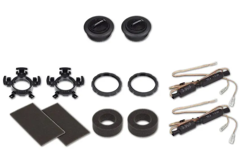

After the right side, the tweeter just wasn't enough. I was bummed. When I did the second side, I forgot to put in the filter that shipped with the tweeters. Then it was - oh wow! So I pulled the filter out of the first side and now both sides have a super nice high end. To me, it pulls the sound way up into the windshield, almost like surround in your house. I can hear the guitar more like it's supposed to be too.

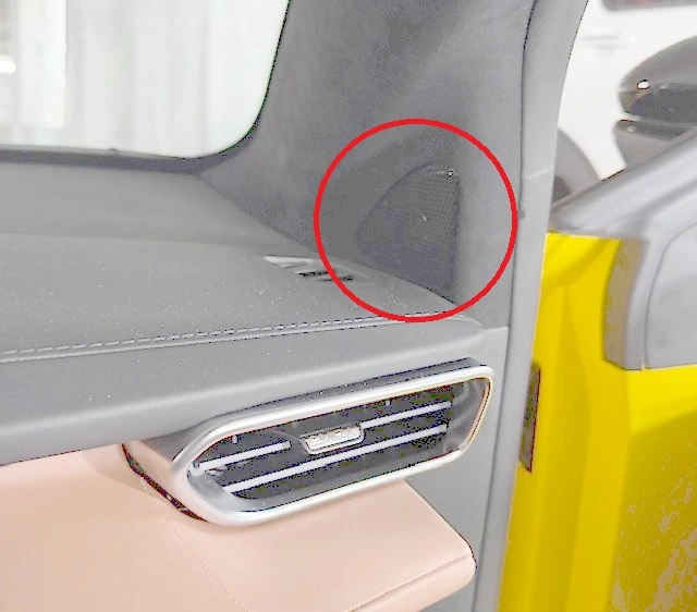

I was going to ask similar: Where did you put them?

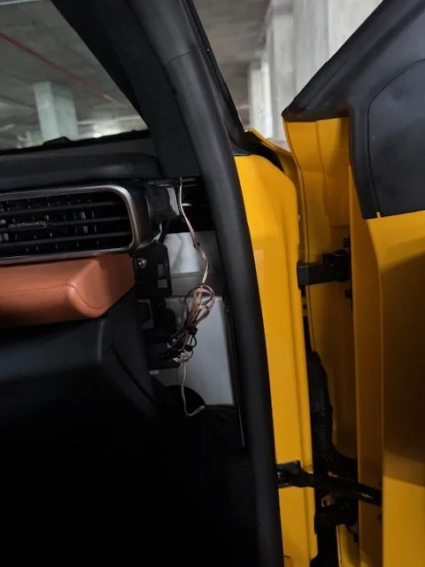

Here you go.

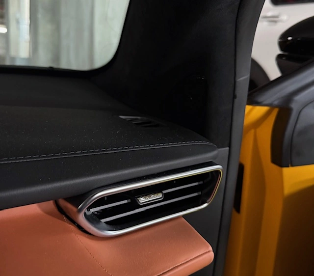

The car has a spot for the tweeters. Lotus just didn't use any. They said there is a tweeter in the 3 inch driver. True, but this is way better up in the high dash area. That picture is a bit dark. I just slipped it in from the bottom and put some foam in there to hold it in place.

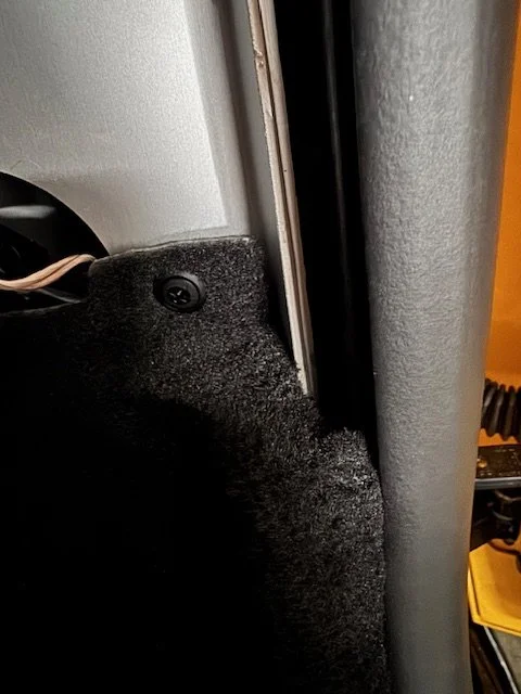

If you pull the screw out, you can get more access to the bundle of wires. The tricky thing was to cut open the protective outer layer without cutting my finger or cutting through the whole bunch of wires. I just cut a bit at a time.

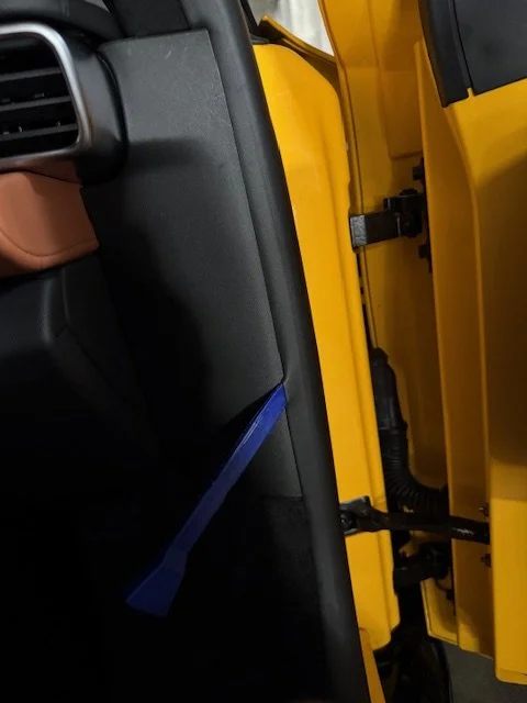

Then the plastic tool to slip the rubber piece back over the plastic piece. The plastic piece literally pops out without tools.
So you put the tweeters behind the grilles in the a-pillar, right?
There's another thread that also discusses this.
Yes. They barely fit through the opening. They are reasonable snug with foam push in behind. No glue.
I saw that one. That is a LOT more work. New wires to every speaker would be tough. Everything he does is better. But more expensive and more work.
So you didn't remove the a-pillar trim, you just maneuvered the tweeters up into position?
Yes. Much easier. I couldn't figure out how to pry the grills off.

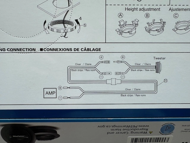

I think the crossover filters that come with the speakers are there to filter out low frequencies to protect the tweeters. But I guess they could also reduce the gain. Still surprised it sounds better without them.
That’s exactly what the crossover is intended to do. If you remove them, the tweeters will see the full dynamic range of the head unit output (unless the head unit has a separate, filtered output, just for tweeters). I can’t see how removing the filter will not end up with the tweeters blowing up.
I found some pictures of the "crossover", as shown below. It's a 3.9uF capacitor and a 1 ohm resistor in line with the tweeter. Rough calculations puts the -3dB point at about 6kHz, plus the 1 ohm resistor reduces the output of the tweeter by about 1.5dB. This in total possibly would explain why removing it makes the tweeter sound a lot more prominent. Another consideration is which set of wires is being tapped from the front speakers - there are two sets of wires, one for the tweeter and one for the midrange. If the tweeter wires are being tapped, it *may be* okay to run the Alpines without the "crossover" network because the signal to the KEF tweeter is already high-passed, likely somewhere between 2kHz to 2.5kHz. If the midrange wires are being tapped, I would correct this by tapping the tweeter wires instead.
I agree in theory. But in practice, they really sound right without them. That's why I mentioned it. It was a fail connecting the right way. No where near blowing up.
The difference is a lot more than 1.5dB.
I tapped the mids, not the tweeter feed.
No need to "correct". It sounds right this way.
My buddy listened. He said it sounds way better than his old C5 with an external amp and subwoofer.
I do need an audiophile to check me on this.
The 1.5dB drop is just from the resistor. There's a lot more drop caused by the 3.9uF capacitor. If the -3dB point is at 6000Hz, that means at 3000Hz, there is about a -6dB drop, and a -12dB drop by 1500Hz. Frankly, I'm not really sure why there is a 1 Ohm resistor at all. It's possible that it's there to protect amplifiers from experiencing a short circuit if the tweeter voice coil burns out.
But none of this matters if you connected the tweeter up to the midrange amplifier feed. If this is indeed what you did, you may be feeding the tweeter band-passed midrange signal that's intended for the midrange driver. I would guess this to be 400-2500Hz, but I don't know for sure. If this is what you did, it would explain why the tweeter's crossover network made such a big difference, because that network would have filtered out most of the midrange sounds from the amplifier.
What you are saying seems basically right. I didn't check the math. I doubt the mid range is band passed though. They usually go full range, then filter for the tweeters.
Aside from the math, this is the way to go on these. I compared to another Emira today. Another forum member. It was frustrating my phone wouldn't link to his car. So it wasn't pure apples to apples. But we found a couple songs that were the same. It is a noticeable improvement. I was concerned he’d say it was way too much treble, which would mean my ears are just too worn out. But no, this setup is solid.
I’m also a guitar player. The stuff we do with amps is just try stuff. If one amp has a 8ohm and a 16ohm output, and another has a 4ohm and a 8ohm output, they both work with the same speakers. A big 4x12 guitar cabinet is usually 2 speakers in series, then in parallel with the other two. But some guys go stereo and run two at a time. Then you can go parallel with two 4x12 cabinets, so 8 speakers Just a huge range. So all this stuff is somewhat forgiving.
