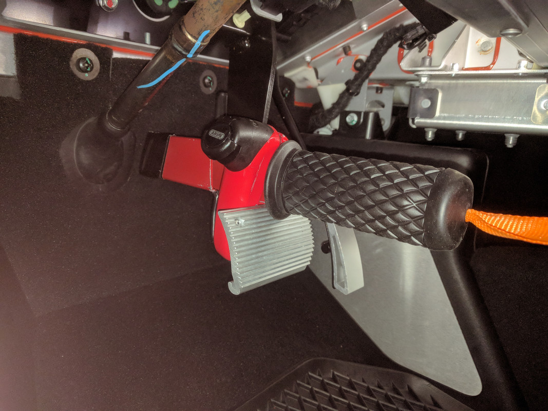

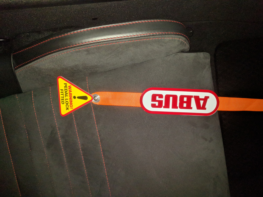

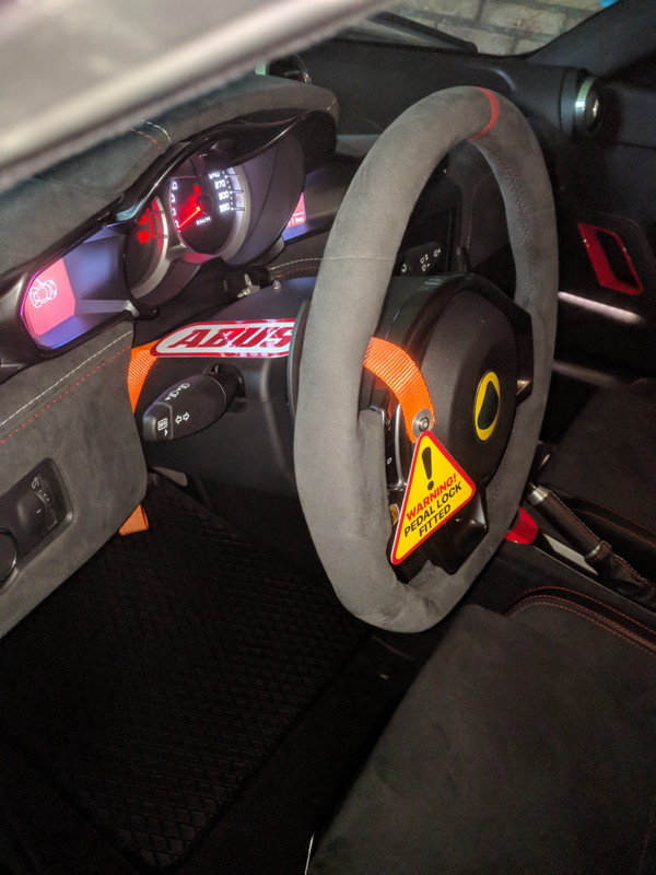

The Evora GT 410 Sport is in my garage........I bought a 1st class (Autobild tested) wheel clamp for some extra safety (for what it's worth).
Furthermore, I have constructed a "pedal lock" myself for fixing the pedal of the automatic transmission......e.e.a. "locked" with an ABUS disc brake lock, which can be slid just over the (both lying against each other) pedal lock bar and automatic/brake pedal arm.
The whole is very robust; can of course always be cut with a power cutter, but the space on site is very limited...I'm very pleased with it.
I can make good use of this theft device if I, for example, abroad / e.g. Germany am at the hotel for the night.
