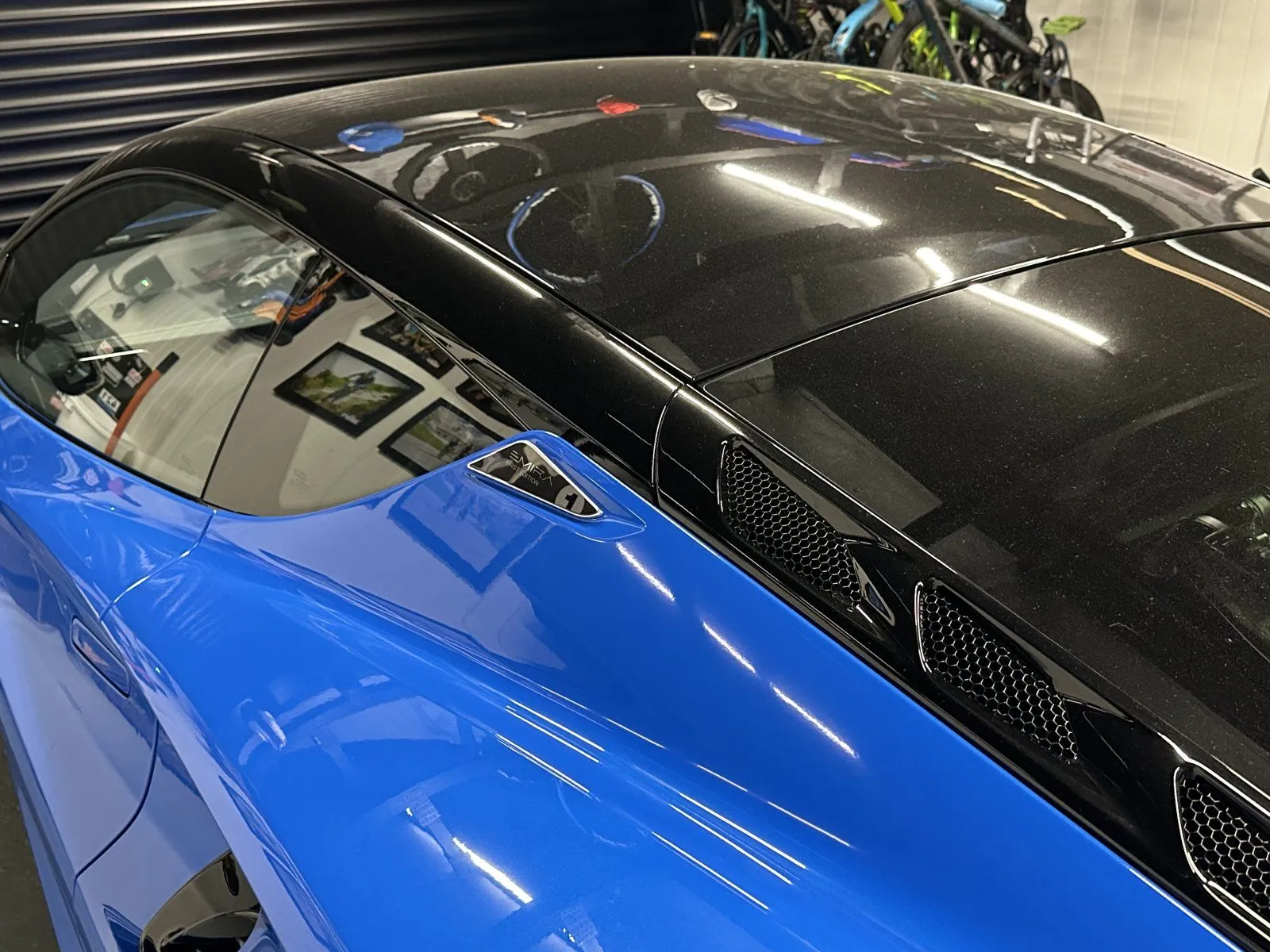

Jon Fuller on here had his clear rear window swapped for privacy version. It’s in his dark verdant thread, blog
I did it myself. No big deal.
Not sure about the rear 3/4 side windows though, I think you need to remove the rear wings (fenders) to change those.
Tailgate glass is bonded in with PU (Sikkaflex), you cut it out with cheeswire. Only tricky bit is around the heated screen electrical connections.
I made a couple of small spacers to set the thickness of the PU at the front of the glass where it meets the roof panel, as this dictates how well the glass aligns with the roof. I just measured the gap/thickness each side before removing the old glass and cut two small wooden spacers from dowel (1/4" diameter) and sat them in position when bonding the new glass in place.
I removed the whole tailgate to do it, so I had better access for cutting the old one out and cleaning up.
Refitted the frame to the car, lined it up and bonded the new glass in, in-situ.
