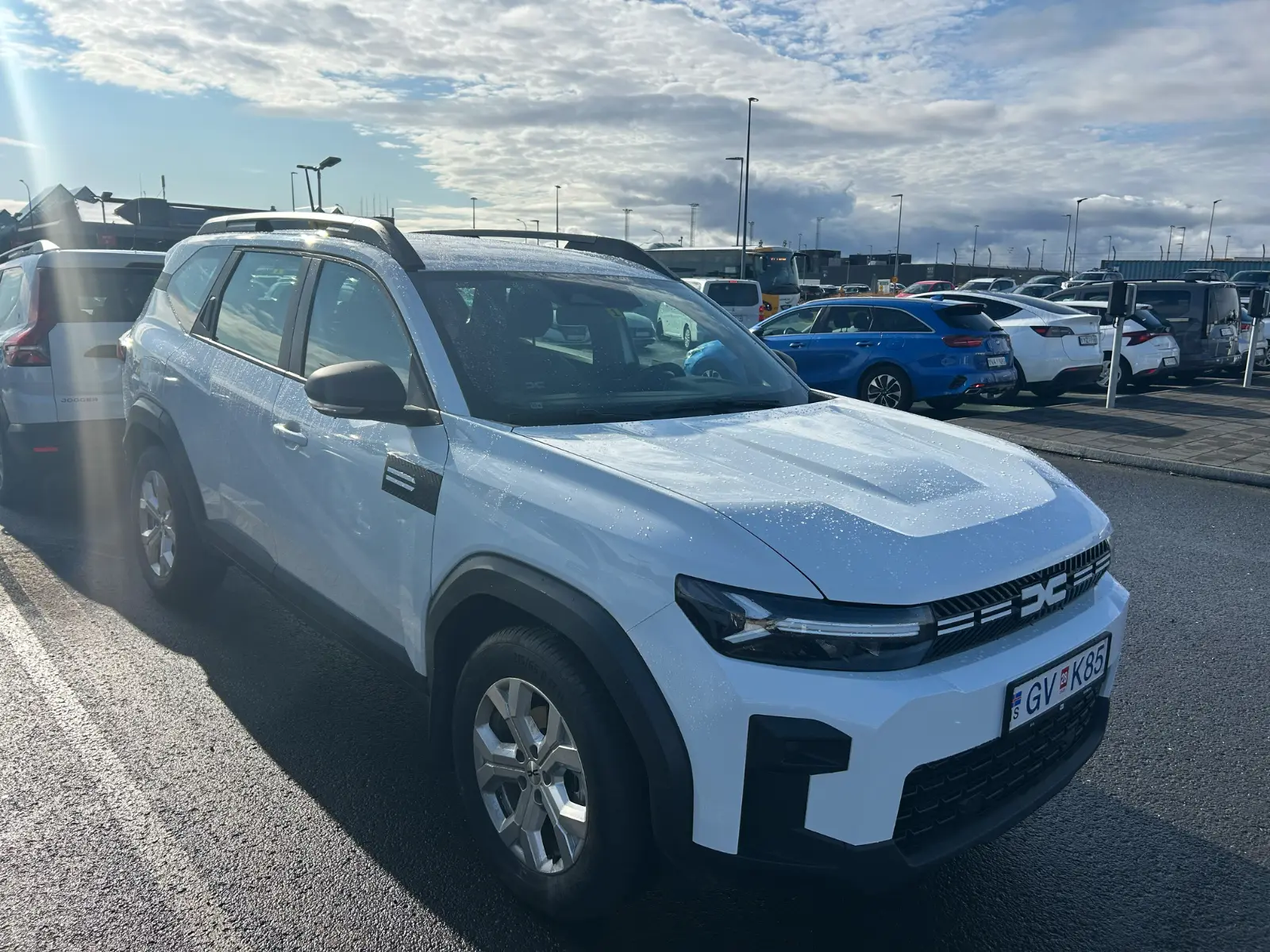

It is all perspective, after driving a Renault Bigster in Iceland for the last week, the OEM shifter on the Emira seems extremely short and accurate. That said I was not driving the Bigster fast, but I am pretty sure I couldn't even if I tried. I rarely miss a shift with the Emira OEM shifter, not so with the Bigster, I am guessing 1 out of 10 was a miss shift - it was a horrible manual.
