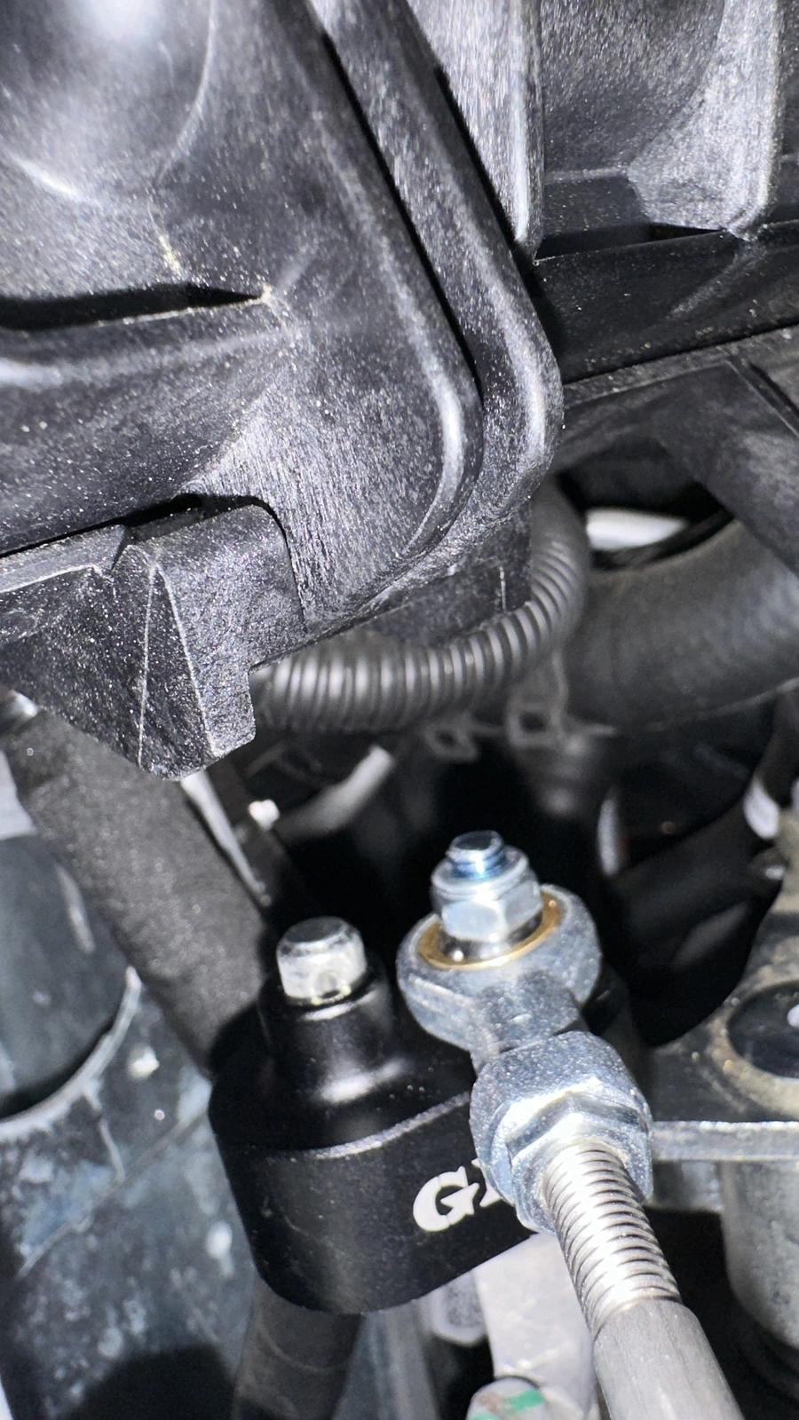

I would just make a mental note of how many turns it takes from initial engagement to fully inserted and maybe not back off more than 40% of the turns so that there is plenty of thread remaining engaged.
Thanks for the advice. Knowing how much thread is left should lighten mental stress contributing to the shifter stalk ED 😆
You are asking for trouble. The stud that the GRP eyelet mounts to is fixed in place by the same nut that holds down the eyelet. So if you remove the eyelet, that stud may fall out?
I did consider that, but think the stud will be trapped in place if the nut is removed after the unit is pushed on to the bell crank. However, since it is cold ;) the chances of nut fumbling and nut loss increase. I dunno, guess it will depend on the weather and how I'm feeling that day. I'll figure it out. As you have pointed out, the important thing is to make sure your stalk stands proud before reinstalling the cotter pin.

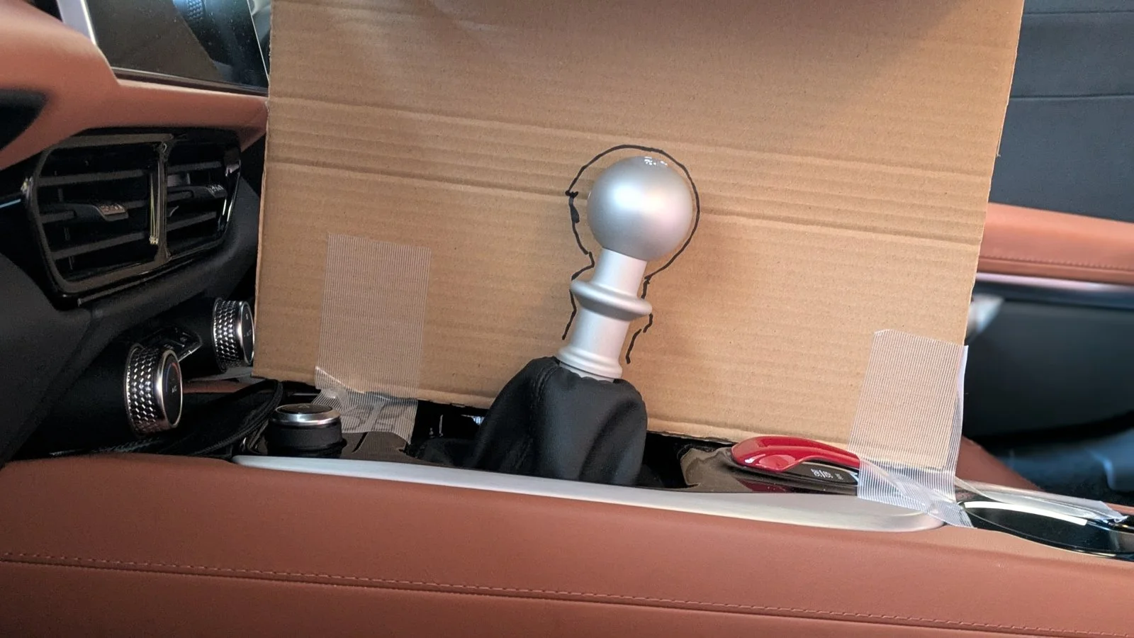

As mentioned above, I do the same and adjust it visually by looking through the rear window at the shifter and then verify by sitting in the car and giving it a little test before locking everything down.
Having the shifter in the 100% exact position isn't critical but you want it as close as possible.

You are asking for trouble. The stud that the GRP eyelet mounts to is fixed in place by the same nut that holds down the eyelet. So if you remove the eyelet, that stud may fall out? It's easy enough to kind of put the short shift adapter in place without installing the cotter pin, and take it off to unscrew it a few turns to adjust. I would just make a mental note of how many turns it takes from initial engagement to fully inserted and maybe not back off more than 40% of the turns so that there is plenty of thread remaining engaged.
Another adjustment point would be the shifter stalk attachment. You can maybe back off a few turns there. These few millimeters will add up and hopefully get to the right length to cure the shifter stalk ED.

Thanks to this post I revised my install to return the shifter to neutral. I ended up having to back off screwing the eyelet in ALOT.
At first install I tried to screw the eyelet in all the way to match the OEM green markings. Then I noticed that the shifter was indeed rear biased.
I took the short shifter unit off completely and ended up only screwing it in 5 turns before locking it with the nut. A very different length and now my gear level is in the middle of the gearbox. Still a bit shifted to the right but I think that’s for another reason. North south at least it is centered. And I find that the shifting feel is ever so slightly improved. Enjoying the shirt shifter even more now. Thanks for highlighting this!

When installing I prefer to leave the assembly together as we ship it and spin it onto the cable so there is no risk of dropping the bolt out of the short shifter body etc.
Thread it onto the cable, place it onto the bellcrank and check the shifter positioning -- remove and loosen or tighten further on the shift cable as needed before final install with the circlip.

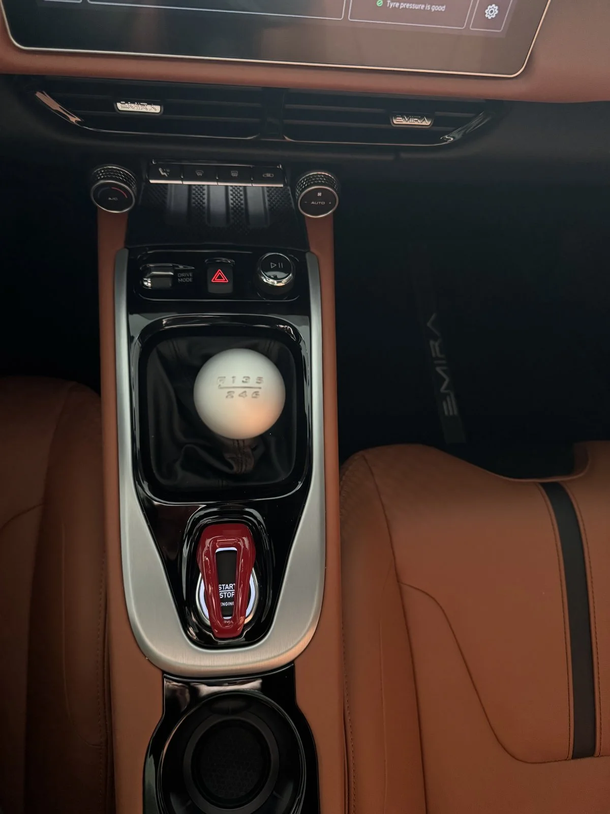

The only thing I had was that the shifter N sits to the right more the OEM. Which I believe is normal right? I attached a picture of how mine sits. If we can adjust this I might do so, if not it’s no big deal.

that looks right to me. You also have it centered N/S which is good. I think the slight to the right neutral setting can't be resolved by the SS connection. Someone else had mentioned another cable that could be adjusted closer to the gearshift itself, that could center it E/W. I haven't seen anyone do it yet. I agree that the action is closer to 1 movement and improved over stock.
