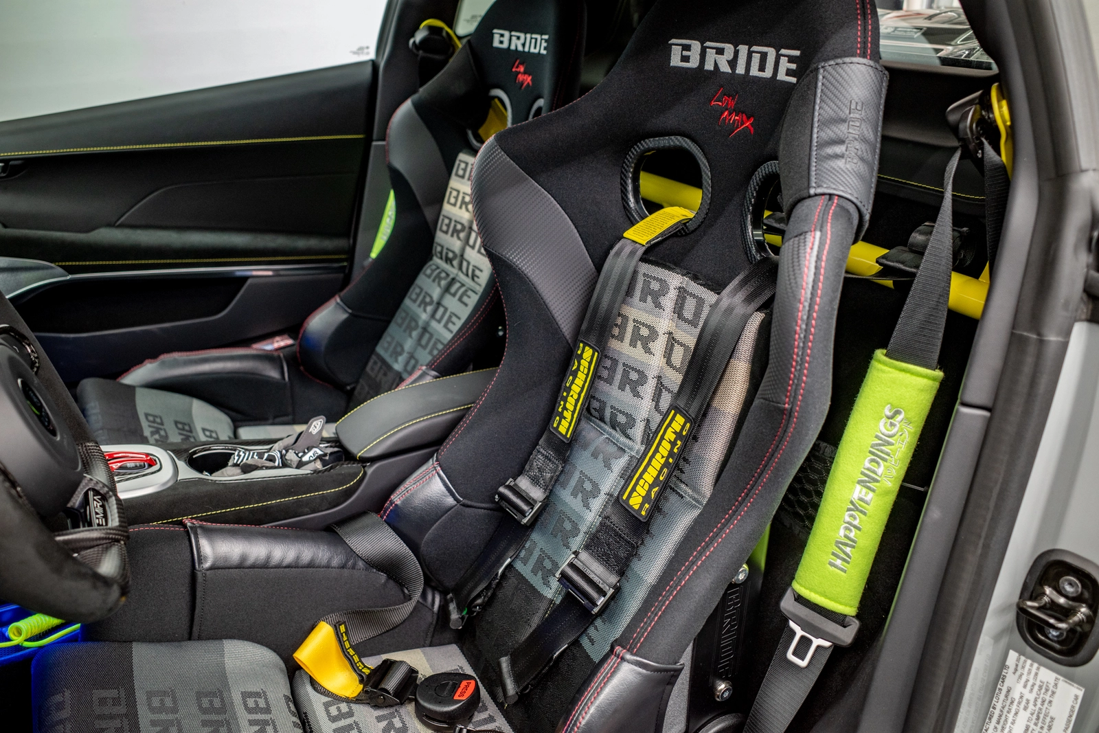

Shop had to install some custom hardware to attach the lap belts to my seat rails but otherwise super simple installation. Retains the normal 3 point easily.
I usually run Willans 6 points but, thought I would be safer this time around and use proper 4 points that are street appropriate (I got 2" all around) - Schroth ASM have the inboard shoulder belt with expandable webbing to simulate a 3 point and allow your body to move and not submarine. Also the yellow patch on the inboard belt states this allows your head and neck to move forward and decelerate properly as opposed to rigid 6 points WITHOUT a Hans.
I'll try the belts out this weekend in the canyons, even with the new seats I am still moving around a little, especially at threshold braking.

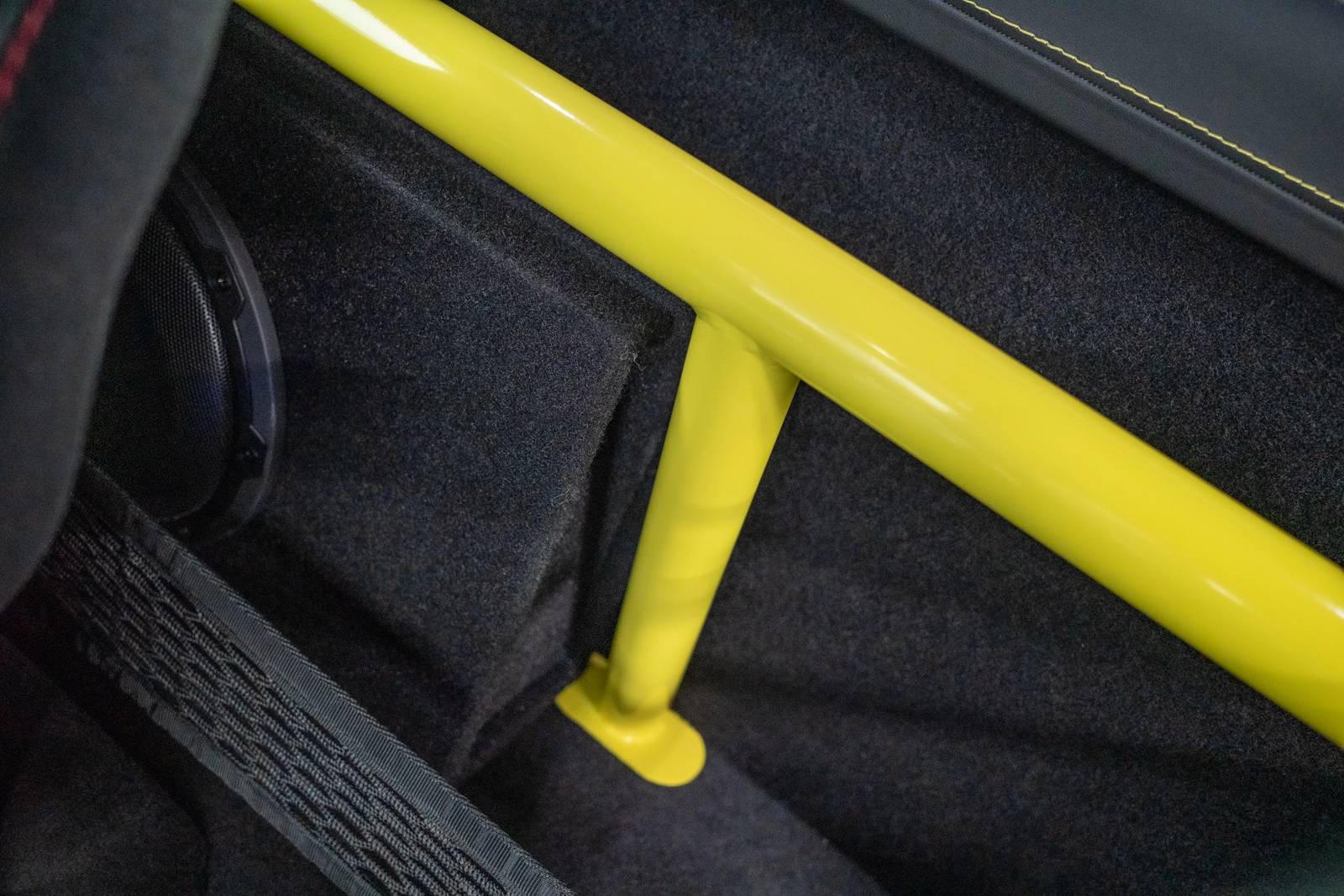

Hard to see in the picture but the bar clears the 8" JL Audio sub enclosure, everything fits nice and tidy.
Bar and belts from GRP and huge thumbs up!
