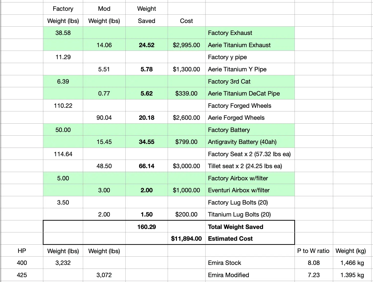

Yes it's definitely possible to get it under 1,400kg, depends on how much you want to spend and what you're willing to do (and live with) to your car.
There's a few of us looking into this. Here's the latest estimate/planning worksheet I have which includes just about everything that's been discussed without gutting the car. This does not include carbon fiber body panels.
The above list also does not include an engine tune of any kind. The power increase (425) is an estimate based on known claims by Aerie and Eventuri for their products. They don't simply add up together though. Aerie is claiming a gain of somewhere around 20 hp (yet to be verified on an Emira with a dyno chart), and Eventuri is known to add a verified 10-15 hp for their installs on other cars. We don't have the final production numbers yet for Eventuri's intake, so I'm guessing low to be conservative. Let's say between the two products, they add 25 hp; that gives you a power to weight ratio of approximately 7.23 which is pretty decent.
All the above values by the way are assuming a V6 FE with manual.
Getting the weight down to 1,300 kg would be very expensive, and unless you're going for a fairly serious track build, not worth it in my opinion. You're looking at a lot of carbon fiber, both body panels and probably brakes. The cost of that would be double to triple the above list, and at that point, you don't really have a comfortable daily drivable car anymore.
Depending on how hardcore you want to go, you can do the above in stages, and evaluate if you want to do more as you go along. This should be a fun car to mod.

If you add the Jubu upgrade after doing everything on that mod list, you're going to have a stunner of a car. Their 440 upgrade assumes the rest of the car is stock. The Jubu upgrade feeding that car with those mods (including the added performance of the intake and exhaust) would probably be somewhere around 475 hp, so 3,072 (modded weight) / 475 = a weight-to-power (WtoP) ratio of 6.47. A 2023 C8 Z51 has a WtoP ratio of 6.91, just to give you an idea, and it's 294 lbs heavier than our theoretical modded Emira.
The nice thing about doing it this way, is you aren't putting any strain on the engine, or adding any heat issues. The increased performance isn't just punching more power through the drivetrain, it's the combination of a moderate increase in power along with adding lightness. At this point, you now have a car that goes and sounds like it looks. I don't know what the Jubu upgrade is going to cost, but added to the above list you're somewhere around $15k I'm guessing? That's not bad at all for the kind of performance you'll be getting as a result. And there's still carbon fiber upgrades possible, so you can still go further in the adding lightness department if you wish. Not bad.
